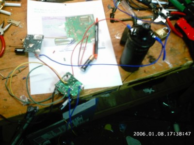

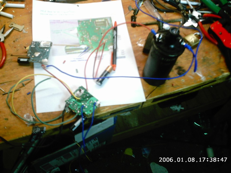

im lost I have all the parts and have made many camera flash igniters but idont get how to wire the ignition points. I know that the reflector wire is the trigger and i dont see how it could work without it

You guys really over complicated this. Soder wires from the points where the flash WAS connected, ignore the third middle wire completely. Putting the battery in the camera greatly simplifies things. Run one wire to a push button switch (doorbell switch works) then to the screws (on mine the screws ARE touching each other, which gets rid of adjusting them), out the other screw and back to the camera. Wire these parts.
1st Wire...Camera-Switch-Screw
2nd Wire...Camera-Other screw.
For multiple capacitors, rip 1 capacitor out and attach it to the other capacitor in series. If you don't know anything about electronics, or arm numbing shocks, don't try this.

Questions about the circuit in the camera
Is it series or parallel?
Is the trigger switch located at the low-voltage or high-voltage end of the coil? In other words, does the trigger interupt current flowing TO the coil from the capacitor, or current flowing FROM the coil to the screws?

This website has a page which takes you step by step on how to dismantle, wire and prepare. It really clears things up
. You should be able to figure out the rest. http://www.i-hacked.com/content/view/181/48/.
