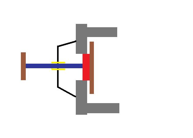

There is one VERY simple way to stop that Latke venting from dangling there.Were the piece of steel is at the back to guide the rod for the sealing face on the venting disc all that would be needed is a simple piece of tubing,be it steel PVC or anything.So the Threaded rod is kept straight by the tube instead of being able to dangle.
Threw together some simple drawings in paint hope you understand them.
- The yellow is the tube,used ot keep the rod straight while you vent etc and to also stop the threaded rod from making that noise.
- sgor.jpg (10.35 KiB) Viewed 4106 times
- The version on your gun now.They were just throw together drawings.
- sgo.jpg (10.07 KiB) Viewed 4106 times
Good idea rna, but I think it would be better if it had another support, like this:
- sgor_869.jpg (11.12 KiB) Viewed 4102 times
Not a bad idea. I guess I better get a welder...
