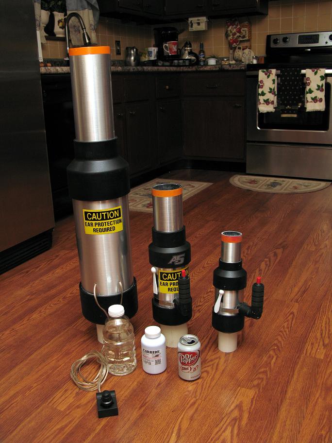

Wait till you see my latest. Im just now finishing up a trilogy of cannons, ill get a picture when i get the last one finished.
Finished, going to give it over night to cure before i give it first test. Im going to start off with 2/3 tsp of carbide and that full jug of water. The little one has a very sharp crack to it, it seems very finiky on the carbide amount. The 4" original thunder mug is the all around best, it will rival an M80 many think this is what it is.
Everyone seems to like the brushed metal finish so i went with that again. I bought a huge roll of it off amazon ive used every bit of the roll on these cannons.
This is going to be a fun 4th, if i survive ill post back :blackeye:
