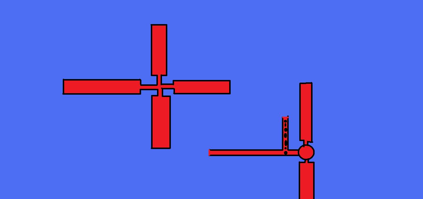

there is one barrel and four chambers
just about the fastest crappyest diagram i have ever made in my entire strange life as a spud gunner dude.

that looks like it would work, but could i suggest that instead of having the chambers like they are there, angle them back so that they take up less space and the energy will be moving in a better direction if they are pointing towards the barrel more
How do you know that the other burst disks wont burst too?
Say you ignite chamber 1, the pressure rises to bursting pressure and it bursts. The pressure diverts to the cross and rises even further while pushing the projectile the first inches, and now there is a pressure differential between the cross and the other chambers. Blam, one of the burst disks go off, and if your lucky this chamber also ignites.
This wont happen if you got very good disks with an accurate burst pressure, very high to the pressure peak, and a big dead volume would also do the trick.
I think that with four pvc 2" ballvalves, it would be more practical, since you can close off a fired chamber again and the chambers are better sealed off from the cross.

i thought of that but a golf ball don't weight to much to build pressure.
and i did not put elbows in the pic because it would have taken a long time to draw.
