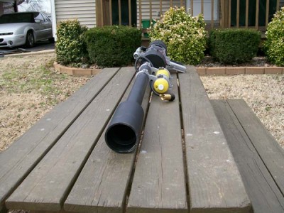

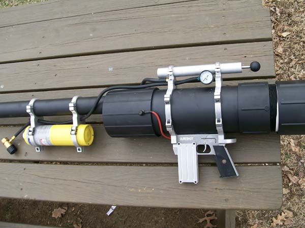

The BL-520 is a combustion potato launcher based around a piece of 5" PVC as the chamber, and a 60" long 2" diameter spud-cutting barrel. There are a number of unique things about this cannon, one being the fact that the barrel comes all of the way through the chamber for breech loading action when you screw off the back of the cannon. The other unique features are the fully custom machined aluminum pistol grip igniter, a plunger action MAPP gas meter/injector, and custom clamps and mounts made to hold it all together. When this was shipped to me, I knew it was going to be a serious cannon, but I really underestimated the size until I received the box.

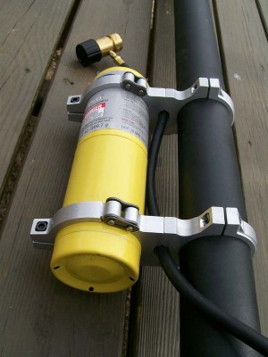

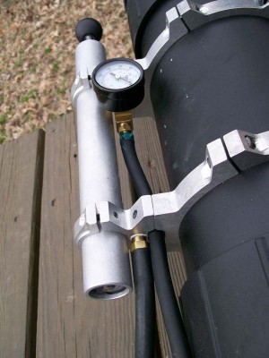

I laid the cannon out on my picnic table to get it hooked up and ready to go. Within 5 minutes, my new neighbors (who I had yet to meet up until today) had spotted this massive launcher sitting in my backyard, so they had to come and ask about it. Turns out he is ex military, so he wanted to stick around to try it out. The meter on this cannon is really neat. When it is pushed in (as it normally would be), a piston inside of the meter cylinder seals up the MAPP gas line from flowing into the cannon. When you pull out on the plunger, you hear the gas rush into the meter cylinder, but it doesn't go into the cannon. When you push it back in, it injects the metered MAPP gas into the combustion chamber, and seals off the MAPP gas line again. It also seals off the chamber, so the combustion does not come back into the meter. There is even a hidden check valve for safety to prevent pressure from the combustion leaving the chamber.

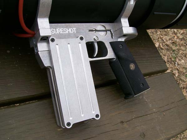

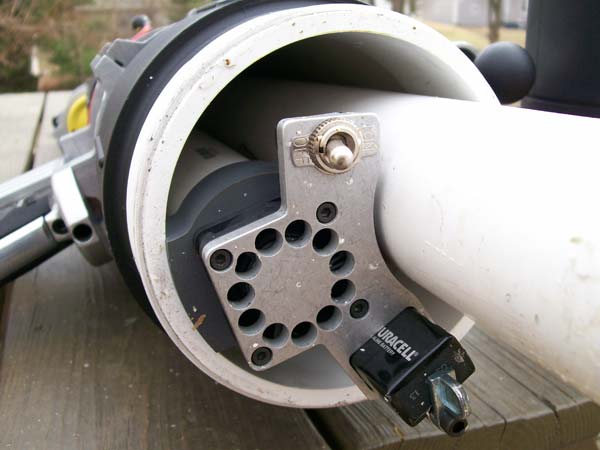

The ignition grip is also really neat on this cannon. Inside the dummy magazine are electronics from a propane powered post pounder that is wired up to ignite the chamber. The cannon comes with a tiny allen wrench that is held to the side of the grip via magnet, so you always have it to take off the side of the magazine to replace the battery when needed. The trigger on the grip works the spark, and there is very little play in the trigger to get it to fire, it is effortless really... no suspense wondering where in the trigger pull it will fire, it fires as soon as you move it. There is a 40mm fan in the rear of the cannon, with a control switch that becomes exposed when you screw the back off. The fan and barrel are mounted via a piece of machined aluminum, and the fan has a piece of pipe attached to the back of it to send the air flow all the way down to the other end of the combustion chamber. During all of my shooting, I just left the fan on and had 0 problems with it. The fan is really required to be running to shoot, since the chamber is so big, the MAPP gas needs assistance to mix with the air that is in the chamber. I once attempted to fire it without the fan running, but the potato didn't even leave the barrel. I was warned that potato may clog up the fan, but the fan blades stayed clear for me.

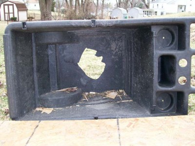

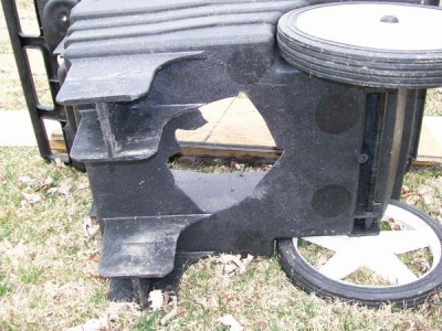

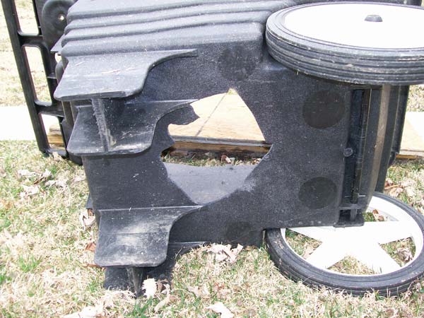

I got some plywood together, a healthy 1" piece provided by my neighbor. I laid a Craftsman yard cart on its side and setup the 1" plywood in front of it. I figured that #1 it would not go through the plywood, and #2 if it did, it would barely get though and it would be mush, so the inside of the cart was perfect for collecting the mush and stopping what may be left of the spud. The yard cart is a lot like a wheel barrel, but instead of being metal it is made out of very thick, rigid plastic. It's designed to haul around rock and dirt and really take a beating. After my very first shot, I came to the conclusion that I am going to need a much more serious backstop for this launcher.
My first shot not only made a clean hole through the 1" plywood, but it also blasted straight through the bottom of this cart and out the back side. I didn't intend on destroying this $60 cart, but with just 1 shot it became useless for hauling. After setting up a stronger backstop, I started to blow consecutive perfect holes through the plywood, so it was no fluke. Since the cart now had a huge hole in it, I decided to destroy it the rest of the way as well. As part of my backstop setup, I had a healthy pressure treated piece of 2x8 lumber. I decided to put it in front and shoot at it, and as you can see from the video with just 1 shot I split the 2x8 in half.

The only improvment i can think of is putting the fan switch on the outside.

Since you have to open the back to load the spud and you'll probably want to run the fan all the time anyway, I don't see having the switch inside a serious issue. The biggest thing would be forgetting to turn it off when you're done.

What's the function of the muzzle attachment?
