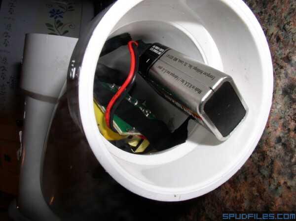

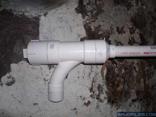

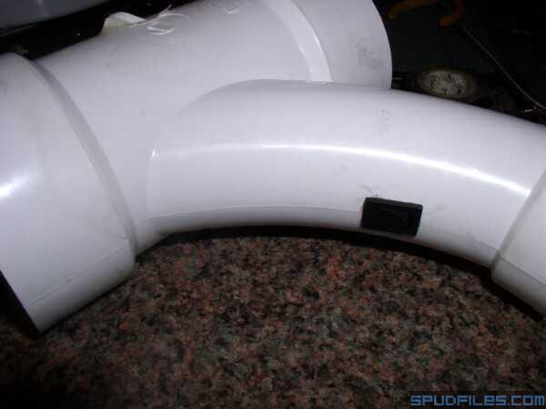

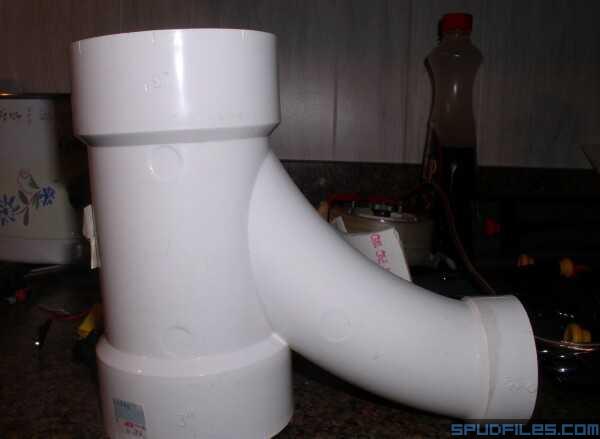

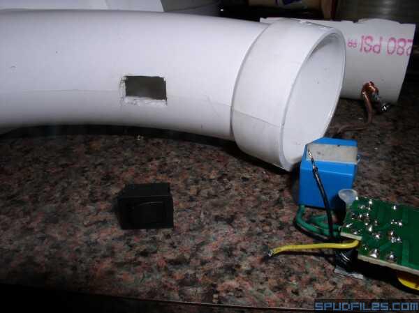

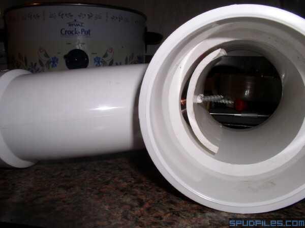

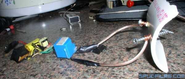

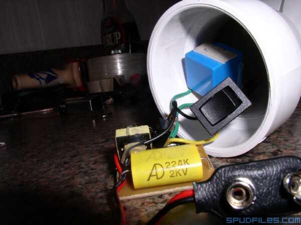

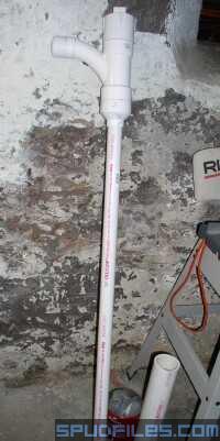

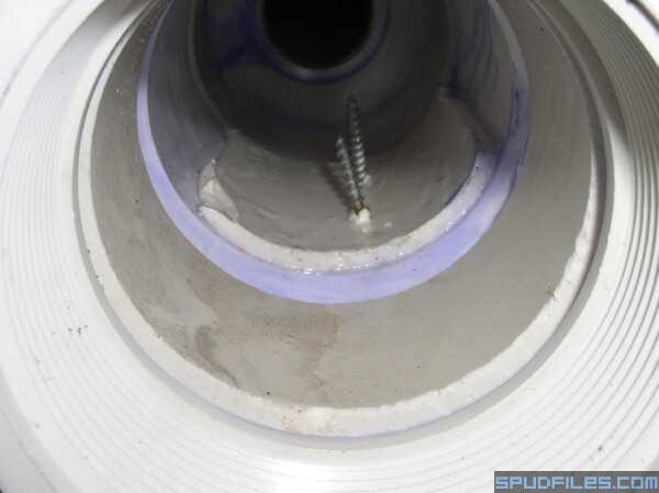

I was tired of the cobbled together look of Stun Gun combustions, too many wires, tape etc... also got tired of getting shocked by exposed wires, screws, etc... I used a wye on this gun, and sealed the stun gun works in the lower wye/grip. Sealed it off with a piece of pvc pipe. Took apart a stun gun and mounted the switch in the grip.
CLEAN INSTALLATION, I haven't seen anything exactly like this, or this clean looking... Pictures tell it all...

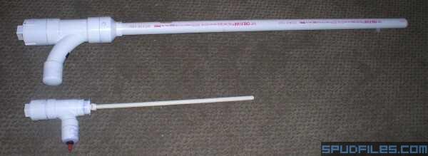

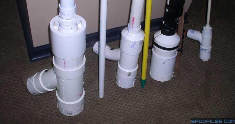

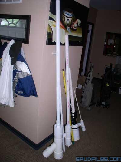

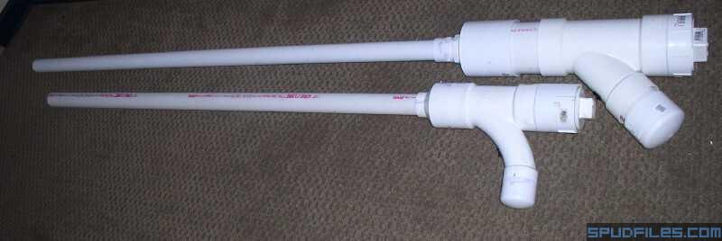

Here are some pictures to go along with the ones I already submitted.. I used the same idea and built a mini, with a BBQ igniter, and a larger scale cannon with a 4'11" Rifled (SpudTech) removable barrel. All three guns have sealed wyes and concealed ignition...
