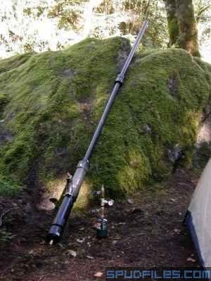

I tested it out this weekend. Barrel is 10' x 2" and it is still only a 1.2:1 C:B ratio. Another 5' extension and I'd get to .8:1. Quietest gun yet, though. And lobbs whole potatoes farther than anything I've built yet. Incorporates several features I've described here in various threads:

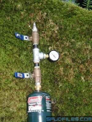

1) Detachable cheap and easy propane meter. Female air fitting mounted in the end cap.

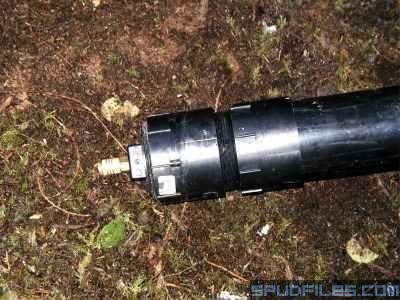

2) Simple removable fan mount, (fan sits in bottom of threads with ground corners so the fan front end fits in but the fan back end won't, so it won't fall in, and is trapped securely when back end assembly is screwed in. Battery is held inside the rear chamber. Fan removes quickly and easily for maintenance)
3) My own trigger handle design...feels comfortable to fire.

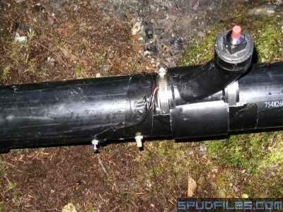

4) Splice fitting in the middle of long chamber (under trigger assy) for extra chamber strength.
5) Back-up flint sparker for those times when the spark fails.

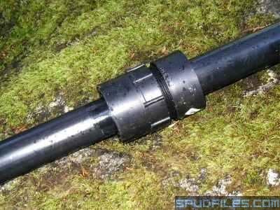

6) Screw-in Barrel with screw-on extension, very similar to a design posted here. Worked great and it all fits nicely in the car.
Provided By - RMS </div>
Provided By - RMS
