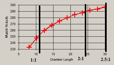

For a given chamber volume, the optimal barrel will be 1.4x bigger than the chamber. Any bigger, and you start to loose performance.
With a constant barrel volume, the results are more complex. This shows that anything above 1.2 hurts performance, but HGDT predicts a steady increase
