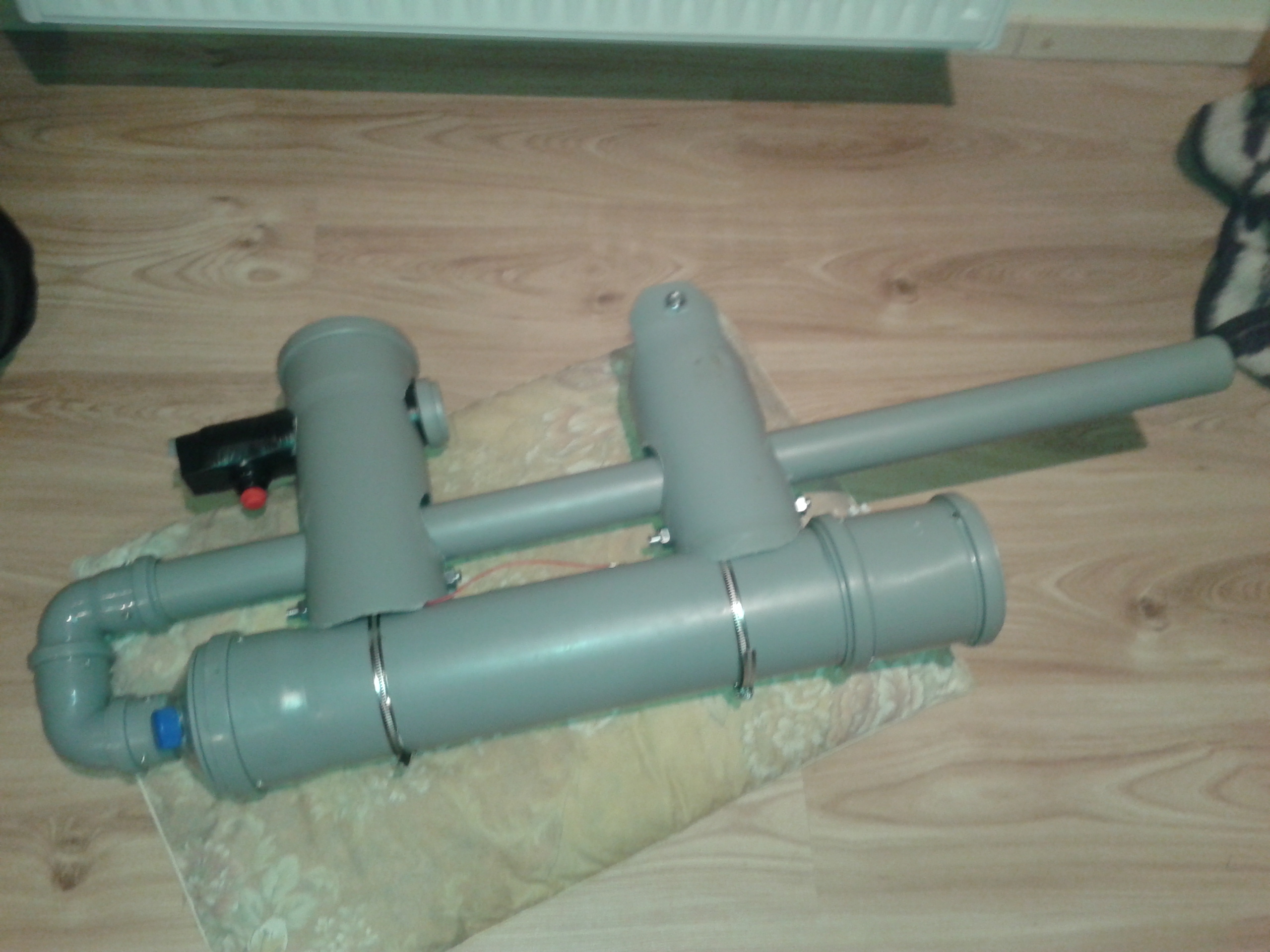

OK guys. Hello. Im pretty new in this forum (but not new to combustion cannons), so I will make my topic as constructive as possible.
This is my 2nd combustion launcher and it is insane (for my live experience). The power coming out is like 5 times bigger than my last one although the volume of combustion chamber in my 1st gun wasnt enormously lager. So I assume that my other improvements were pretty much helpful to increase its power.
Ok I will try to show its parameters:
-100mm diameter and 600mm length for combustion chamber (so volume is like 5.19 liters, if my math is right ah and - spark component volume)
-50mm diameter and 1000mm length for barrel (extendable)
-12 V fan for faster venting
-20 KV and around 2Hz sparker with 2 sparks inside (ordered on ebay as grill igniter) And so I guess that rest of it is obvious.
-Maybe something that is worth attention is my handle where the sparker is attached. It is pretty much 50mm tube mounted through the 100mm one... The way I mounted sparker to this tube will stay a secret (obviously duct tape was used there) because it is a giant mess inside there. -Ah and of course I did use 2 screws to hold spark component in place and also used to carry spark inside combustion chamber (pretty coll huh?
) well you can see that wires inside look pretty messy but it is not at all... just screws attached to wires that are attached to spark gaps that are attached to each other.
So that was my informative part here! Thank you for your attention and im looking forward to see comments from you guys!
And sure I cannot make credit for any of this gun parts. More or less I copied 90% of technology from this Norway sick bastard nolife gunner dude (FYI this was meant to be hilarious not hateful ), whose introduction is unnecessary. I think...
Ok and now we come to part where I have to say I have 3 serious issues:
1) My spark dosent jump over frequently as it should! Every time capacitor is fully charged in sparker, it discharges regardless of fact that it does not have place to jump over and make spark. So many people would say that I have bad isolation and it has short-circuit somewhere, but I say big and fat NO! Originally I wanted to put in 3 sparks, but I bailed that idea because it just didnt jump over enough times to call it a normal spark. So I made it only with 2 sparks. But still... Sometimes even wihtout being inside my gun, it still liked to discharge without spark (ah forgot to mention that it should jump around 2 cm in length, but I have max 0.7cm space between both gaps together) So till now I assumed that all screw resistances are making my max spark gap smaller. Am I right or wrong?

2) End of combustion chamber has been blown out for 2nd time that makes it pretty sensitive spot in my gun and im thinking of better idea for holding it together. So conclusively I have brutally distroyed 2 fans that I was mounting in for too damn long. Previously I used 3 wood screws and chamber didnt handle my guns rapid explosion. Should I use more of them? Because Rest of connections are with same 3 screws and I can't see problem there. Here is pic with cap and how screw holes are ripped apart!
3) And the last one is about back handle movement. In here you can see that after each shot, my guns handle is moving towards because not only combustion chamber is braced to handles but also barrel is braced to handle aswell so it wouldnt move around freely. It wouldnt be such a problem, but fact is that it moves on spark screw and it can harm wiring. I was thinking of putting some kind of pipe between both handles and so it wouldnt move so much!
I am really really looking forward to hearing from you guys! Please comment it. Say what you liked and what you didnt like so much, so I can be more objective for upcoming projects! And any kind of suggestions will be greatly appreciated.
