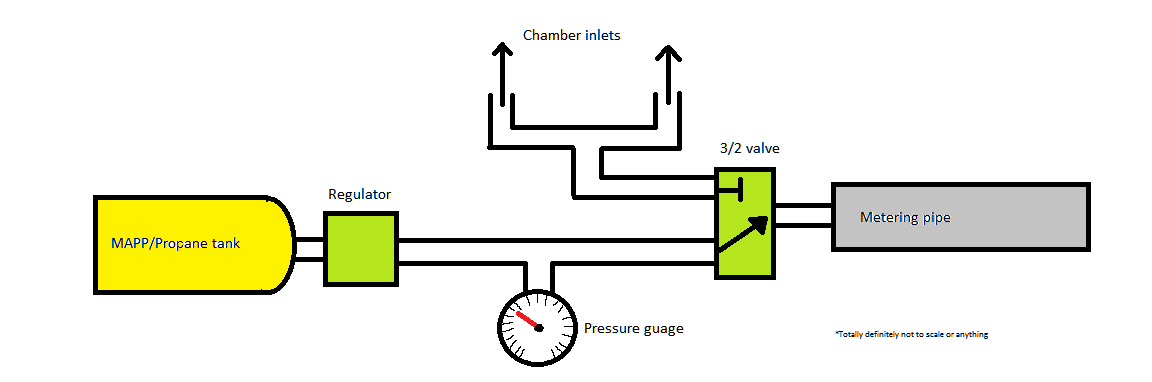

I'm going to be setting up onboard propane or MAPP tank and metering, and this is my first venture into an advanced combustion, so I have a small handful of questions. Below is the metering setup I'm planning:
Propane metering.png (13.87 KiB) Viewed 3660 times
1. I'm planning to run two inlets for the chamber for more reliable gas mixing, as the chamber is fairly long. I'll need to T off the tubes after the metering, but I'm concerned as to how this will affect the amount of gas that enters the chamber. will I need to adjust my metering calculations?
2. The bottle I'm using is this: https://www.bunnings.com.au/tradeflame- ... _p5910238]. It uses a BOM fitting as far as I can tell, how can I adapt this to fit a regulator? Is there such a thing as a BOM to hose barb adaptor? If there is, I can't find one anywhere :(
3. No idea what the outlet pressure on these cylinders is, which makes it difficult to figure out what regulator I need.
4. In general, any other things I have overlooked in the plan?

1.) If you're worried about that small of a volume, simply add it to your chamber volume, although:
  • Using a mixture fan will work much better than simply injecting in two spots, and decrease complexity and dead volume between the meter and the chamber.
2.) I made a page here which describes how I've always done it. You can also buy BOM - > 1/4" NPT adapters at specialist stores.
3.) Outlet pressure depends on temperature, but standard 120PSI max regulators work well enough. Choose a target pressure for your meter well below the tank pressure, to account for low temperatures and the decreased pressure. I usually aim for around 40-50 PSI in my meters.
4.) Not much, I'm sure you'll have fun looking at all of the examples the site has to offer... there's a lot.
