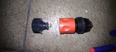

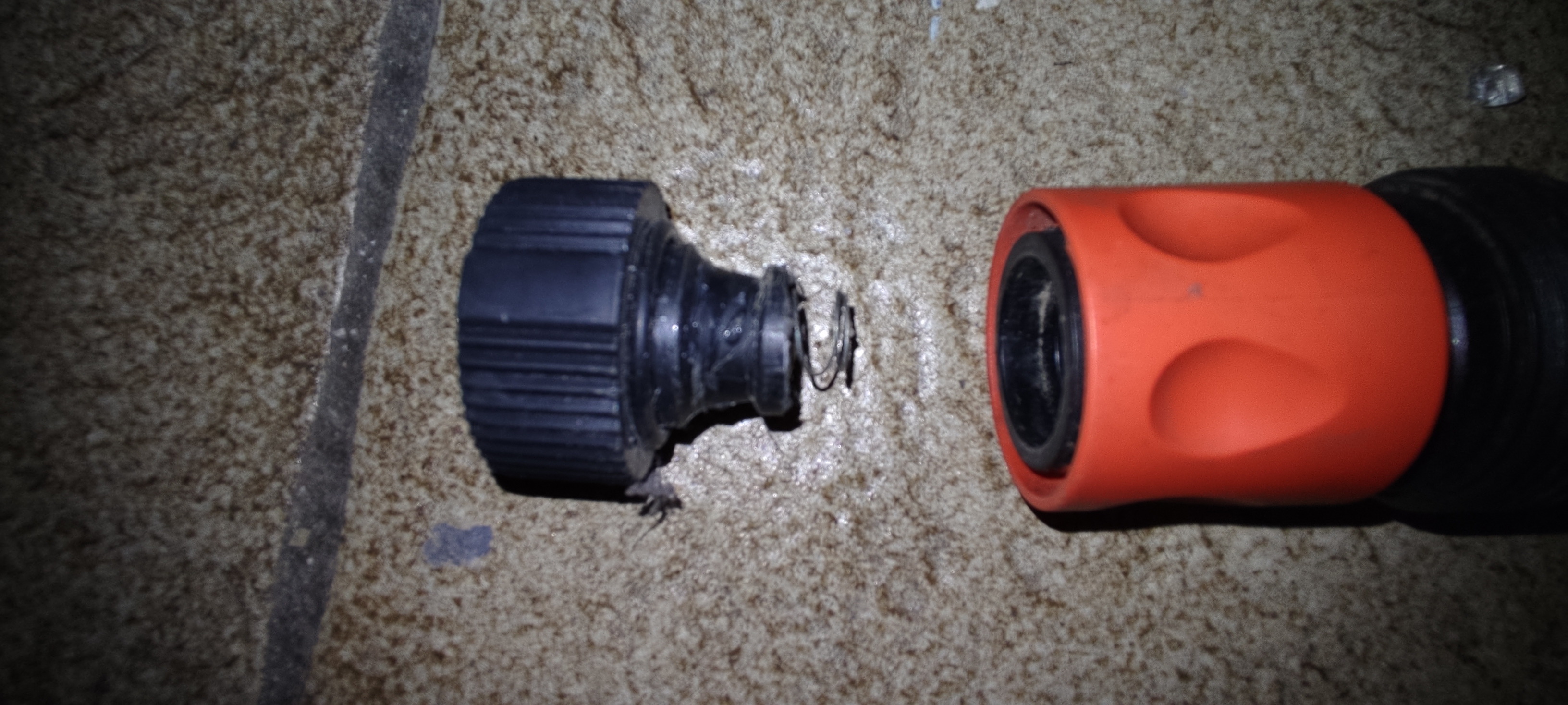

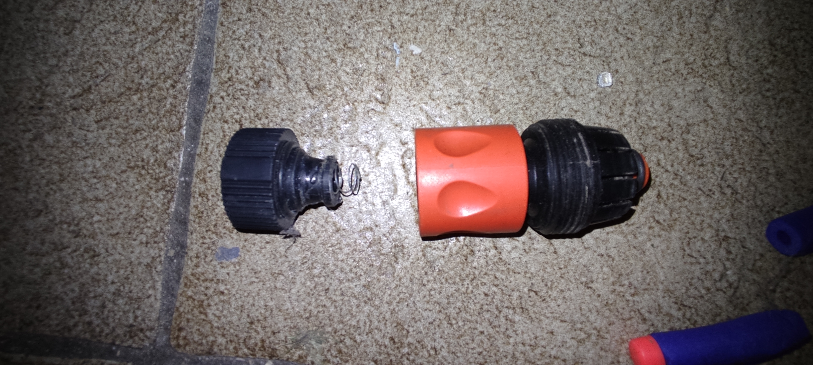

Look for the Gardena Valve in the pictures. It sits on a t-piece and is normally open. In the moment of ignition, it closes with little pressure and leads Al gases to the projectile.
Another valve shuts the chamber from the Lighter (Because the nozzle gets dirty, if it is open).
Try it with some old tubes.

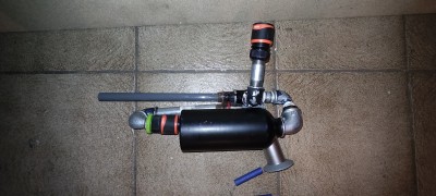

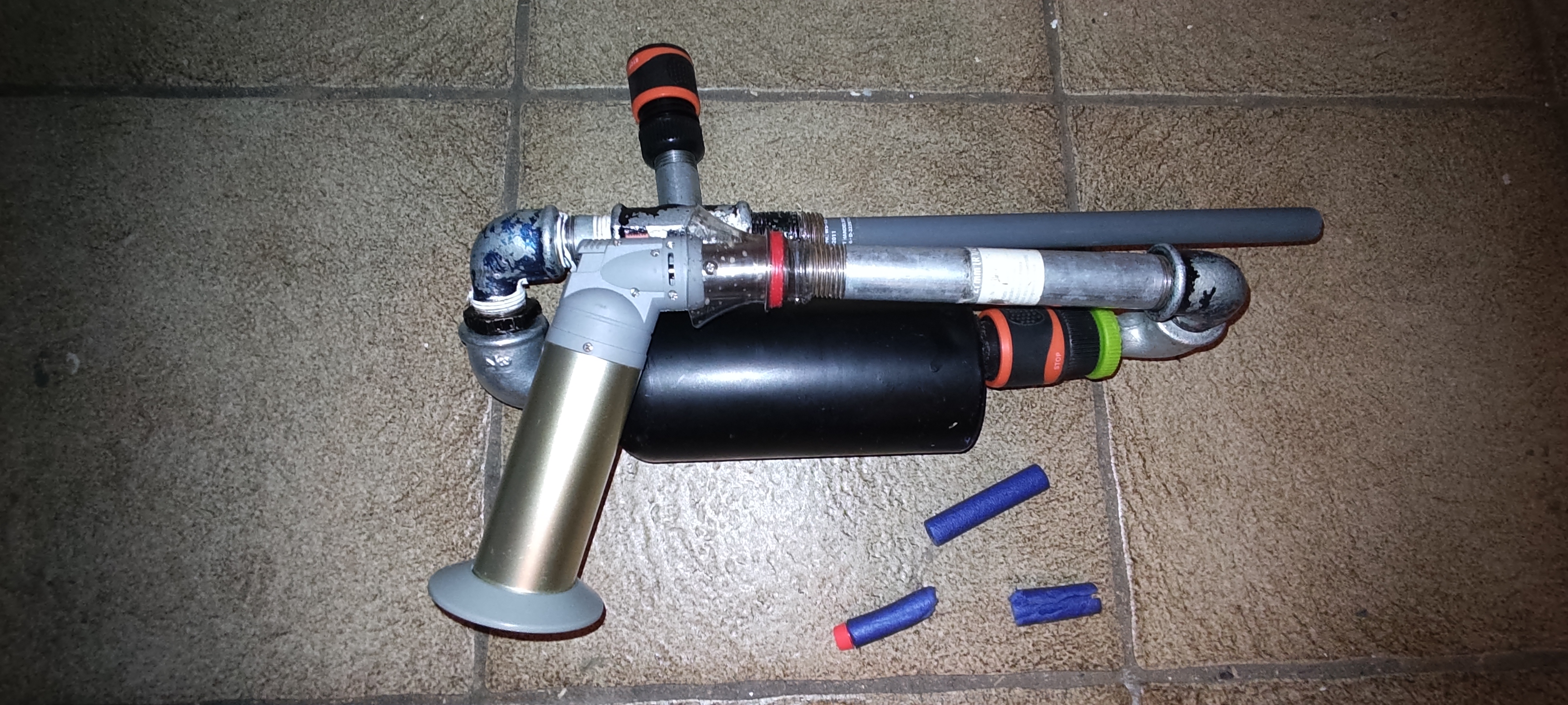

Easyest Nerf Cannon with direct fueling and firing I ever made.
It was a 30min Project. This morning.
The chamber is waaayyy tooo big. So U see what happens with normal Nerf Darts...
But this is only to show the direct fueling by a Torch WITH use of a bigger Lighter or Torch. 4 seconds load and booom.
It consists of Parts laying around. The. Chamber is a aluminium bottle.
For the valve you have to cut the male part and use a very weak spring to hold it normally open and close it when firing. It's a little tricky to find the right distance between fueling without resistance and closing without loosing to much energy. This depends all on this little bastard spring. And I tried a lot !

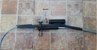

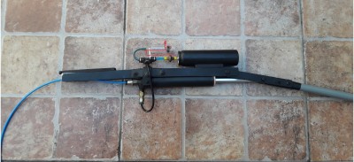

This is the simple system. You only press the valve of the commercial aerosol for one second, which is enough for the butane that enters to sweep all the air and the syringe that fills only with butane, (red line) and then you only use the pump to introduce the mixture into the weapon. The suction of the pump when it draws air introduces the gas inside the pump cylinder and then sends it mixed with the air inside the combustion chamber, it is infallible. The internal volume of the syringe is the dose, in this case 5.5 ml of butane. When the air is sucked in by the piston of the pump, it drags all the butane that was already in the syringe. Very practical. If you use a piece of hose used in pneumatics, for example with an internal diameter of 2.5 mm, you have 21 cm to be a cm3. You can calibrate with much more precision the volume of butane, increasing or decreasing the length, with infinite more precision than with a syringe. For someone to try to measure 0.01 cm3 less with a common syringe, it is impossible! With the hose I describe, you only cut 2.1mm and you're good to go. In addition, the air in the hose is displaced by the butane with much less butane waste, and you eliminate some randomness caused by turbulence in a dispenser with a syringe geometry.
