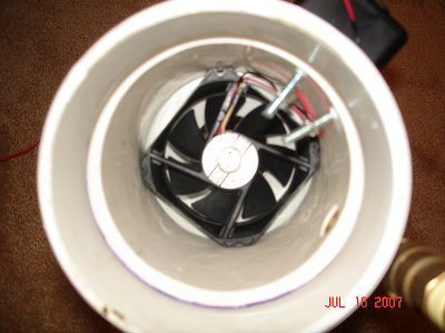

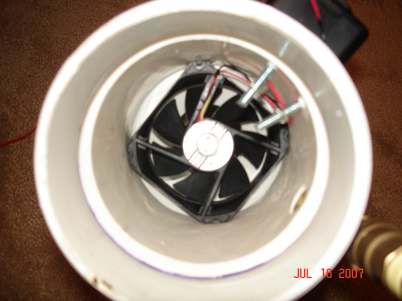

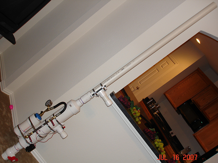

It turned out to be a very difficult yet rewarding experience to say the least. Trying to sift through all the information out there on C:B ratios, propane injection, chamber fans, and ignition sources and attempting to make sense of it all was needless to say a little intimidating, but within a couple of days (using some plans I found somewhere in these vast forums) I was somewhat complete with my new gun. I was however, extremely displeased with its performance. That is, until I installed my fan (which I had been dreading to put it, having never soldered a wire in my life). I'm happy to say it functions quite well; both my friends and I were amazed at how much performance such a small thing could provide.

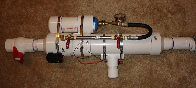

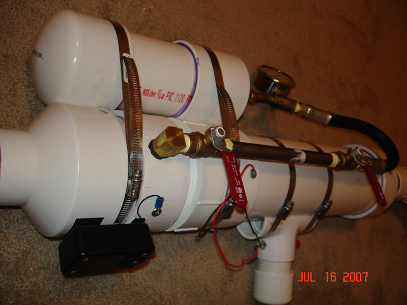

So right now I get a pretty consistent 175 yards or so with an often ear-ringing noise that the neighbors don't much appreciate. I'm still unsure about the amount of propane I'm using (I use two metered shots of about 65psi with an 8" meter pipe and the chamber is a little over 5000mL if I remember correctly). I'm not really sure how much distance I should be expecting with this setup so I dunno whether or not I'm doing something wrong, so if any of you who bothered to read all this have any suggestions as to what I can do to increase performance with this rig I'd greatly appreciate it as I'm still pretty new to the whole spudgun world.

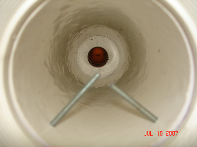

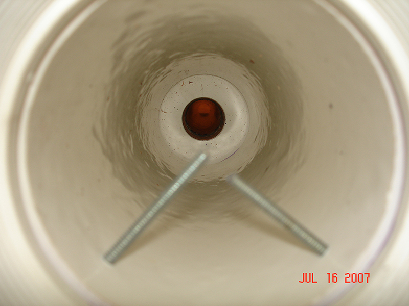

anyhow, here are some specs for the gun:
5000mL Chamber
2"x64" Barrel (a bit longer than the one pictured)
3/8"x8" meter pipe
80mm 12v PC fan (running 9v cuz im a noob at electronics)
BBQ igniter (only one spark gap)
and a very crudely attached green laser sight
