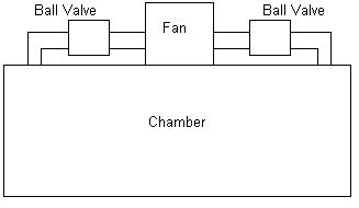

While asking questions about my hybrid, I touched on the topic of a fan. It was immediately noted that a fan would be destroyed in a hybrid. It was also noted that one is not really necessary due to the air injection.
I know a chamber fan drastically increases the performance of a combustion and thought it may do the same with a hybrid, although I'm not sure.
Here is a couple of thoughts of mine to integrate a fan onto a hybrid and keep it from being destroyed through detonation.
Both designs incorporate ball valves to protect the fan from the detonation. Open the valve(s), operate the fan, close the valve(s), fire the launcher.
Thoughts?
In this design, the fan is set up similar to a metering system.  Once the fuel is injected, the ball valves are open and the fan turned on, allowing the fuel to mix.

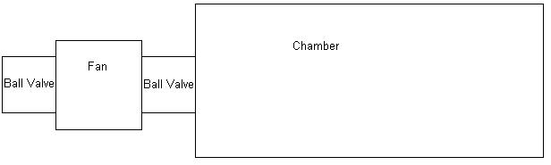

hybrid fan1.jpg (7.03 KiB) Viewed 3656 times
This is a better design, in my opinion, than the first design.  It allows the fan not only to mix fuel, but also allows it to exhaust the fumes.

A hybrid will not necessarily destroy a fan.
I have fired mine at least 20 times and the fan is still fine.
You'll want to mount it parallel to the chamber rather than having it across the middle; I think the pressure differential will end up dislodging/breaking it if you "block" two halves of chamber with one.

The first design looks like what I suggested to D_Hall for his "big-ass" gun. Basically a re-circ loop.
The second... I don't think it is going to mix very well. Probably better than nothing but not nearly as effective as the first design.
Of course, a fan used in this way only gets two of the three beenies of a fan in a combustion chamber, namely, mixing and venting.
Now, how do you get all three beeinies; mixing, venting and turbulance during combustion? Of course, with a burst disk, turbulance during combustion might not be all that important.

_Fnord wrote:A hybrid will not necessarily destroy a fan.
Interesting thought. Does that mean that a fan that is significantly smaller than the chamber would have a better chance of surviving? Say a 1.5"D fan in a 3"D chamber, with the fan shifted off center towards the chamber wall.

Jimmy: In the first design, it is just to mix the air and fuel. The second is a more conventional type, common in a lot of combustion launchers. This one may be used to generate turbulence, but I would think in a hybrid, it would be more prone to causing DDT.
Fnord: I'm not really sure I follow that. The chamber is not going to be blocked off. The first design just allows the fan to be out of reach of the chamber when it is fired to help protect it.
Ask yourself not how to protect the fan from detonation. That is impossible. Instead, only realise the truth: ...every commercially made fitting on the chamber will be blown to sh*t by detonation :D
