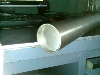

I am using a 50 mm OD stainless steel pipe with a wall thickness of 1 mm.. (ID is 48 ).. How high of a mix can I go with it?

picture will help a lot.

This is the pipe.. with an endcap in it.

Necrosis, you need to research the strenth of the pipe you want to use, specs from the manufacture would be best. Sounds like you should also do some research on the fuel you want to use. Maby you shouldn't even try this because you admittingly don't know what your doing. Don't want to hurt yourself by making advoidable mistakes.

Necrosis wrote:I am using a 50 mm OD stainless steel pipe with a wall thickness of 1 mm.. (ID is 48 ).. How high of a mix can I go with it?
Thanks in advance.
ROUGHLY speaking.....
Figure with stainless you've got a yield stress of 60 ksi (could be more, but since we don't know what you've got that's the number I'm rolling with).
Yield = ID*Pressure / (2*WallThickness)
2 * WallThickness * Yield / ID = Pressure
= 2 * .0787 * 60e3 / 1.890 = 5,000 psi.
But that's FAILURE. That is not what's SAFE to work with.
For safety, divide by 5-10 (depending on how safe you like to be).
So I'd say you're good for 500-1000 psi.
Note: That also assumes we're talking about seamless tubing. If there are welds, I'd split it in half. Call it 250-500 psi.
