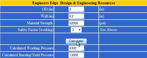

Some information about iron. There is a table lower down which gives tensile strengths.
Why guess when you can know?
http://en.wikipedia.org/wiki/Cast_iron

i can't have done that right..
whooha!
whooha!
2 fittings.jpg (30.12 KiB) Viewed 2871 times

Your wall thickness seems too much. I prefer to use the thinnest section when calculating burst/yield pressures.
Usually the wall thickness at the deepest part of the thread.

but the threads helps also. (i may did it wrong since i usally uses mm)

Sun Jun 22, 2008 12:35 pm
I don't know about the fittings and pipe that you have in Norway, but the stuff I use still leaves more than one thread to atmosphere when tightened.
That makes it the thinnest section, and the thickness to use for calculations.
You are ALWAYS better to err on the safe side.
.2" = 5.08mm
