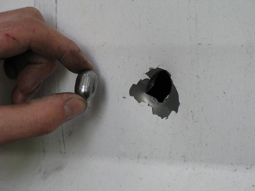

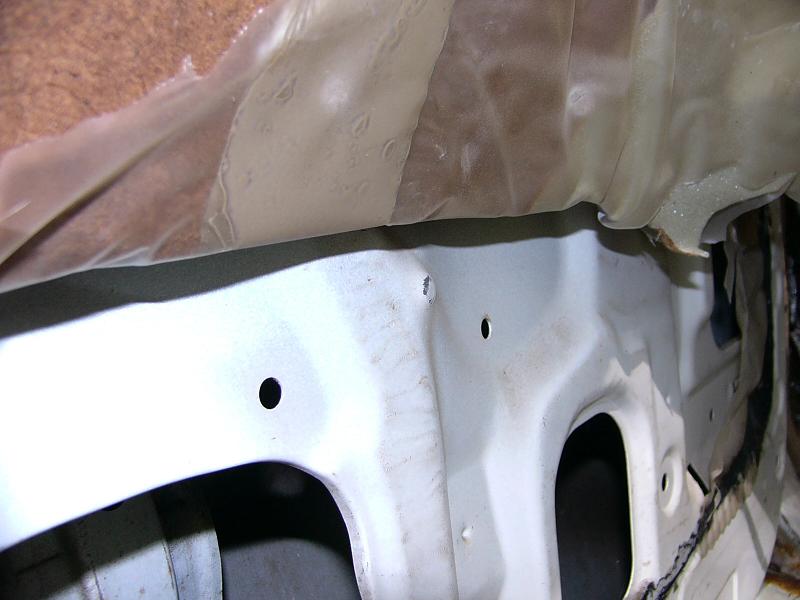

Lesson learned - pressure test before heading out.. or bring tools. The chamber had a leak so I wasn't able to make it over 4x.
On the bright side we found an abandoned truck which was just begging to be used as a target!
At 4x it didn't quite make it all the way through the door, just dented the inside.

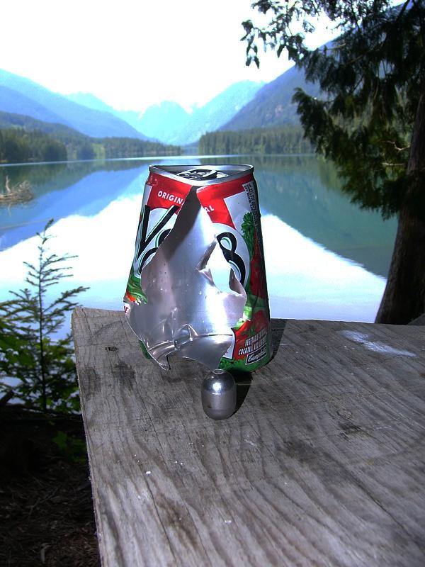

A can of V8 also got sacrificed in the name of science, at 2x.
