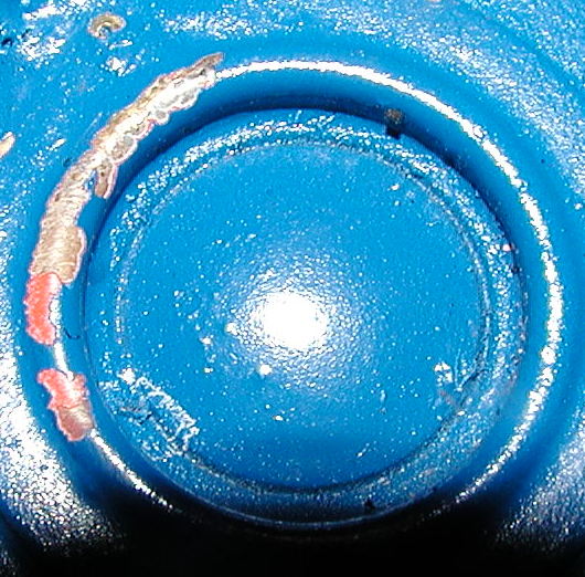

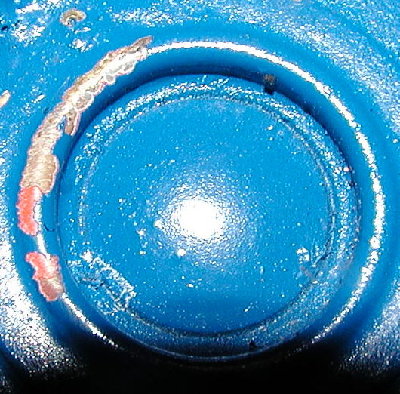

Here is one on one of my cannons.

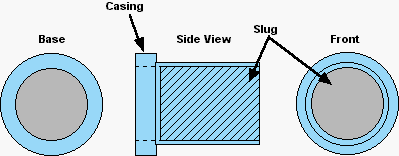

How about the basic shape of a bullet cartridge but with a big hole in base of the casing (where the cap would be). The slug is press fit into the casing. The friction between the casing and the slug is the "burst disk". Once the pressure is high enough the slug exits the casing and proceeds down the barrel against a much lower friction force. The casing would be reuseable just like a rifle casing and the casing rim would be what holds it stationary in the breach.
Thu Jun 11, 2009 12:31 pm
I grabbed a camera to show the stamped metal breakaway thin rim on the QDV Cannon. Sorry I didn't get any inside the tank photos of the orifice.
Disposable Freon tank rupture disk.  On the inside of the tank is a second layer with about a 3/32 inch orifice to limit the burst energy.  This is not designed to eject the disk, but retain it like a pop can pop top.

Tech,
OK, that is interesting. They're just controlling the energy via an oriface. I'd never seen the backside of one of those so I always just figured they designed 'em a bit thicker than that.

As far as I can tell the burst disk is about as thick as the tank with a weakness stamped into the rim much like the pull tab on a pop can so it bursts first. Behind it the orifice is there I presume to keep the tank from becoming a missile when it lets go. It's my best guess. If I ever cut into one of these tanks again, I'll be sure to grab photos.

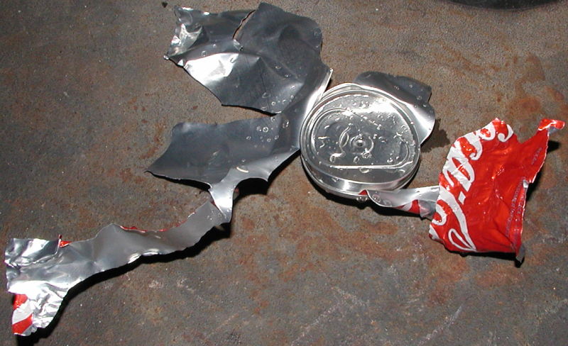

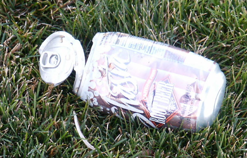

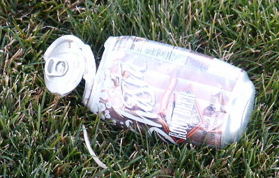

Also was wondering before about the top of 12 oz. soda cans too. Cool
There is a good possibility the entire top of the can may come off. It's just crimped into place. Attached is a photo of a can that hit a tree at high speed. The tab is intact, but the can separated from the top. The other photo is a can that was launched 300 yards onto a football field. It landed sideways and blew off the top. Again the tab is intact.

...There is a good possibility the entire top of the can may come off. It's just crimped into place. Attached is a photo of a can that hit a tree at high speed. ...
Wow, 300 yd.s soda can! Wonder what launcher that was shot from?
Yeah, with the soup/ other can tops, I was thinking of the entire can being part of a cartridge.
But with the soda cans I was thinking for smaller diameter, and cut the tab out with aviation snips, then sandwich it between barrel and chamber is all.
Seems like too much work, but they do appear pretty hefty from the looks of those damage pics! 8)
