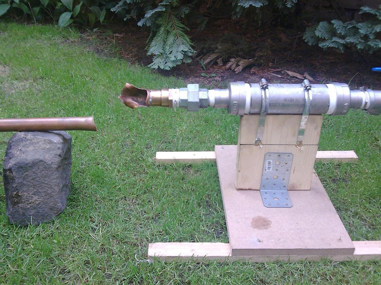

If you plan on continuing to use such a long barrel on such high mixes, maybe a copper barrel would actually be a better option? If copper bursts under detonation, it's more maleable and will probably just blow off, but if steel breaks, there's more schrapnel. Or perhaps surround the copper barrel in steel as a kind of shield?

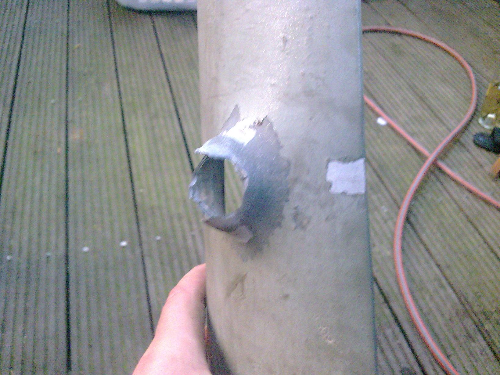

Update:
Shot at a 4mm thick Steel Plate at 20x and it went through without problems.

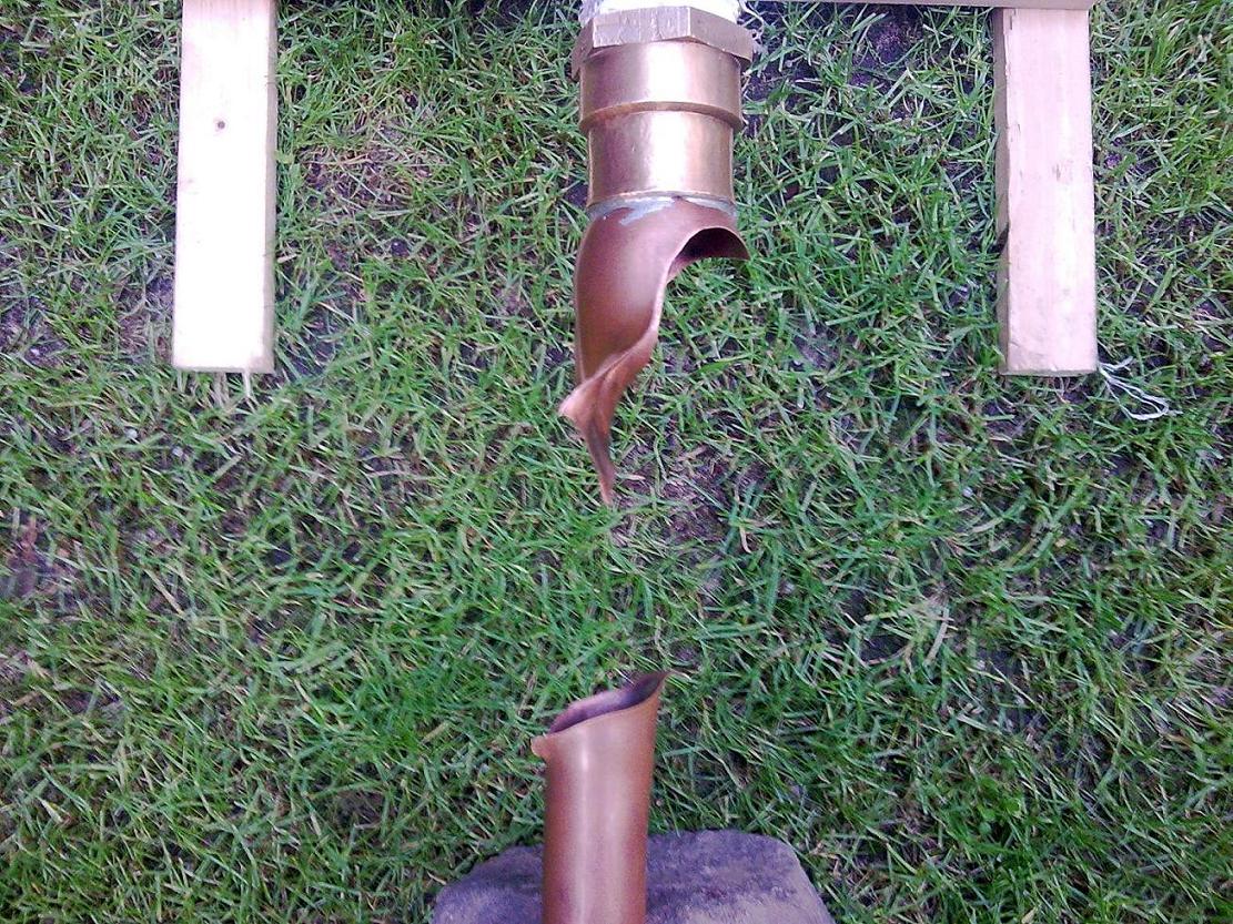

I tried to do it again (at 20x) to see if I can get through 6mm Steel and my barrel exploded :shock:

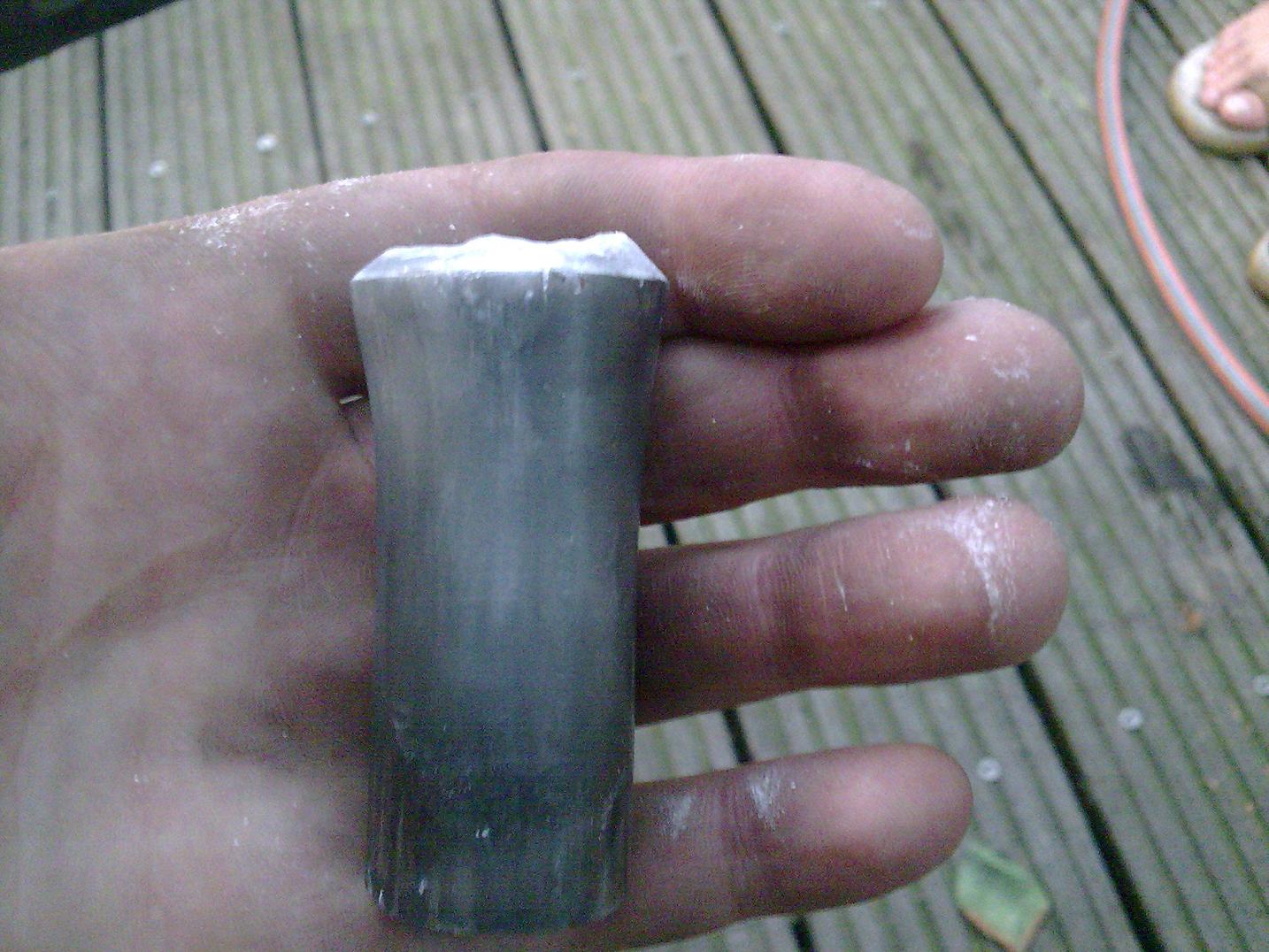

After 20x
After 20x
Before
Before
MRR

WOW :shock:
I guess that was loud. Hope you didn't get hurt.
Did you check the proper fit of the projectile (pushed it trough the barrel) before you fired?
I had my copper/brass gun in my trunk and after that only 1/3 of my ammo (marbles) were able to pass. I had to buy a new barrel because of a tiny dent.

That's some serious penetration there my man... :shock: Looks like the copper failed fairly "safely" if there is such a thing. Obviously, the copper wasn't up to 20x shock and stress requirements.
Any idea what the psi burst point of the disk was?

i can certainly place my money (and more that can't be mentioned (A) ) that you got two DDT's, i don't think just a small portion of the barrel would fail otherwise. atleast it should only make a tear i think.
good work my friend!

and what size is the wall thickness on that copper tube,,in australia we have type a-d ( a )being the thickest wall

The round bulge before the break looks just like your previous experience. That sure is a convinving case for DDT having happened twice to you.

I used a burstdisk made of 0,3mm aluminum sheet. No idea what the burst pressure was.
@MRR
Yes I pushed it through the barrel without any problems. I was standing 3 meters away and behind a brick wall so there was zero chance I would get hurt.

The wall thickness of the copper is 1mm. There is a concrete wall behind the fence so don't worry :wink:

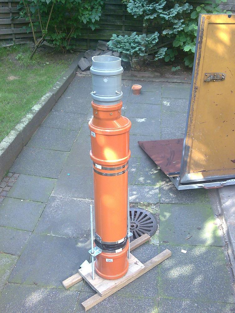

This is my new "Cannon". Its just a huge Combustion Gun without a Barrel.
I use 2-3 sheets of Paper as a burst disk and then about 1 pound of flour on top of that.
In the video it was Spray and Pray but now I got a Propane Meter + Chamber fan.
Will be nice for New Year's Eve :)

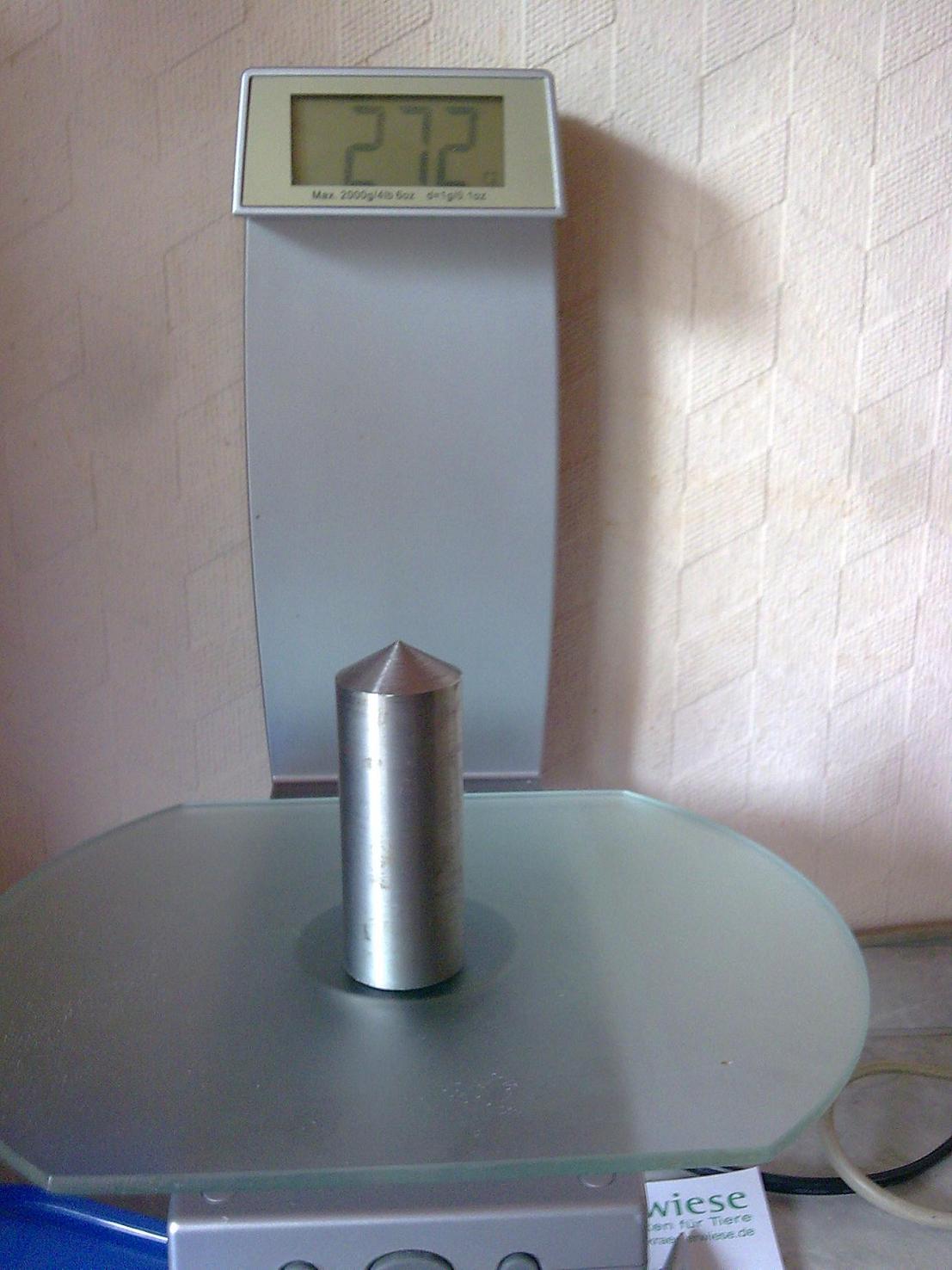

So your going from using your pipe bomb gun outside to inside a small enclosed room for firing....I like it!Any possibility of video?I'd love to see one of these failures on video,if you could induce one again.
Here you go. Sorry it didn't blow up again :P
The Projectile made it through 7,5mm Steel and still had enough Energy to destroy the Stone behind it.
