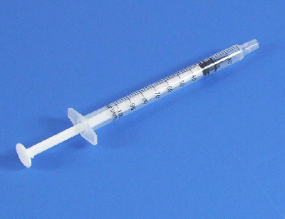

yeah, i was planning to do that but where the hell im going a find a syringe for measuring 0.24ml of fuel for 4x shot
EDIT: im gonna be using butane and the chamber is 2ml

Mon Apr 11, 2011 6:45 am
You could ask a heroin dealer
or a chemist.

get a large syringe, do some math, then fill the syringe with a small amont of gas then fill rest with air, then purge chamber with said mix and if math is right then you will have 0.24ml of gas mixed in with the air in the chamber

Actually, i think im going to be using what i used with my larger hybrid. I loaded 2psi of rpopane in the chamber and then i calculated how much gas i need to ad to get the 4.2% mix. Ill might try that with this one

if it doent, you can get a 1ml syringe
Mon Apr 11, 2011 8:09 am
I would go with a small syringe, you should find 1mL syringes at your local chemist (though they might be the type with integral needle which would need to be cut down).

Sun Apr 17, 2011 1:29 pm
Sry for the delay, but fixing "Tuna" has tooken all my time. I might have tomorrow some time to attach the valve for filling. Second thing is, my local "dealer" has no syringes left
