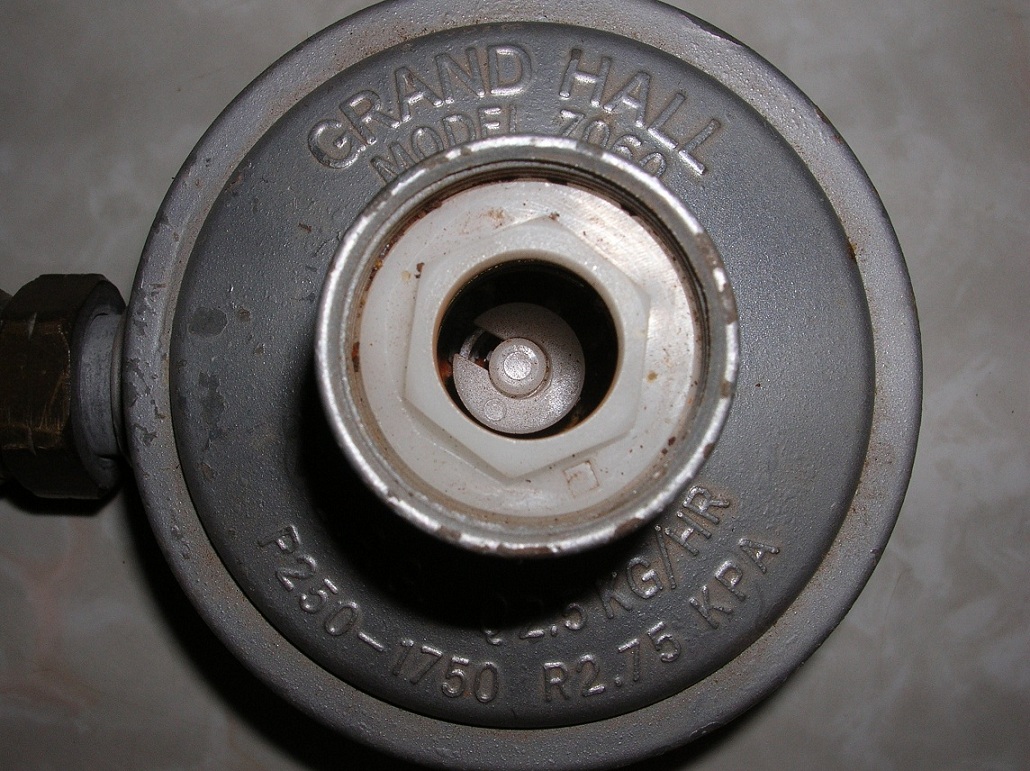

Mon Jun 06, 2011 7:28 pm
Turns out I've got an adjustable reg too, I can remove the plastic adjusting thingy and replace the spring if I need to as well.

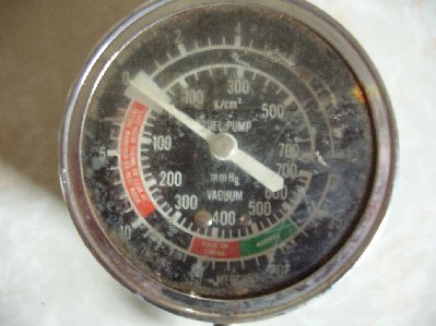

Edit: Here's a gauge too, this is mainly hosting
My reg
My reg
Gauge
Gauge
