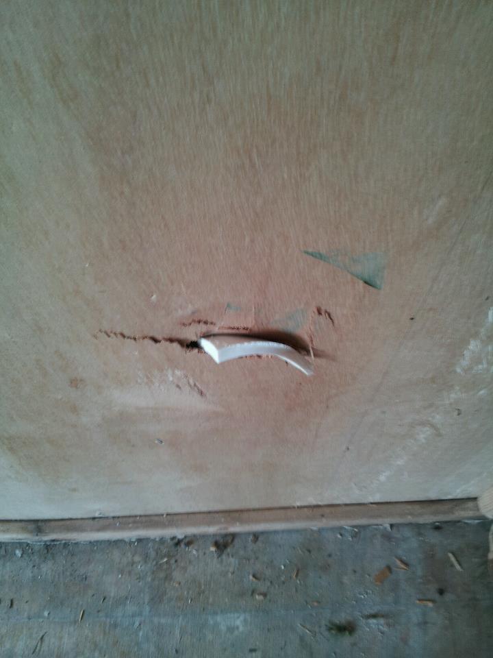

I thought for SURE that a PVC hybrid would be just fine if fired at a mere 2x.....Well I guess PVC is not indended to ever send projectiles to the 800 meter mark... I now call bs on the pvc supersonic hybrid myth.
Anyway I posted earlier I couldnt get it to light... for those who wondered it was the spark gap I narrowed it from 10 mm to 3mm fueled it up with a two X charge set my phone on high definition record... And blew myself up... this was about 15 minutes ago Im hurting really bad and deaf in my right ear.

For real next time Ill ensure I reinforce with duct tape! Hahaha just kidding Next time I will build one out of hudraulic pipe, BUT... not as large diameter either... 4" Diameter is also a bad idea... I want something that could produce equivilient power to this 6,700 liter at 3x could have though...   maybe a smaller 2" chamber at 10 x will equate? I would have to do the math... Is black Iron pipe safe to 10x at 2" diameter?? is a PVC barrel safe?
According to engineering charts 4" pvc has a burst pressure of 1100 psi and max working pressure of 250 so this should "technically" not have happenned.

no a pvc barrel is not safe at 10x the combustion make about 1000PSI of hot gas. What kind of pvc? your death trap up their don't look like pressure rated pvc looks like dwv

I have HGDT It said I would have a peak pressure of 185 psi...
Pipe was schedule 80 (the thick stuff) PVC I don't know what dwv is but this was pressure rated stuff. from some engineering charts I read 4" schedule 80 is good for 1100 psi burst pressure and 200 psi working pressure. I presumed this was safe..
And if you built another one out of new pipe, it most likely would survive, at least for a while. The problem is that even if you use PVC rated to a pressure in excess of your peak firing pressure, there's always a chance of an undetected manufacturing fault in the pipe, or some damage or degradation which has occurred since manufacture. When you're working with material which has a failure pressure on the same order of magnitude as your firing pressure, you're always risking failure.steven_main wrote:I have HGDT It said I would have a peak pressure of 185 psi...
It's not really a problem if you're building something to be remotely fired. If it fails, so what? But if you're gonna be standing near it, go with something far, far stronger than required. Over-engineering can be a good idea when the consequences for failure are so severe.
If you use an appropriate metal pipe, your working and failure pressures will be far beyond your expected firing pressure (provided you're not using ridiculous mixes). That means that if your pipe is damaged/has a fault, it's unlikely that the safe pressure will be reduced enough to come close to the pressure it will experience.

						That looks like SCH40 not SCH80.
SCH 80 is usually a grey color not white.
4 inch SCH80 wall thickness is .357" compared to .251" for SCH40.
Measure the wall thickness on the pieces to verify.
I also see where insufficient cement was used because the primer is exposed.
A metal chamber is always preferred over a PVC chamber especially at larger diameters.

I seem to recall advising against this in your first thread, glad you were unhurt.
PVC high mix hybrids can be safe, as long as it's thick enough - here's one at 6x:
