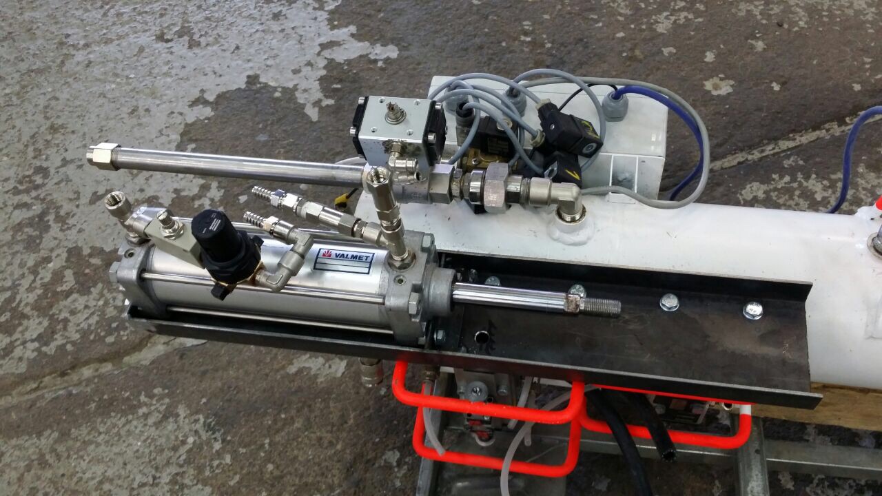

And the real setup.. (sorry for the bad picture)
There you can see the pneumatic cylinder that is used as a propane meter and pump.
