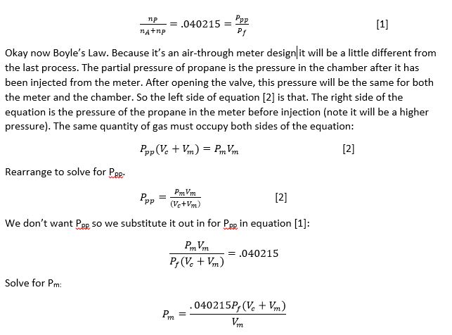

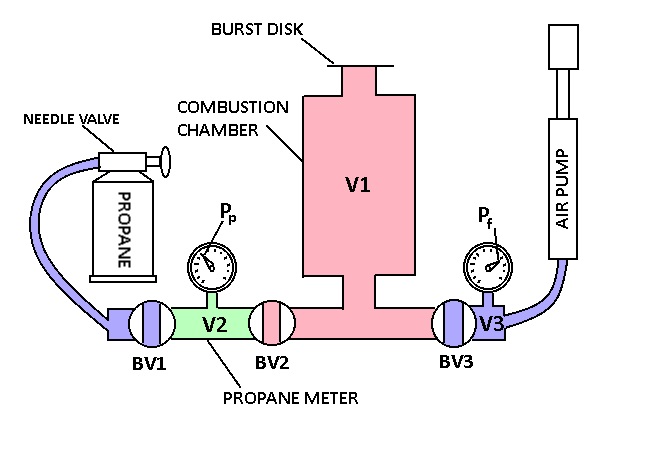

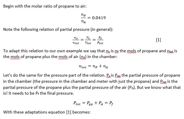

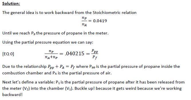

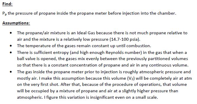

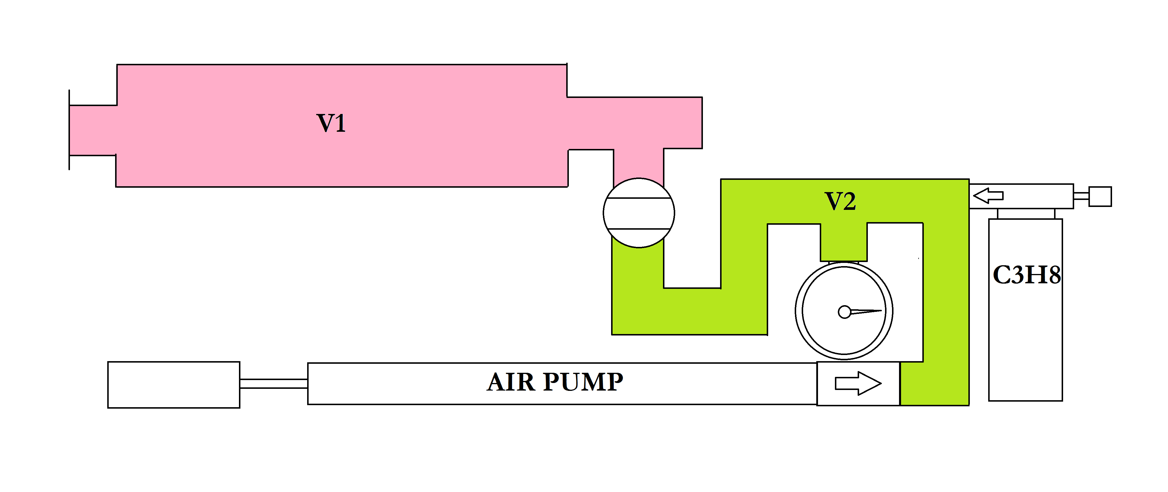

Hi Hybrid Spudders,
I have been dissatisfied with the current approaches to calculating the correct amount of fuel for hybrids using volumetric metering. One, because they don't account for the volume of the meter itself, and two because they don't account for the volume of the dead space between the pump check valve and isolation valve. I worked it out myself and got an equation that is giving me some numbers that make sense.
If you are interested, try playing around with it and if possible, I'd be delighted if you could double check my work for soundness. I typed up the problem in Word and exported it to PDF the snipped it into jpegs so the formatting isn't awful.
Very well presented, better than this hodge podge of ideas.

I think with normal "purging" of your meter and air systems with propane (or air) respectively, and a good design like SB15's "air-through-meter" design solves most of these problems. Dead space in the pump is something to take into account for smaller launchers. Good points, all of them.
						Mark - What you said about "air through meter" designs got me thinking! What I like about that idea is that I need only one ball valve and the procedure of operation would be shorter. One drawback I can think of is that there is more wasted fuel. But after calculating it, it's really not that much. So decided to go with that design!

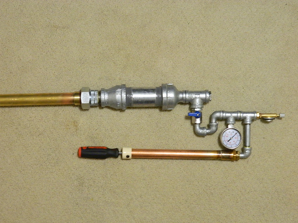

I've started this hybrid project a few weeks or so ago and the parts came in and now I've got something together. I'm waiting on a 14mm spark plug that's coming in the mail that will thread into the adapter on the back of the 1/2 tee. It's got a hand pump I made that goes to 120psi pretty easy. In case you're interested I included the volume diagram and final equation for this air-through meter design which takes into account the volume of the meter.

I'm having a hard time sussing out your derivation for that equation, do you mind posting it? I've put up my math here a long time ago, if you want to check it out, although I don't take into account dead volume of the pump/etc.
						I tried plugging is some test numbers into your Pm equation (the second one down) and I was getting slightly different results. It might be hard to figure out this discrepancy because we took different approaches. I used partial pressures and did not account for atmospheric pressure because it was on both sides of the equation. But I want to look into this further to see if I'm making an incorrect assumption here, because it might be that I suspect. And you're approach uses mix number... Just to be clear n=1 (1x) means a regular old combustion right? For now here are my calcs worked out. I adapted it to use the same variable notation as you I believe.

I think the discrepancies between our numbers boils down to using "mix numbers" in mine, which doesn't scale perfectly with the numbers you would get using a preignition pressure of 10 atmospheres vs. a "10x mix", etc. It might possibly be time to rewrite my page!
						I got a chance to test my numbers and I found out that I was leaving out a Patm in there. I fueled up my hybrid as per the original equation above and no ignition. Then I tried the version that accounts for the additional atmoshpere of air already in the chamber and it worked! I just couldn't wrap my head around this simple addition for some reason (or subraction?
 ) so I just had to test it out. Anyway the equation that worked for me is this:
- Revised Air Through Meter Equation
 - Revised Air Through Meter Equation.JPG (15.75 KiB) Viewed 8166 times
