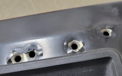

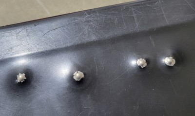

In order to corroborate the chrono results I also fired through a steel security box. In each case the shot cleanly penetrated one side and dented the other, in a very consistent manner.
Entry holes:
Exit holes:
In conclusion, the shape of the transition does not seem to be a significant variable in practice.

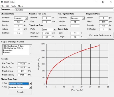

My chamber walls are around .23" thick, so I should be able to run mixes considerably higher than 15 and remain in a safety margin. (Mathwise anyway)

It would indeed make a difference and for example HGDT is supposed to compensate for it, and I can confirm that the chamber and barrel do tend to heat up after firing so there is definitely thermal transfer.
I have not experimented with insulation but I would think that this would not be too significant a difference.

Interesting tests. I always wondered what would be better... Now I know. The small differences in favor of the conical cap are only due to the small increase in volume.
