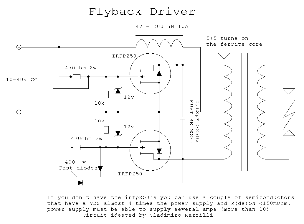

No a bbq ignitor wont work.
Here is a working flybackdriver:
Here is short video of it in action.
Push to test... Release to detonate.

Fri Apr 25, 2008 7:07 pm
so if I take one out of a computer monitor it will have the dirver with it right?
Fnord
Posts: 2239
Location: Pripyat
Fri Apr 25, 2008 7:49 pm
Flybacks are generally a pita if you're new to HV. For your purposes a camera flash/ignition coil setup will work just fine, but you'll want to cut it down to two or three gaps of about 1 mm each.
Larda
Posts: 119
Joined: Wed Jul 18, 2007 7:52 am
Location: Sweden
Fri Apr 25, 2008 8:45 pm
Yes , i would also recommend the camera flash/ignition coil setup over the flyback for you.
Normally you cant use the original driver from the screen and have to build your own.
