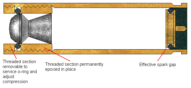

I'm giving this valveless design a go
POLAND_SPUD approves of the design
wouldn't you need a notch on each of teh disks to screw them in ?
though I guess you realize that

The longer one will be permanently epoxied in place, I'll cut... nay, mill a notch in the shorter one to fit a screwdriver ;)

Gun Freak summed it up, the chamber volume in this case is tiny so I'm hoping to go the whole 28x or so available with syinge metering for decent power.

Updated the diagram to reflect actual construction:

I'm not convinced it's going to hold pressure because of the way the o-ring is supported, it might need a more sophisticated mount. We'll see, testing later today.
I'd be more worried about keeping the pellet in place rather than leakage
test this one and if it won't work you might add two mounts - one for o-ring that keeps seals and one for a washer (or some o-ring made of harder material) to keep the pellet from popping

POLAND_SPUD wrote:I'd be more worried about keeping the pellet in place rather than leakage
As mentioned elsewhere, I doubt it will be an issue.

Just as I feared, I was unable to get it to seal. I tried boring it out to 6mm from the original 5.5mm and use it with an airsoft BB but to no avail.
This needs some more thought, and maybe a change of attitude towards design.
