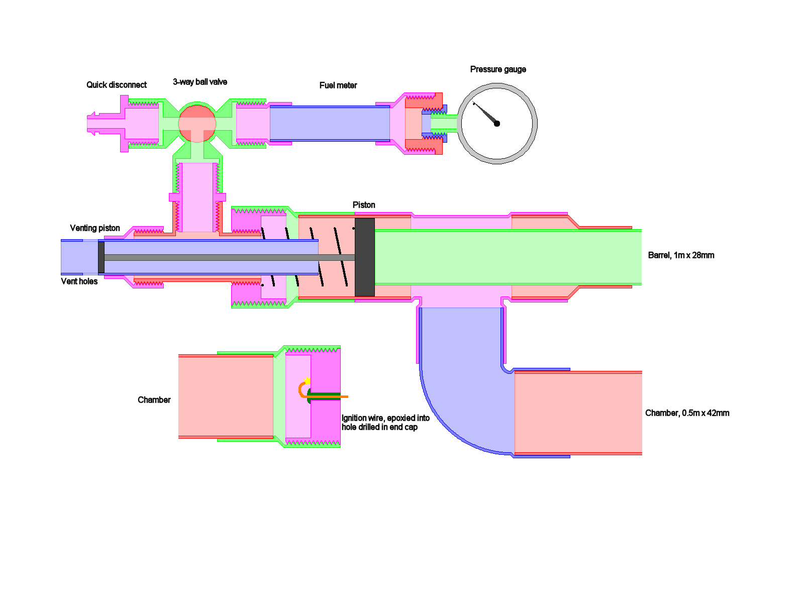

heres what Galfisk said about it:
You can build a variation of the DFTV (http://antennalaunchers.com/dftv19/) that opens when the chamber pressure rises. My copper hybrid uses this, it has been dry-fired successfully a few times but I haven't had time to finish it completely (it can also be used as a pneumatic and there the valve performs flawlessly as well).
This is the first concept drawing, the design has changed a good bit but the valve is essentially the same: diagram
dont complain my crappy english!!
this is a diagram of galfisk`s hybrid valve!

As far as I understand, there are two ways to build a piston hybrid. In one the piston is actuated at the same moment of ignition by a solonoid. In the second the piston is actuated by the higher force of pressurised combustion in the chamber.
