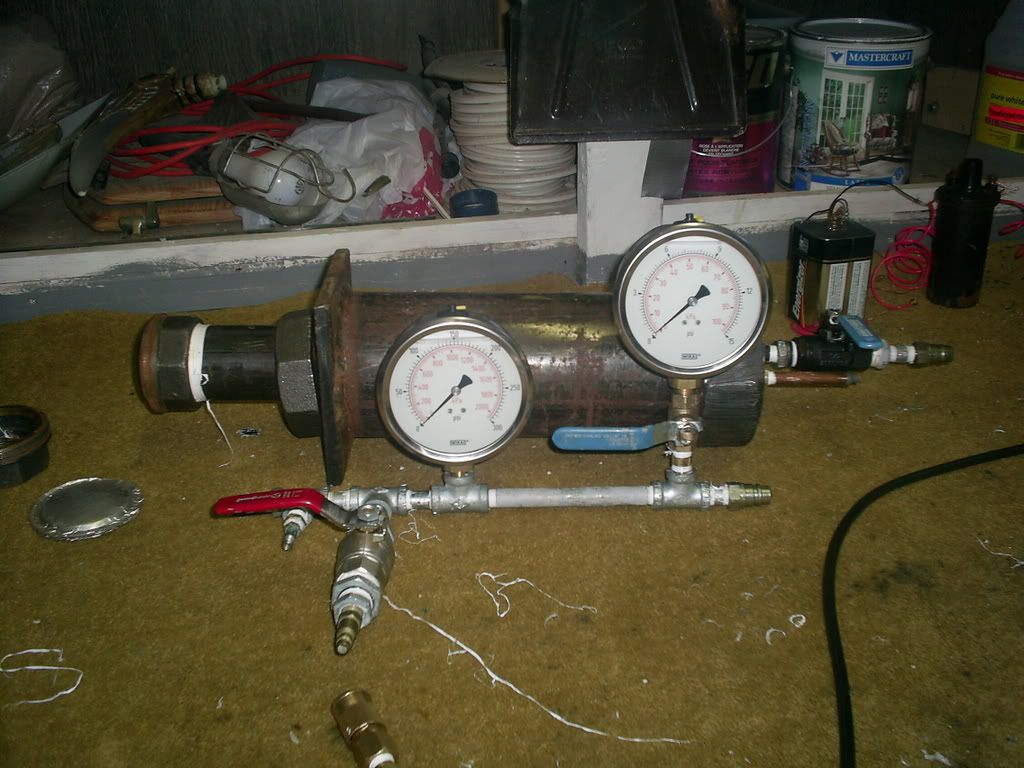

My metering system uses gauges to measure chamber pressure, one for propane, which is then closed off before the air is added. With accurate enough gauges, it would be far cheaper than the monstrous meter pipes that would be required for the Pipe Dream.
Considering the budget of this project, I don't imagine that precision gauges would be that bad. If it is only going to be used at a maximum of 3x or so, you could just use a grade 1A or better 0-3 psig gauge for the propane, and a similarly accurate 0-45 psig gauge for the air. If you could afford even higher accuracy gauges, it could be more accurate than a regular meter, and either way involves far less hassle.
Here's a picture of my metering setup:
The ports, from left to right are: chamber connection, air input, fuel input, air pressure gauge (0-300psig, grade 1A), propane pressure gauge (0-15psig, grade 1A).
