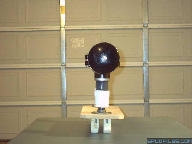

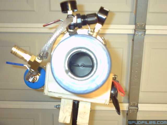

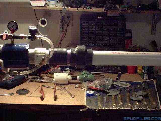

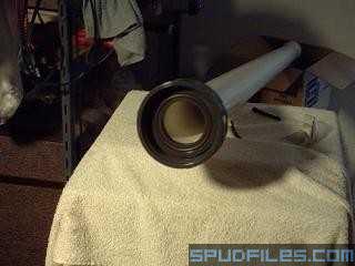

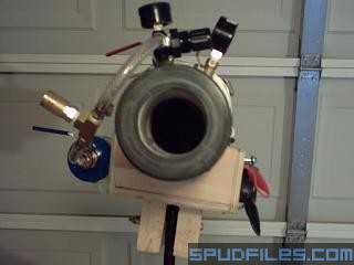

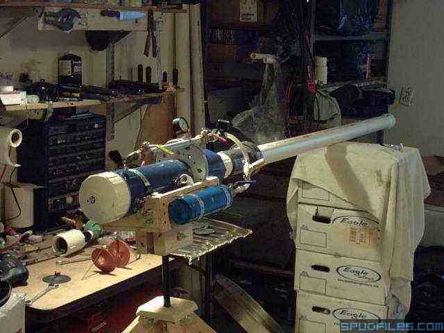

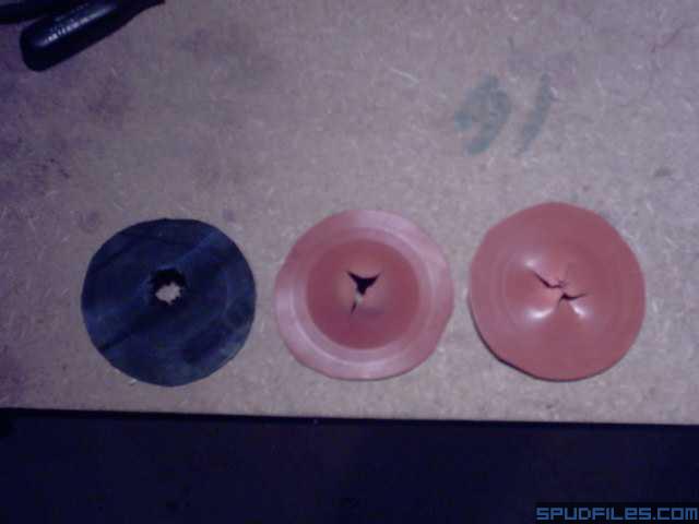

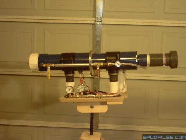

I do not have accurate pressure reading information as of yet, as it has been too cold to safely re-fire. I am sure that a burst-disc made out of a piece of a 2-Liter PEPSI bottle hed back pressures in excess of 100 psi. The gauge installed in my chamber pegged hard past 100 psi (it's max) and from five feet away blew a hole in the drywall with just the air (no projectile). It takes only 76.8psi coming out of a 2.5" opening to equal 120 psi coming out of a 2" hole. This thing has awesome power. I cannot wait to launch a weighted tennis-ball. My goal has always been to launch a weighted (water-injected) tennis-ball 1/4mile. (unmodified Chamber venting through 2.5" diameter pipe with a "normal" mix would reach 300-320 yds. This was when the Chamber was merely "verping" (vomit-burping) 15 psi. I'll bet I could shoot a weighted tennis-ball 1/4 mile with the barrel straight forward now!- No more pathetic lobbing. This design is, in my opinion, extremely dangerous. DO NOT attempt to fire more than a "recommended" 2x/2atm mix. This design, when fired, is extremely loud. I have not remote-fired this, as I trusted it would not produce pressure past 130 psi. I have however, pressurized "PEPSI bottles" to 130 psi, and have had them hold at that pressure. 130+ psi venting out of a 2.5" hole will kick like a ****ing mule! - Launcher must be properly mounted to a board,cradle,...some kind of housing to prevent user from hurting themself.-- Recommend to remote-fire only!!! -I have NEVER remote fired this because I am an idiot!--- Anyway, if someone is too build this, it is very dangerous; the pressure generated, the recoil (it actually only moved my stand a fraction of an inch, but my stand has a4'x4' square BASE.
<img src="http://www.spudfiles.com/official_pics/BDS%20003.jpg">
Gun with union/barrel detached
<img src="http://www.spudfiles.com/official_pics/BDS%20005.jpg">
Front View inside Chamber showing "electrodes' ans schrader valve in threaded end-cap.
<img src="http://www.spudfiles.com/official_pics/ ... oflash.jpg" width="320" height="240">
Front View (no camera flash)
<img src="http://www.spudfiles.com/official_pics/ ... dunion.jpg" width="320" height="240">
Behind Barrel

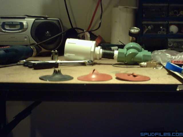

<img src="http://www.spudfiles.com/official_pics/BDS%20013.jpg">
Burst-discs left to right: auotomotive tire tube, 1/16" thick rubber, 1/8" thick rubber.-- Failed @ 25-28 psi
<img src="http://www.spudfiles.com/official_pics/BDS%20017.jpg">
Side View of Burst-discs. (Noooo...REALLY?)

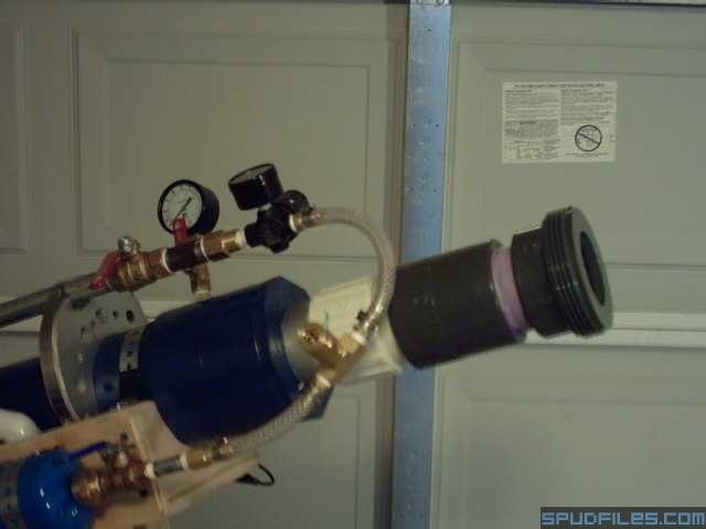

<img src="http://www.spudfiles.com/official_pics/BDS%20025.jpg">
Barrel/Union Assy. attached-- end of combustion gun has a 2.5" male threaded apapter, originally intalled to detach barrel.

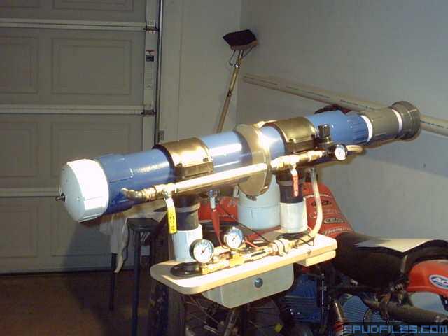

<img src="http://www.spudfiles.com/official_pics/BDS%20027.jpg">
Rear Side-View of assembled gun.

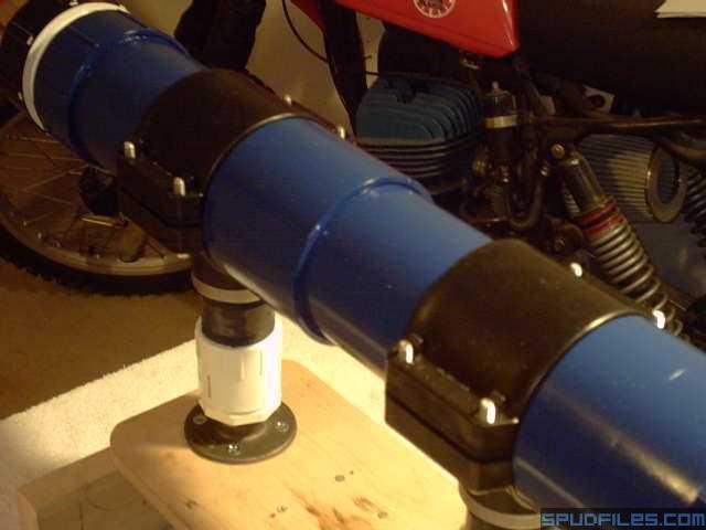

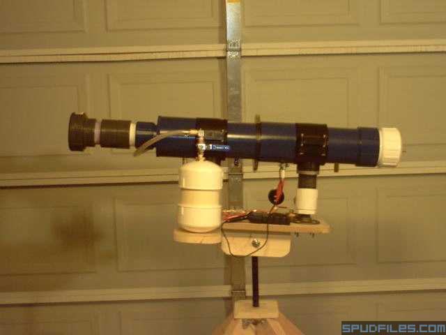

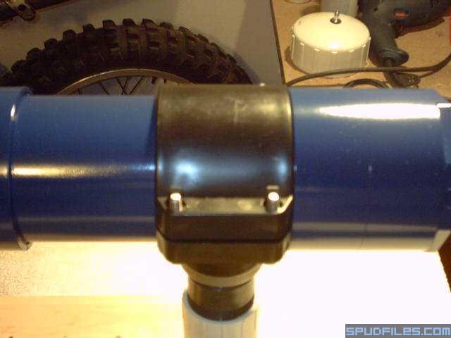

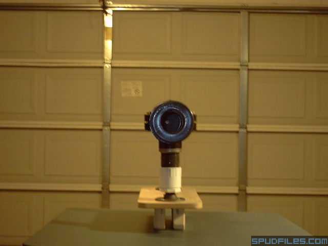

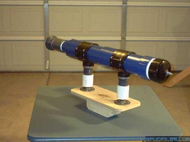

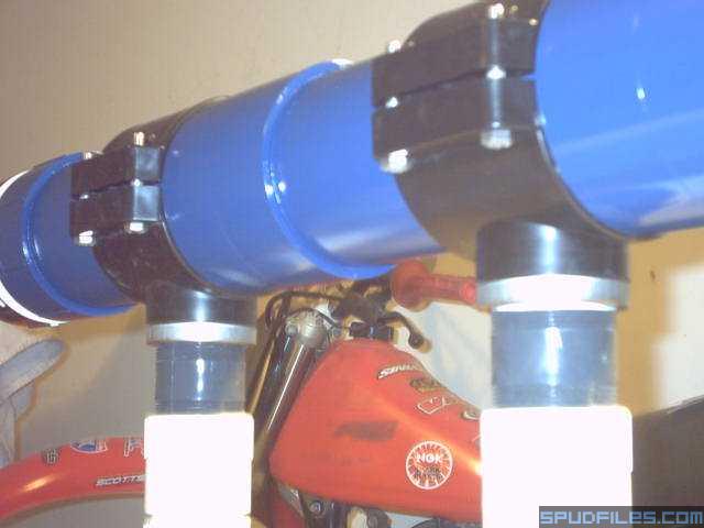

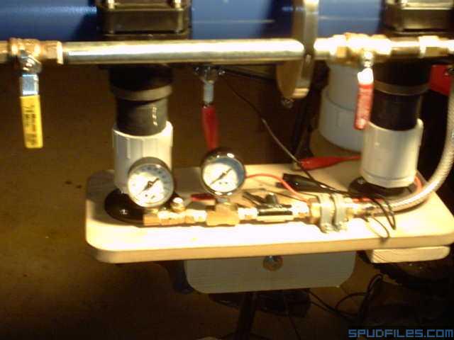

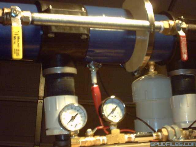

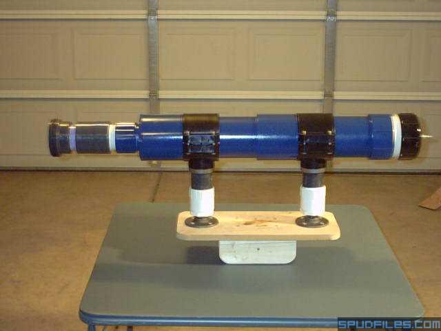

I have recently completed a NEW chamber. It consists of two pieces of 4' diameter x 12" long SCH40 PVC, joined together in the middle by a 4" SCH40 Coupling. The end of the chamber consists of a 4" Male-Threaded x 4" Female-Slip Adapter, and a 4" Female-Threaded End-Cap. The End-Cap has a Schrader Valve in it to pressurize the chamber for a 2x/2atm mix. The Coupling in the middle of the chamber was drilled and tapped to accept an NGKBPR6ES Spark Plug. The tap is a 14mm x 1.25, which requires using a 33/64" drill bit. I used a 1/2" drill bit (which is only 1/64" smaller than required) only because I knew that PVC would be more forgiving than metal to tap. It feeds the pressure generated igniting a 2x/2atm mix into a 400psi-rated one-way check valve. (The check valve's functions is not to let the pressure back out through the Chamber)-- From the check valve it goes through a mini-blowgun. (To vent the pressure that came through the one-way valve after reading the gauges...) From the min-blowgun it goes into a 1/4" tee fitting, on the top of which is a 0-300psi gauge. (The 0-300psi gauge reads the pressure generated inside of the chamber upon igniting the 2x/2atm mix) On the other side of the 1/4" Tee fitting is a 1/4" ball-valve, attached to a 1/4" elbow, and finally a 0-60psi gauge. The 0-60psi gauge reads in one-pound increments to allow for much more accurate chamber pressurization of the 15psi needed for a "2x" mix. --- the ball valve is shut off just prior to firing so tha the excessive pressure generated does not blow this valve. I fired a 2x/2atm mix, and a 3x/3atm mix today. Both mixes blew a burst-disc made from a 2-Liter PEPSI bottle at 80psi. - I will order (on Monday) High Density Polyetylene Film (30 mil thick) and retest a 2x/2atm mix. The "Film" is burst-rated at 172psi! - more later, - Thanks for your time.
