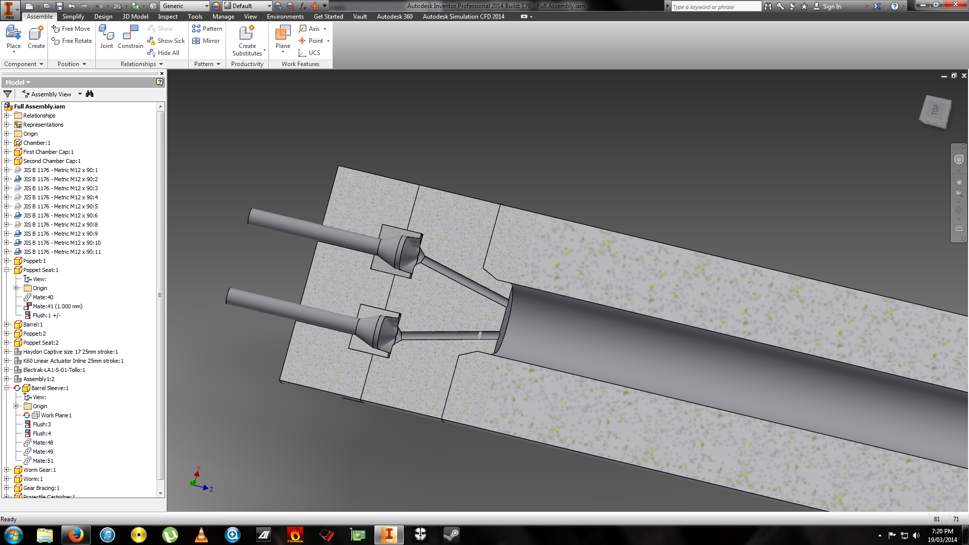

No doubt some of you on here know of Utron's Combustion Light Gas Gun project.
The 16/45 and their pinnacle, the 155mm combustion light gas gun, Capable of propelling 18.5kg projectiles, 4.2 kilometers per second.
My inspiration came (Like Mobile Chernobly, presumptively) from Utron's experimental cannons.

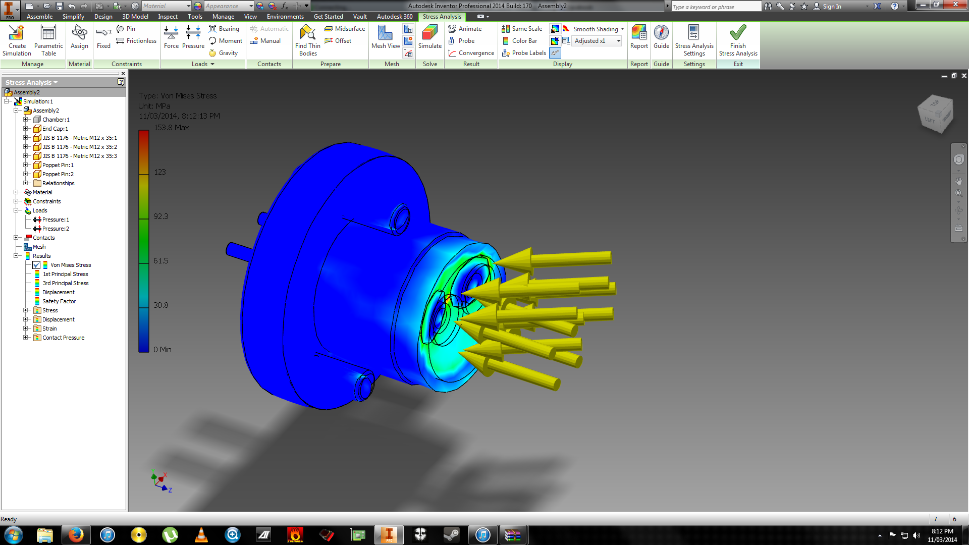

This is my first Design. I have another, stronger, bigger and more complicated design, however it inst completed yet. Figuring out an auto loading mechanism that can mate the barrel and chamber back to resist up to 90,000 PSI is......interesting.
This one is designed to reach mach 4.
In short, I want to (attempt to) break Larda's record :)
I can't say when this will be completed, or if i really have bitten off more than I can chew this time.
But I'll update this as it goes :)
