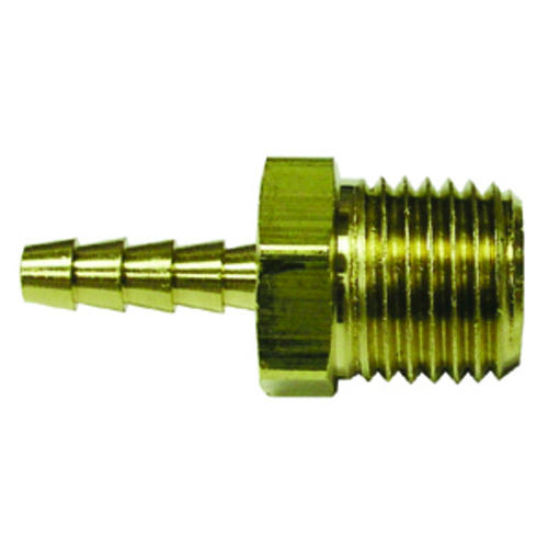

Alright, instead of a Schrader valve (can't find one) what about using a brass fitting like this
1/8'' barb by 1/4'' MPT
I thought about using it in place of the Schrader valve, would this work? I also thought about using a spark plug but I heard a lot about them acting up so I wasn't sure

by noname
It should work, although make sure the barb itself is wide enough to fit the wire though with room for some epoxy as well. If the wire isn't well insulated well, the spark won't jump where you want it to.

by D_Hall
Rather than a hose barb, I recommend moving to 1/4" air fittings for air compressors. Quick disconnects. Easier to work with. More robust. Readily available at any hardware store. Classy... But still affordable.
