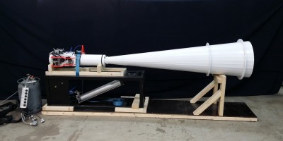

And the real setup.. (sorry for the bad picture)
Real thing.. 90mm porting piston valved hybrid. Diameter of chamber is 160mm.
There you can see the pneumatic cylinder that is used as a propane meter and pump.
All feed back and questions are welcome :wink: If you have ideas for improvement that's even better :D

Few more pictures from the SF Whatsapp group.
Re: New fueling system for hybrids (tested and works)
Posted: Tue Nov 11, 2014 10:53 am
by matti
mark.f wrote:Few more pictures from the SF Whatsapp group.
Thanks for uploading :D I think I should also do a post in hybrid showcase soon.. but I said the same thing about a year ago when it was "ready" the fist time.. but I have made lot of small and big modifications to this.. for example the piston has been made three times now, earlier two got bend :lol:
EDIT.. OK.. I don't want to make this a hybrid showcase post, but here is one better picture of the cannon in it's stand that can be tilted up with a huge pneumatic cylinder.. oh and If somebody did not know it's a vortex cannon, that's why the weird barrel.
But let's keep the topic in the fueling setup, I will do showcase post later.. :D
