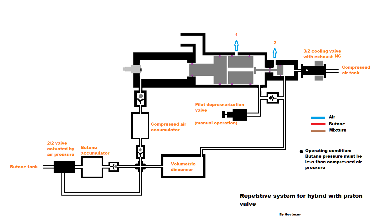

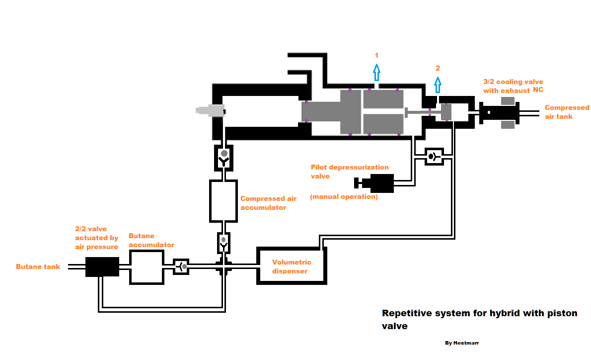

Sistema dosificador para arma híbrida con depósito de aire.png (32.3 KiB) Viewed 32448 times
This is the drawing of the system that I am testing in the video. It can be operated with an HPA reservoir or with a manual air pump, with the addition of a valve to depressurize after manually pumping air.
It can work with any hybrid piston with pilot.
Re: Hybrid repeat system
Posted: Fri Jan 08, 2021 6:43 pm
by PracticallySane
Are the supply lines under constant pressure?
The "butane tank" and "compressed air tank"?
It would be very interesting to see if you could make a GIF to show how it functions in the various stages.
Posted: Fri Jan 08, 2021 8:44 pm
by hectmarr
Yes, the butane tank is always open, and the compressed air tank is always open. Tomorrow I draw a gif so that we can talk and understand each other better.

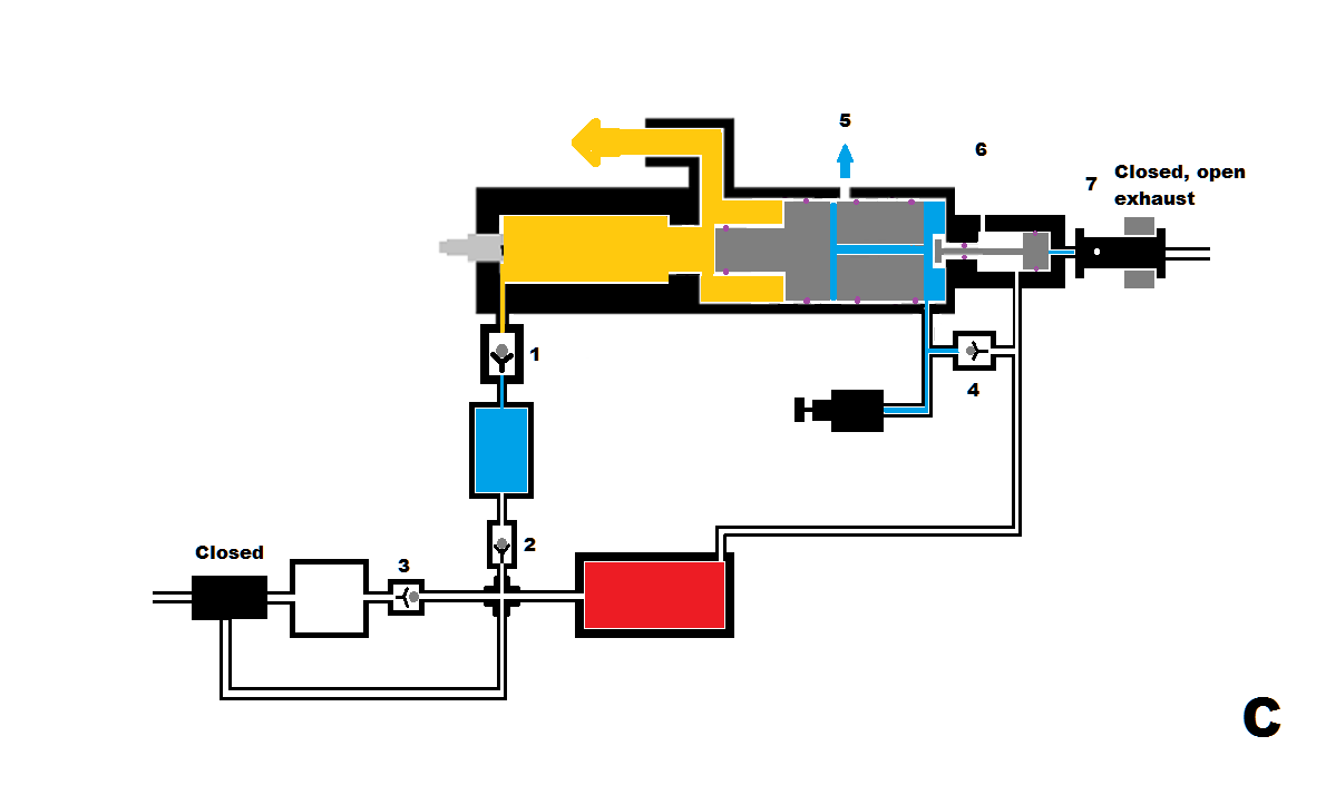

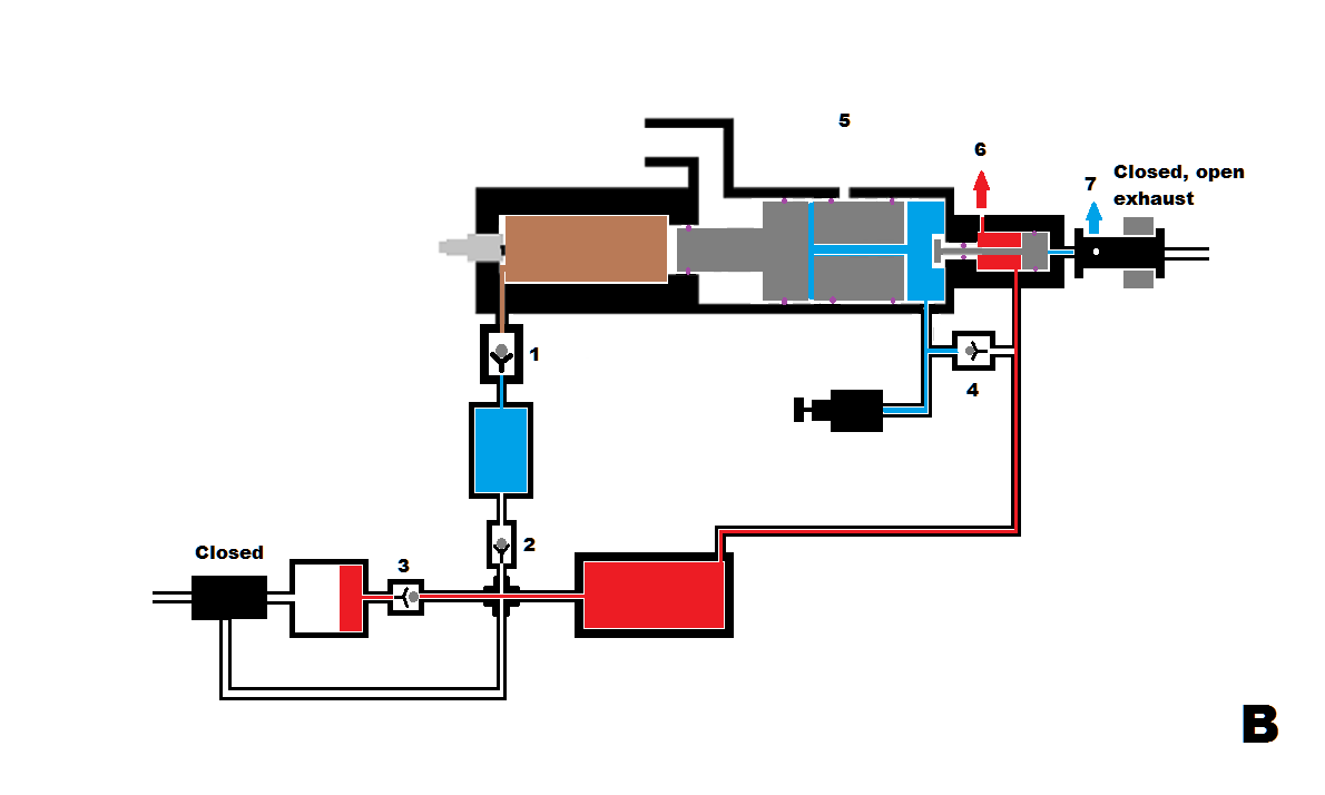

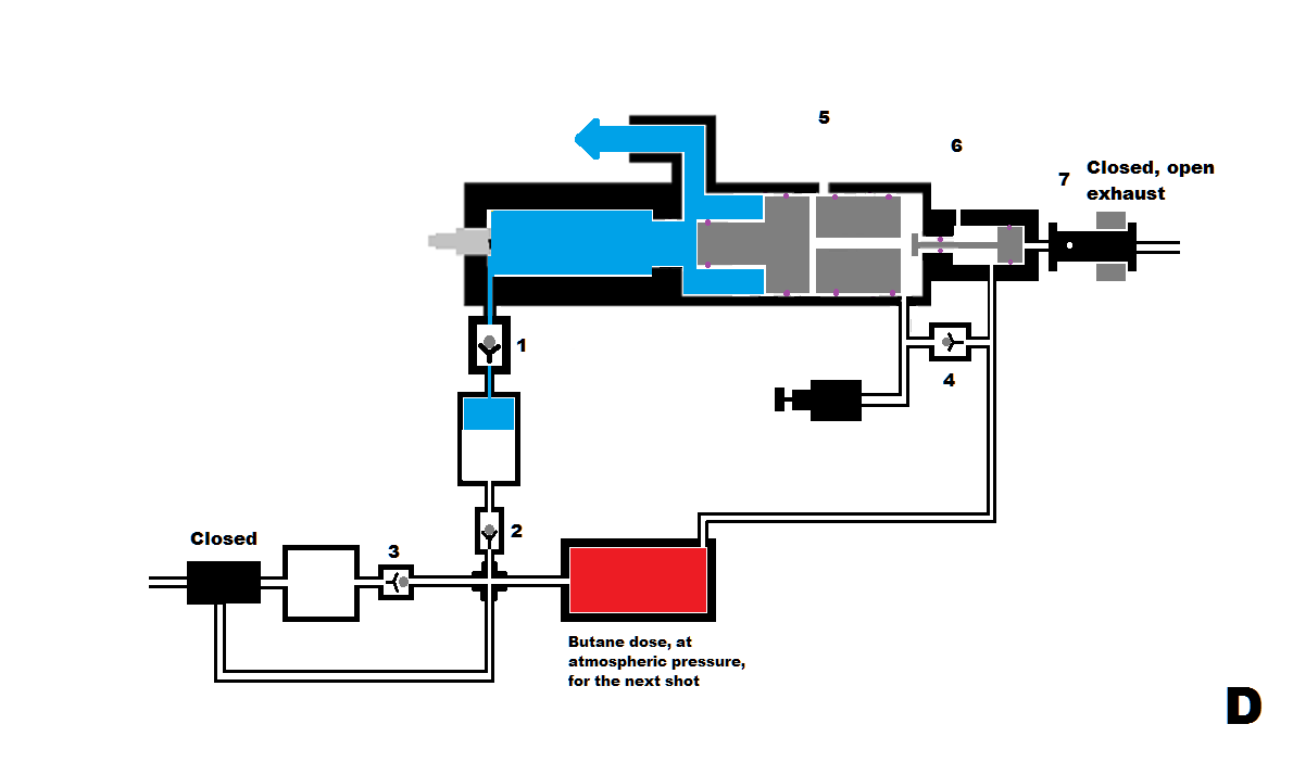

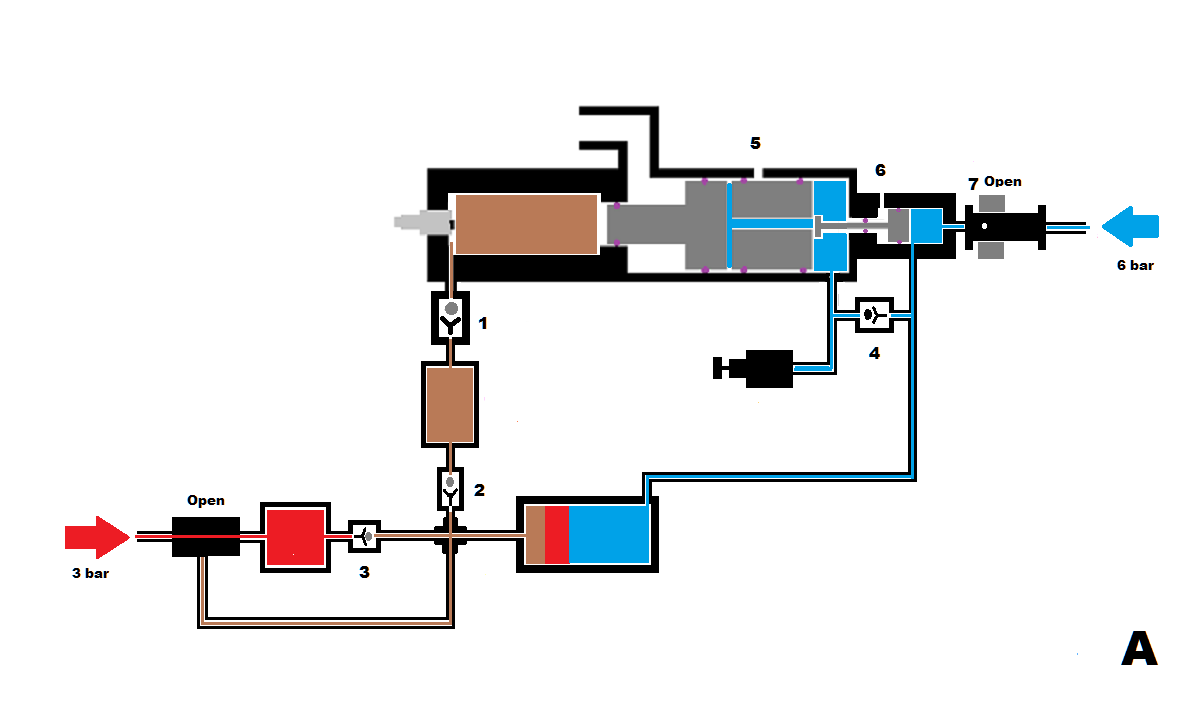

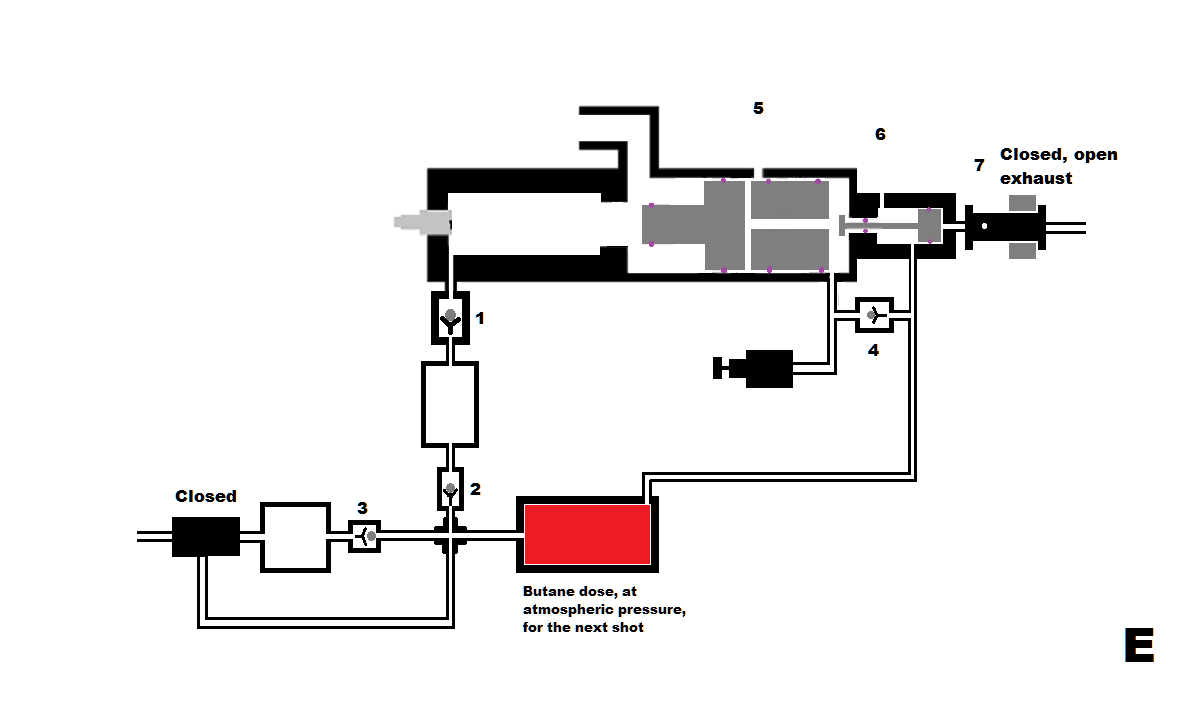

I leave the GIF here, to better explain the design. You have to open the image to see it as a GIF. Feel free to ask me what I want, if I can't be clear. Slowly, I will describe each component, those that are commercial and those that I built. 8-)
The references are:
A- Loading mixture into the combustion chamber
B- Loading butane in the dispenser, (for the next shot
C- Explosion
D- Cleaning the combustion chamber.
E-System ready to restart the cycle.
Then everything repeats again.

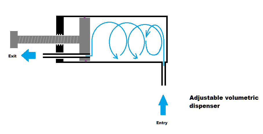

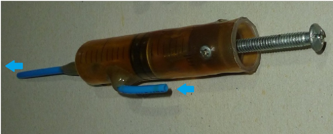

This is the dispenser. It is possible to vary the volume of gas, rotating the knob that has a threaded rod, to move the piston. I use it when I install the system, because being so small the amount of butane that I must measure, a little more or less hose, necessary to install the entire system in the weapon, changes the amount of gas. It is for fine-tuning the mix.
This device is only subjected to the compression pressure of the hybrid.
In my case, I use a 20 cm3 syringe, reinforced with a kevlar mesh, (disused paragliding rope strands), and fiberglass. If the hybrid has high Xs, it should be metal.
The one I use in the video is similar to this.
This dispenser also mixes butane and air, because when the fluid enters at high speed, it produces an energetic rotation of the two gases, and greatly favors the mixture.

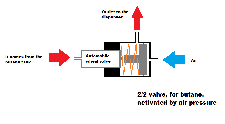

This is the valve that lets the butane pass into the dispenser when it is activated by compressed air. There are commercial ones, but I prefer to make it myself, because they are very cheap and I can repair them.
It uses a car or motorcycle tire valve, which is what the small piston, (6mm), depresses when air is under pressure. The stiffness of the spring regulates the activation pressure, about 4 bar in this case.

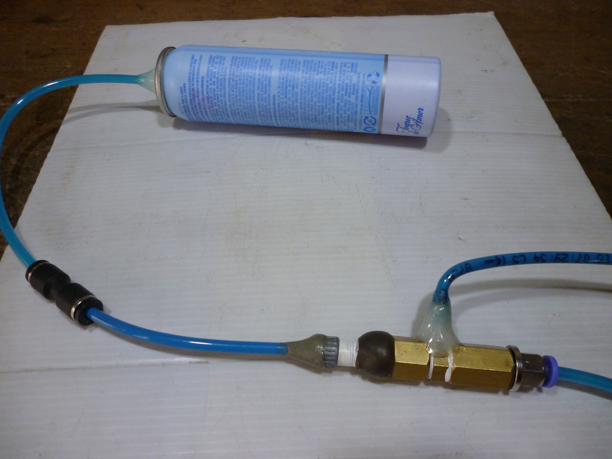

Válvula para butano accionada por presión de aire.png (11.64 KiB) Viewed 32394 times
Photo of the valve and the butane tank, a modified 110 cm3 aerosol, more than enough to make about 150 shots. It contains 40% of the total volume of liquid buthane, which is bought in 300-gram carafes, used to refill cigarette lighters.

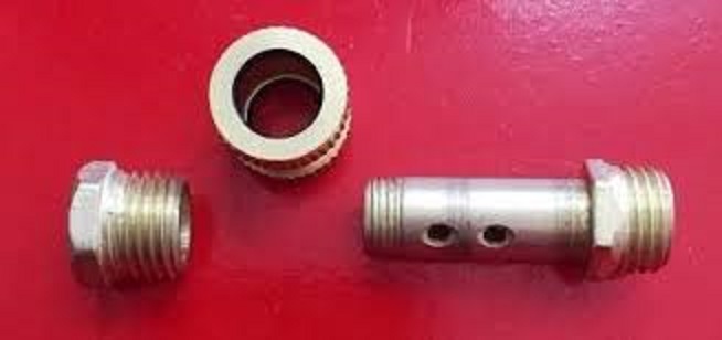

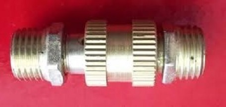

Válvula colizante.jpg (39.61 KiB) Viewed 32393 times
válvula coolizante desarmada.jpg (31.24 KiB) Viewed 32393 times
This is the three-way valve, with exhaust, that I use to activate the system, with each shot. It is bistable, but I have added a spring to make it normally closed. I used this one because I had it on hand, but you can use a commercial, three-way, two-position valve, manually operated or solenoid etc.
