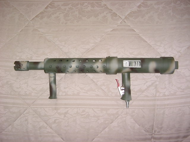

I had enough part left over from my first one I built to make another one. This one is a little different then my first.

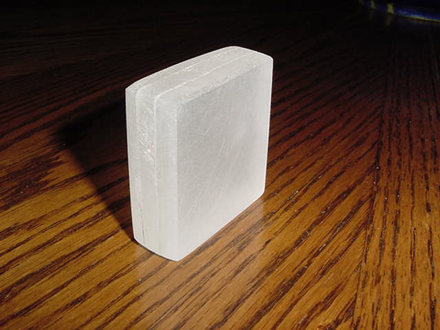

I made the vortex block out of 3, 2in. squares of plexiglass glued together with pvc glue. I used an air gun as the valve and cut pvc to fit it for a grip. I flared out the ends of the grip and the foregrip.
I used 13 in. long 5/16 brake line for the barrel. The next one I build is going to have an airsoft barrel from airsplat.com.
The window is 1/4 in. plexiglass.
Painted it camo with krylon flat paint.
I drilled out the full length of the barrel shroud.
The vortex block ready to drill

It looks great. post some damage shots.

nice build.looks great

Oooo....vortex block.
Looks like a block of ice

that vortex block should look pretty cool once its drilled (not like it matters, it wont be seen while in action). but atleast you know it looks cool.
nice job on the camo paint. though it's simple, i still like it. also, i really like how you flared the handles, it adds a nice touch. how did you do it?
torch?
boiling water?
oven?
and nice job on the silencer.
anyway, over all nice gun.
hope to see more creations from you in the future (and some vids :wink: )

I held the pvc end in front a radiant heater till it softens and used a file handle to flare them out.

hmm...nice idea...effective, yet safe (to an extent). nicely done
