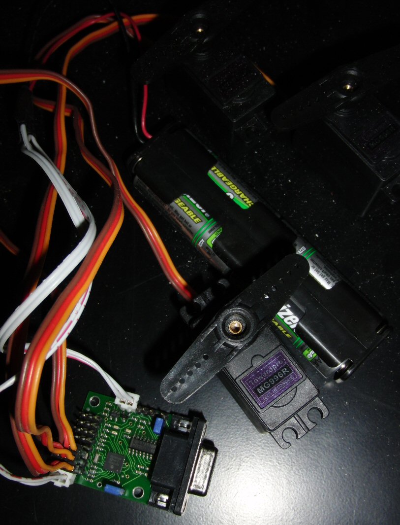

When unconnected, I can move them by hand, but when plugged in they become stiff as a board and bright green.
From a servo forum:
That is far beyond what 4 AA rechargeables can supply, and from what I've read this particular type of servo has heavy gears and therefore quite a bit of inertia.I can make the HS-645MG go to 2.2A by trying to force it out of position, it’s datasheet does not give a stall current, just a much lower “running current” of 450ma (no load maybe). Most of the other servo’s I have here are “similar” in what they draw. An MG996R can draw 2.5A

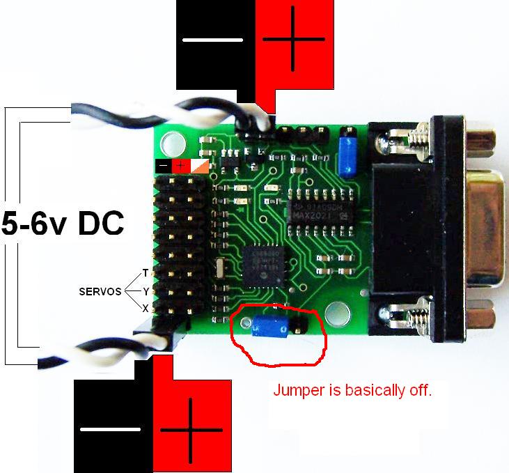

Here is the problem! You need to change protocol jumper!
How do I do that?
Are you saying I should remove the blue thingy and move it to the position you circled, ie the one in my photo is in the wrong position and the one in yours is correct?
You sound like a women now! "Pull the blue thingy"
That picture is from "Sentry Project" photo.
Pull the blue jumper off and reposition it like in the photo.
He must be using the Pololu protocol in his software.
Pololu Mode: When jumper is open (no shorting block), that is the Pololu protocol used for controlling multiple serial devices. In this mode, the
servo controller can be on the same serial line as other devices such as our Dual Serial Motor Controller. This mode also allows access to all of the special features of the servo controller, such as setting speeds, ranges, and neutral settings.

HAHAHAHAHA! SUCCESS!!!!!!!!
Thank you so much Duane, you're a genius!
