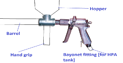

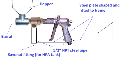

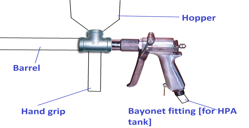

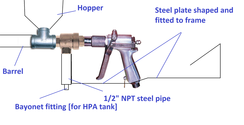

So my big plan in terms of projects is a HPA backpack and good all round BB gun [that can shoot both airsoft and steel BBs].
I already know what i want the BB gun to look like, but i have come to an intersection and i do not know which way to turn!
What are the pros/cons of having a QEV added to the BB gun?
NOTE: The gun WILL be regulated. Max pressure being used will be 500psi.
NOTE: If i eventually just get fed up with having to fiddle with nasty little spray guns [i only like them because of the shape, makes it easy to work with] i will just make something like this:

The QEV will hold more pressure and exhaust will be faster but the second one would work but i think 500 psi would rupture it, im not sure maybe if you have a 500psi blowgun.
- Mr.Tallahassee
- Posts: 364
- Joined: Sun Jul 10, 2011 2:35 am
The only issue with using a QEV like that is that the QEV will not close when you let off of the trigger. Using a modded blowgun for bb sized projectiles is plenty.

Mod the QEV for chamber filling. It can take the pressure. The QEV will be way more powerful.

This model of blowgun is actually a spray gun, and can take 800+ psi ;Dbut i think 500 psi would rupture it, im not sure maybe if you have a 500psi blowgun.

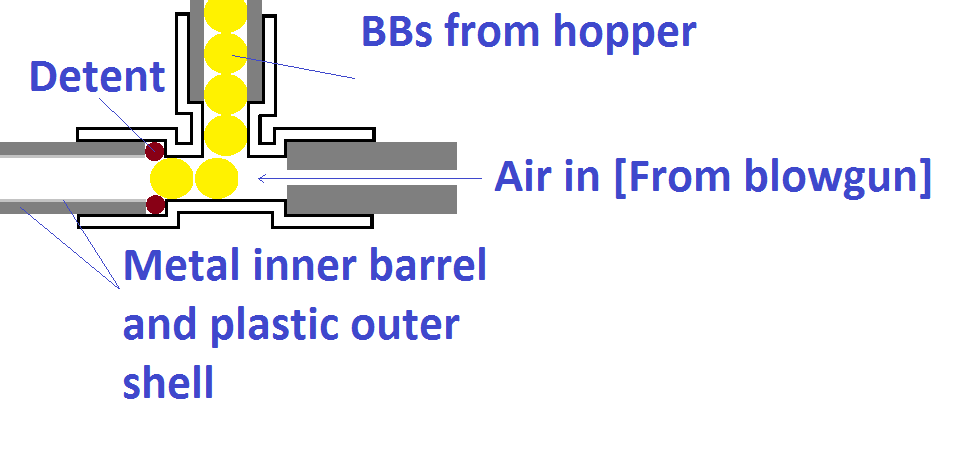

What about this JSR?

that could work but wont be very powerful because the next bb will block all the flow.Pneumaticology wrote:What about this JSR?
