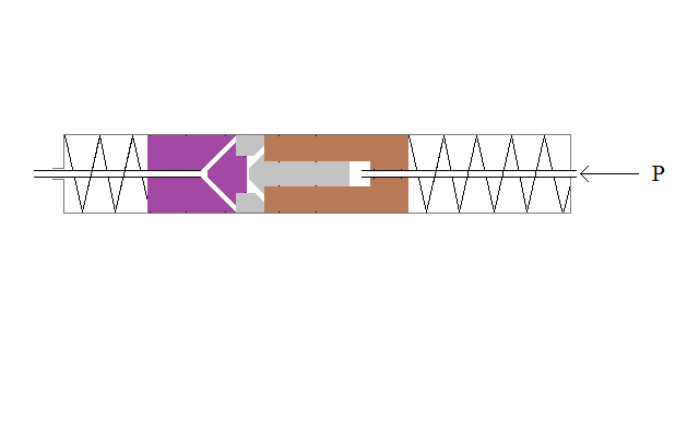

Blowback system, will this work?
Hey guys
I thought of an idea on a blowback system to be used on airsoft/bb guns.
The brown part is what gives the blowback feel.
The brown bolt could be made of some heavy material, like brass. It moves back, letting air push the blow forward purple valve, which in turn loads a bb and fires it. The middle gray part does not move.
The black dots are supposed to represent O-rings.
The hardest part to get this system to work is probably getting the spring tension right since there are two valves and they need to work in sync.
The pressure supplied should be in bursts, like a QEV+popoff or a 3/2 valve with a chamber.
What do you guys think?

So basically the grey part is fixed, the brown part blows back first then allowing the air to go through the purple part which blows forward?
The concept is sound, but do you have the resources to make it?

Seems a little more complicated than it has to be to me. I think JSR's blow forward design is about as simple as it gets. However I do like the way you incorporated two valves into the whole little system. But again a little too complicated. The biggest problem I see with it is that the flow through the system is a little interrupted because it has to go around too many parts. Will it work? Sure, if you make it right and tune it in perfectly. Is there a better and easier way? Probably.
Just my 2 cents!
Just my 2 cents!

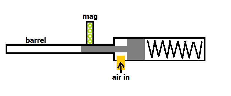

I can, I'll post a little diagram.
This is extremely simplified for ease of drawing in MS Paint, but you should get the idea. This design could not be used with a constant air source because it would probably just stick open and not re-cycle. QEV pop off or semi auto via three-way valve would be optimum in my opinion.

The mag can be capped off and made airtight I suppose...

I was building a similar system as Gun Freak and JSR posted, right now I'm just not decided to use a QEV+3-way (I will make them myself of course as I need custom sizes) or a hammer valve. Hammer valves are more consistent and higher air efficiency and easier to suppress but QEV+3-way are more simple. Do you guys think that duo to the aerodynamics of the bb, the inconsistency of a QEV+3-way is insignificant?

If you're making something as precise as that I would think you'd want a very consistent valve as well, so a hammer valve would be my choice. But you may as well test the blowback with a QEV before machining the whole hammer valve system...
Wyz, inconsistency will throw your accuracy to shïte, so hammer valve all the way.
