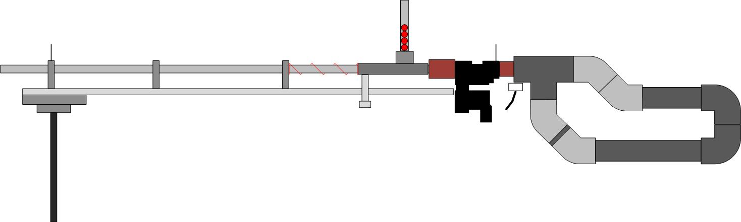

This might be my final build for awhile, I've built pretty much everything I want, well maybe that target pistol :idea:
I'm calling it the LEE10, ammo is 10mm ball bearings, magazine will hold 10, bipod from BFG will fit, making iron sights for this one.
Lee - Copy2.jpg (30.97 KiB) Viewed 7537 times
Will be roughly the same scale as the Lee Enfield

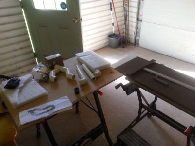

Sat Oct 07, 2017 2:44 pm
And so it begins

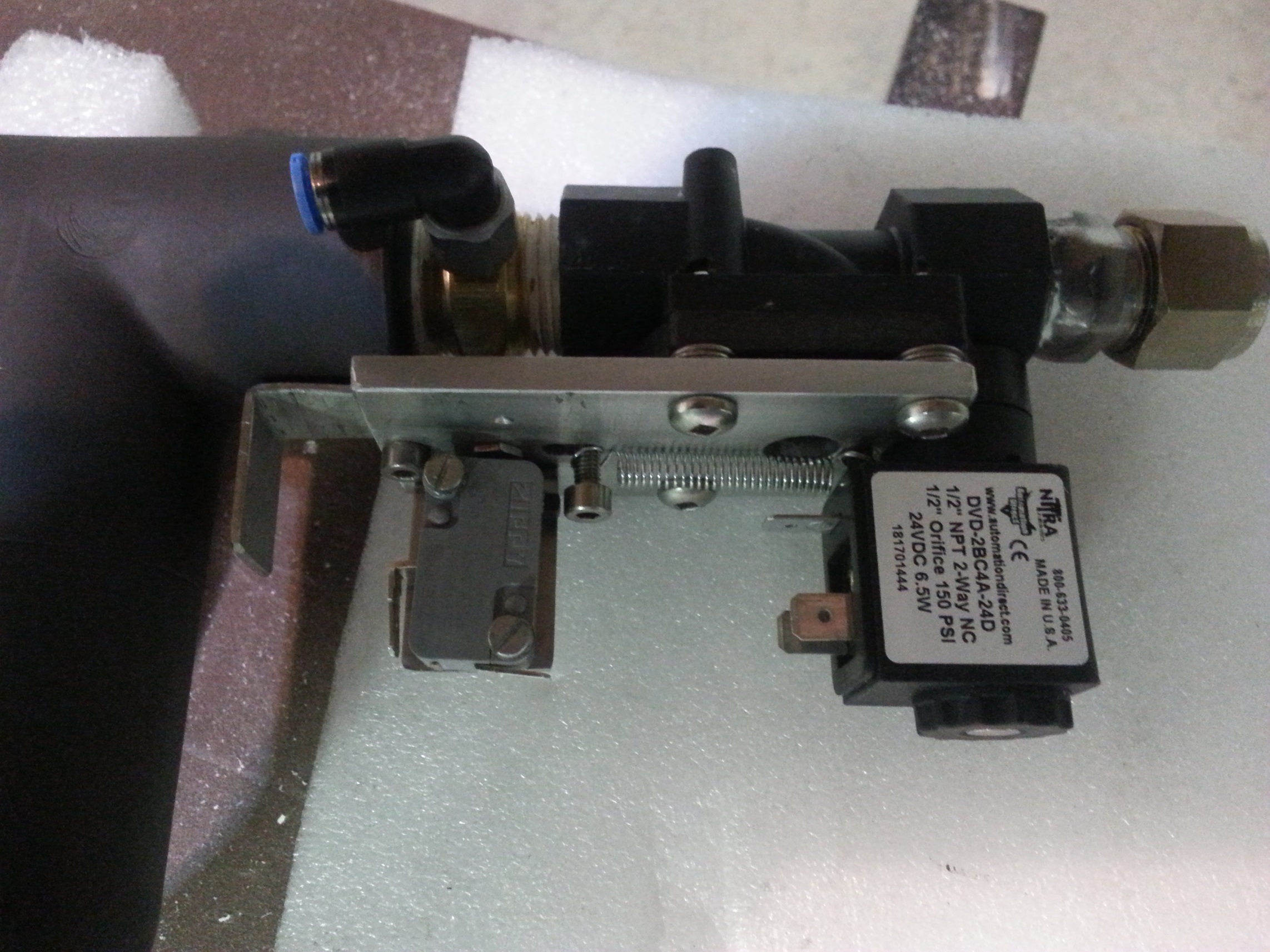

Tue Oct 17, 2017 5:32 pm

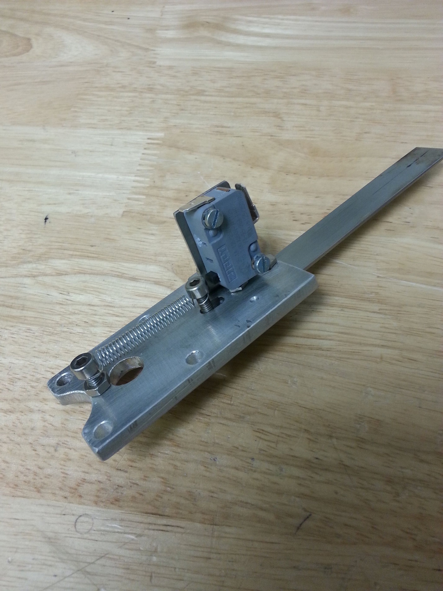

Playing with the trigger switch a bit, the slide has 4mm of travel to actuate the micro switch.

Fri Oct 20, 2017 7:02 pm

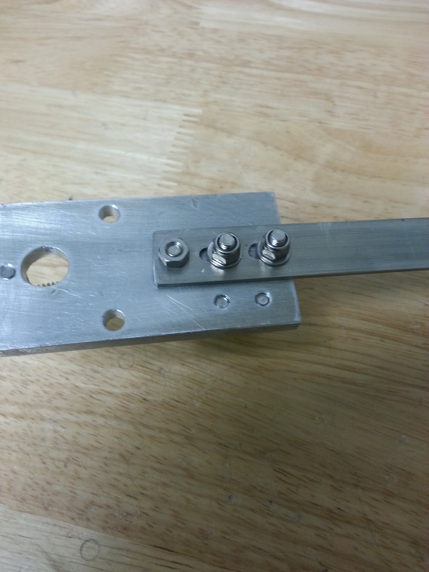

Finally got the trigger to fit, very tight.
Just hope the valve is quick enough, spec. for valve is 20-80ms for complete cycle

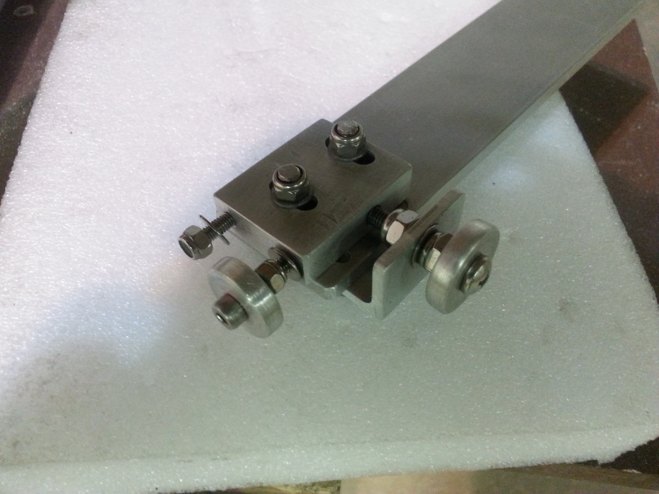

And working on the sights, adjustable elevation and windage.

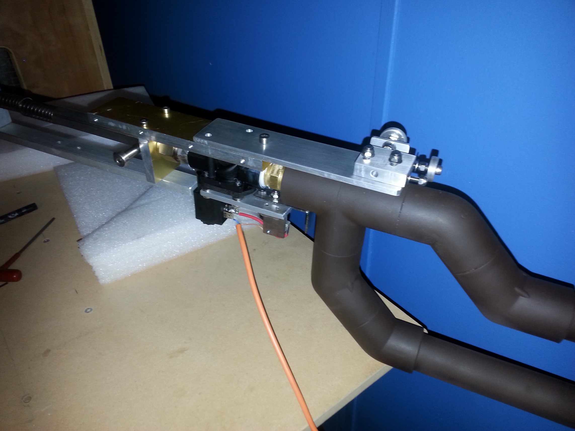

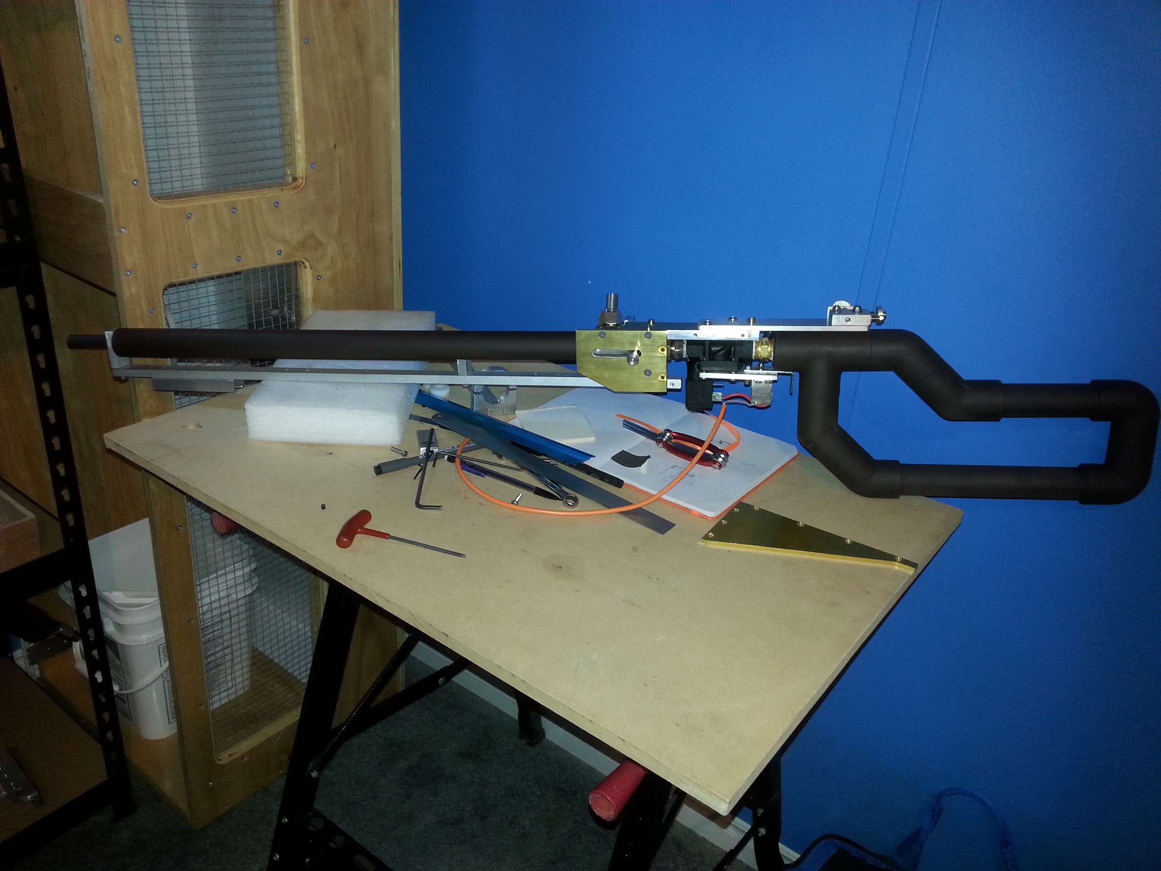

Sat Oct 28, 2017 7:51 pm

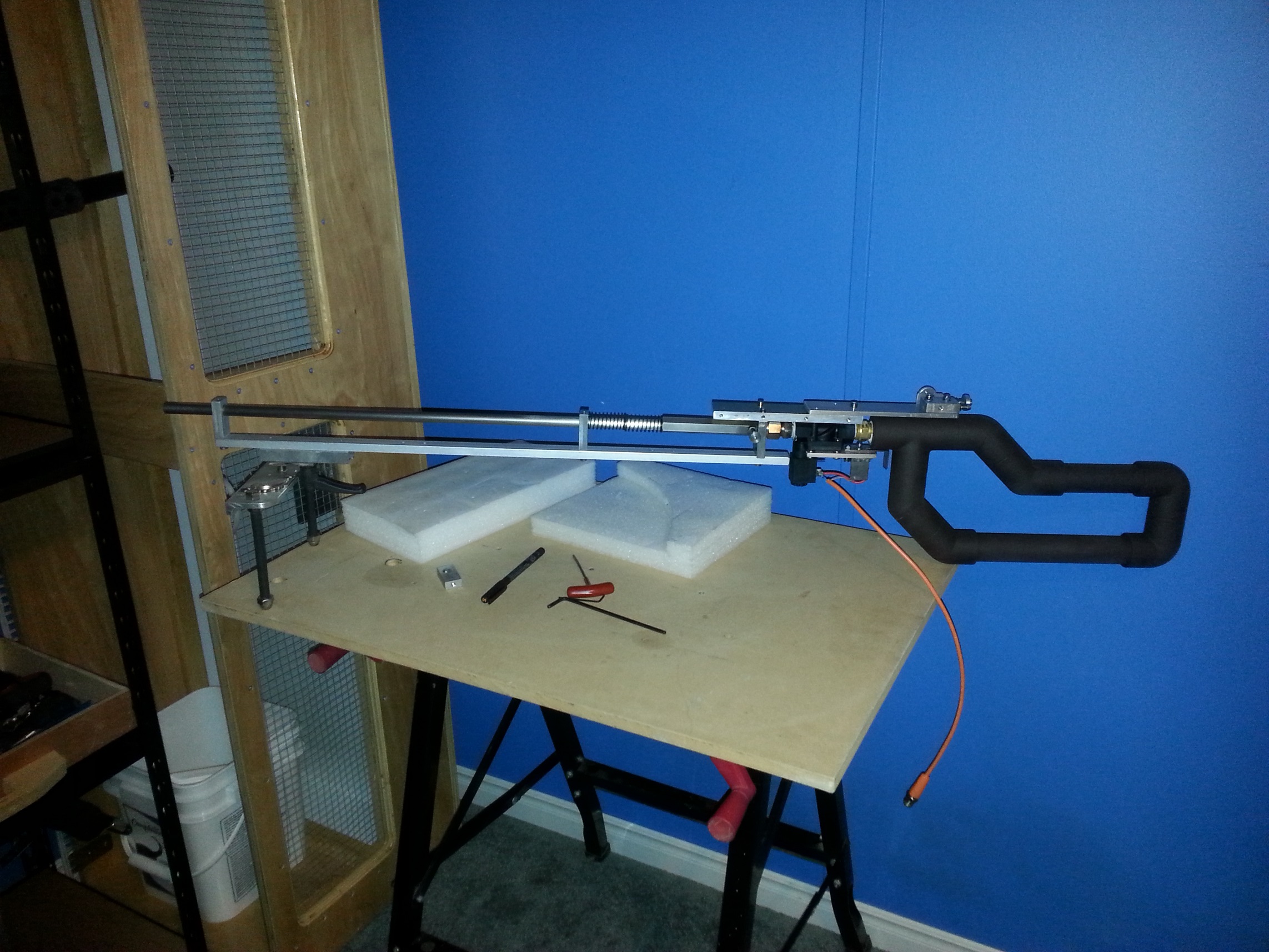

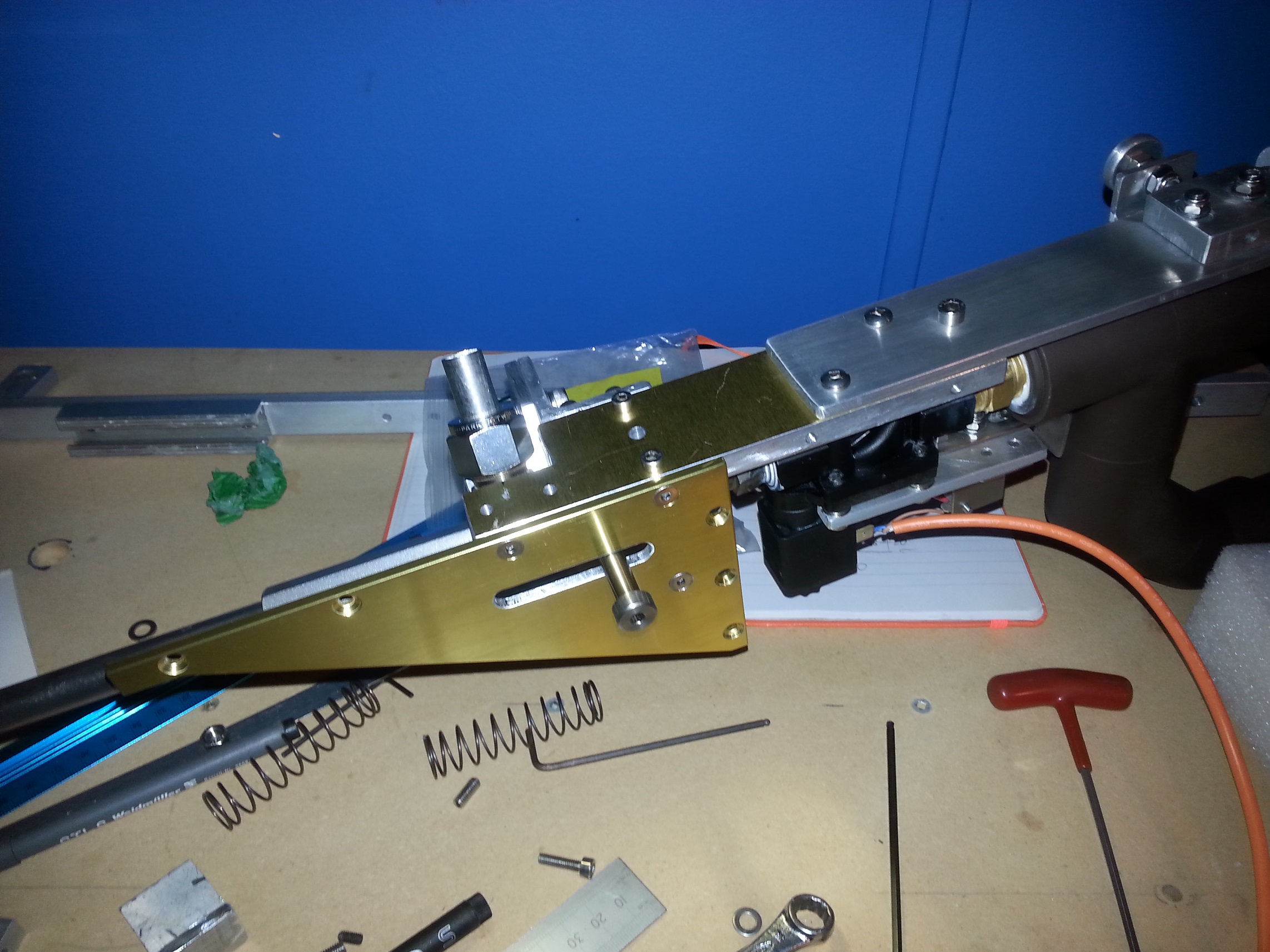

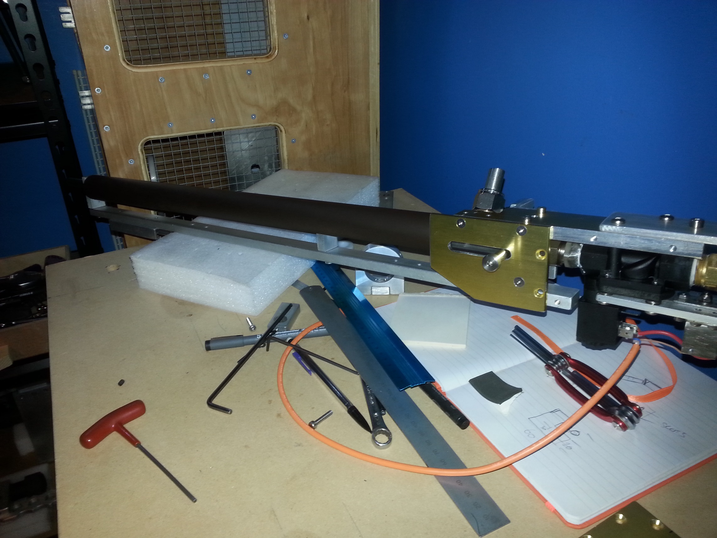

Moved my assembly bench inside as
Put some more parts together.

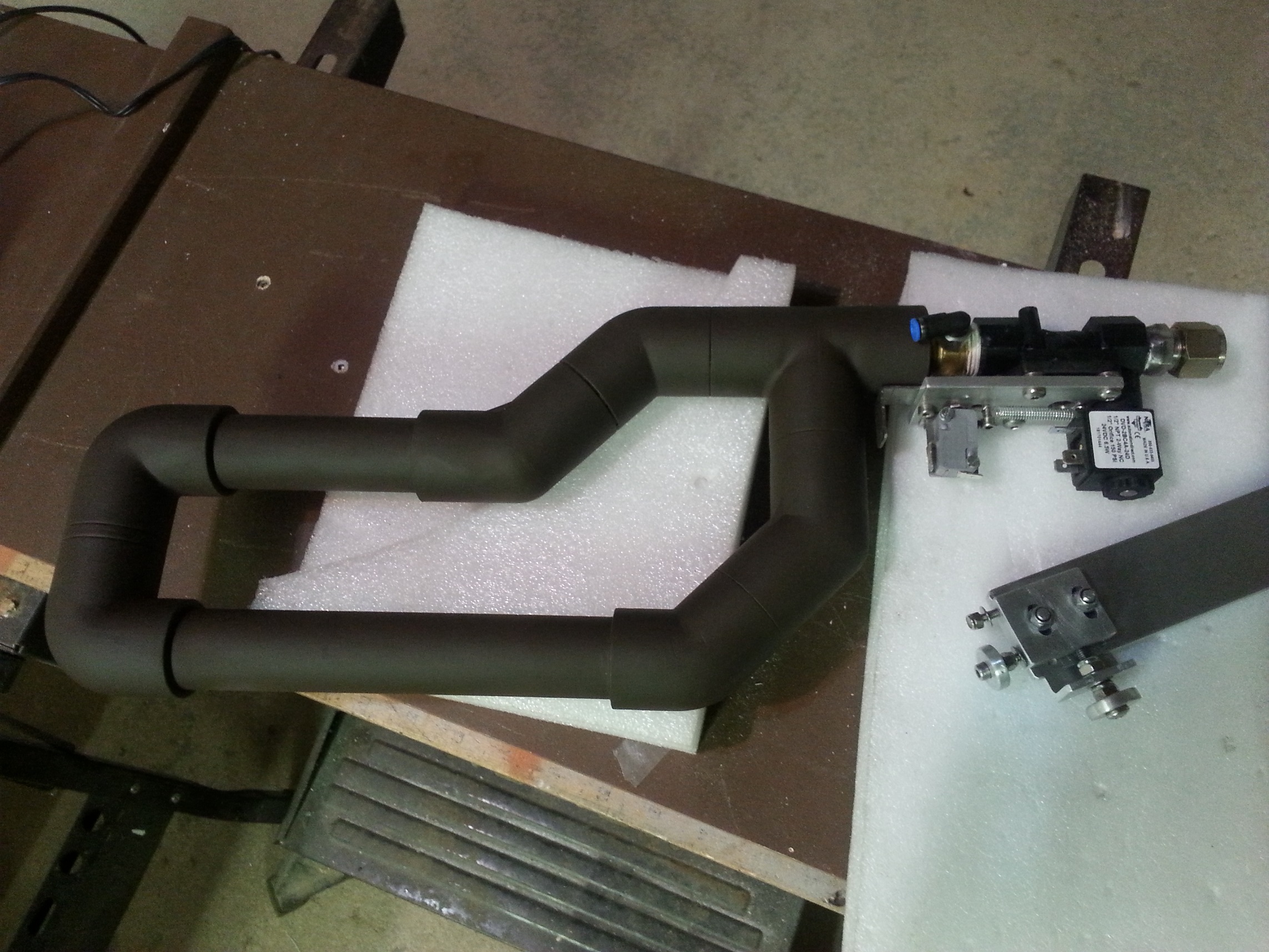

Some 'Golden Gun' work, the short tube holds 5 rounds

Sat Nov 04, 2017 4:56 pm
Locking good:) are you going for single shoot? In my AK6 i need to go over 20volts to make it trigger at 20bar and 25bar i use 30v. My is rated for 12v and 20bars:P So boost the voltage and it should go faster! Ad a capacitor. btw do you have a link on the solenoid valve?

Sat Nov 04, 2017 7:03 pm
I am using 24Vdc 1Amp unregulated power supply, so it sits at about 30V when it's not loaded.
Single shot with a self loading bolt action. The valve is rated for 10bar max and the stock/chamber is PVC so I can't go over that anyway :shock:
This is the valve https://www.automationdirect.com/adc/Sh ... -2BC4A-24D
On the plus side it is very light and it cost me $0.00, my favourite price :D

Sat Nov 04, 2017 7:20 pm
I see. Sounds good. Think you will get some power out of solenoid at your PSI ratings:P
Have tried my 3way solenoid up to 50bars and 10mm steel balls! It was rely hard to get it to open:( i can just say holy fuc# ! Got 100 jouls of energy! The recoil was insane! Dumped a hole soda stream true the qev in ms :P hehe

It's about the journey, not the destination :shock:
