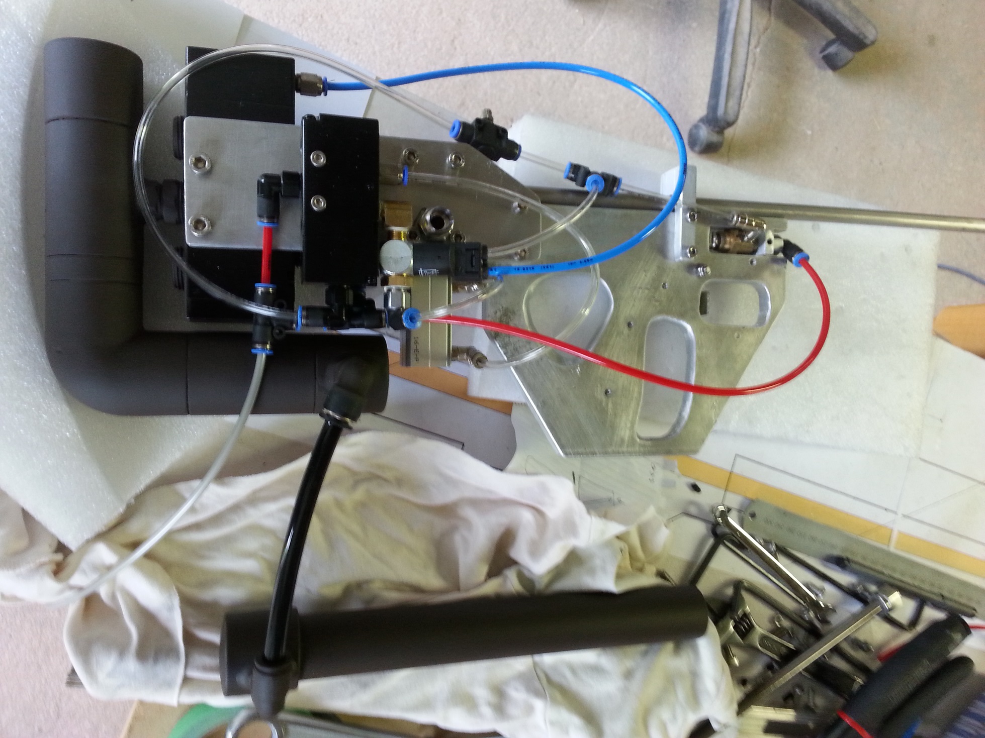

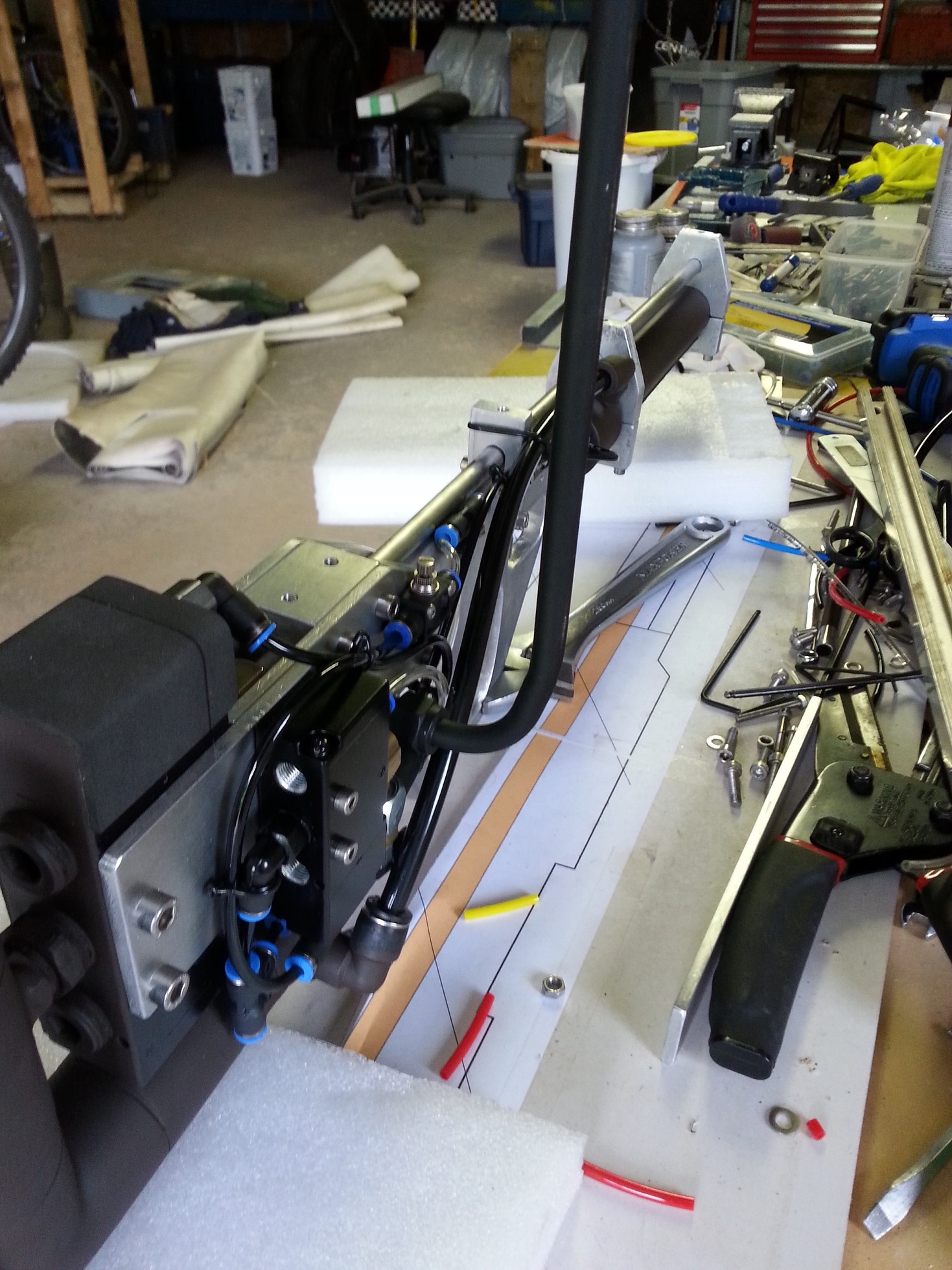

Got enough parts assembled to test fire, the small cylinder will do the reload, magazine tube tube attaches to the threaded fitting on the side.

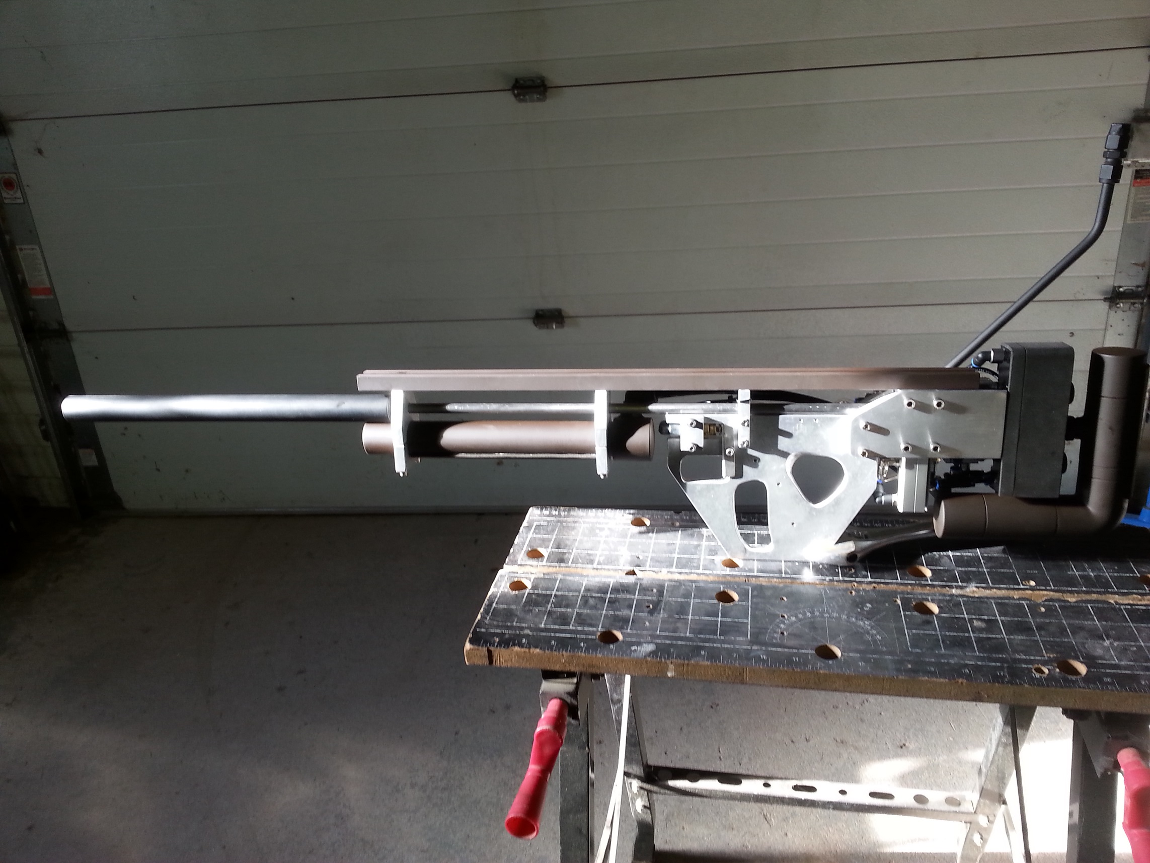

Sun Sep 17, 2017 2:29 pm

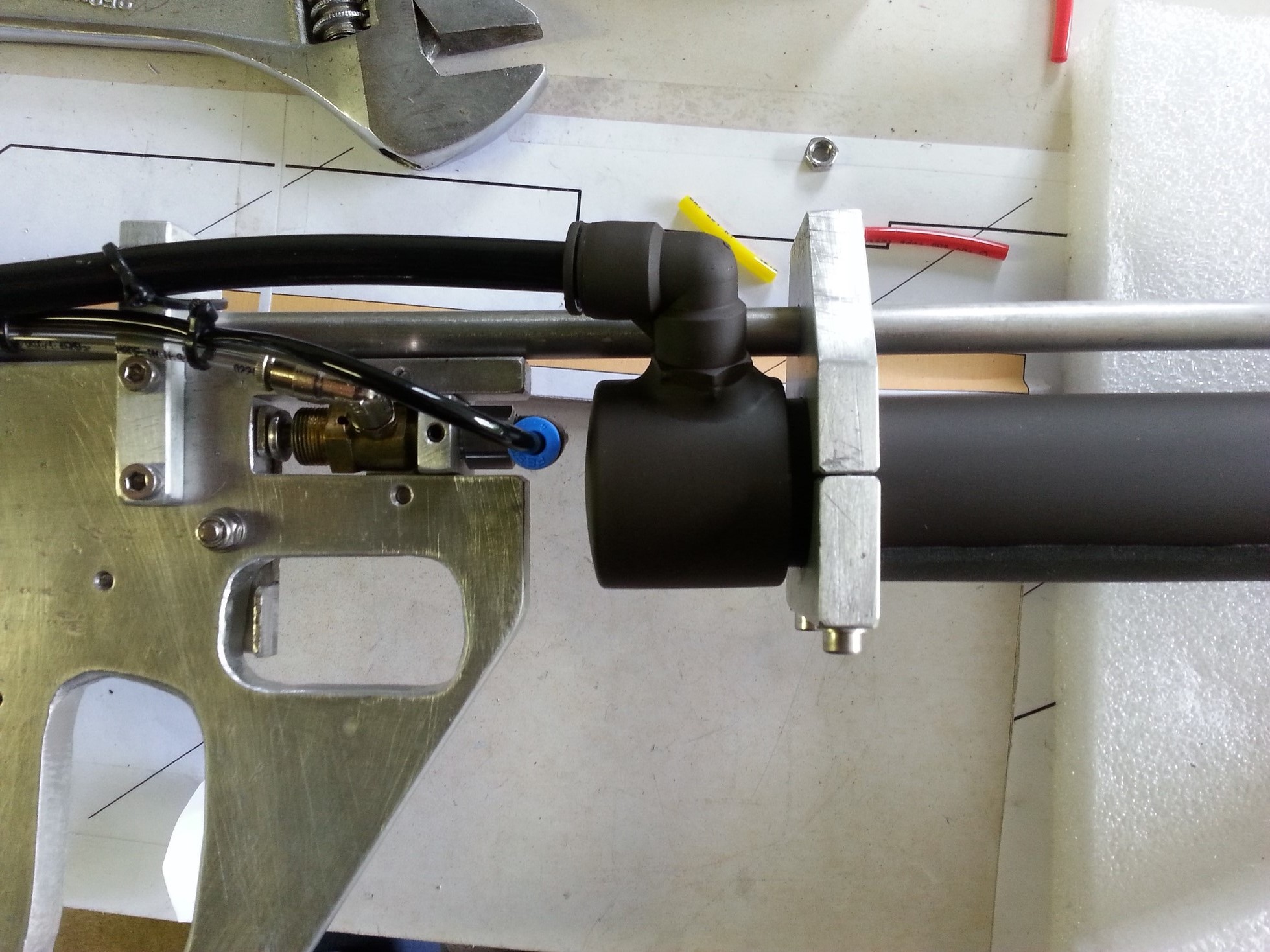

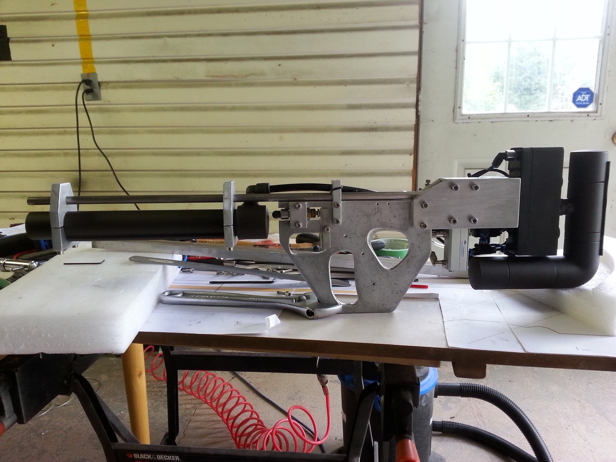

tidied it up a bit, still got to make nylon grip pads, palm rest & attach the mounting rail for the scope and bipod.
Mon Sep 18, 2017 5:11 am
Shaping up nicely! It's odd though to see that lovely metalwork juxtaposed with PVC pressure chambers.
farcticox1
Posts: 1082
Has thanked: 69 times
Been thanked: 98 times
Mon Sep 18, 2017 6:15 am
It's called 'Art' and I did paint the pvc brown :D

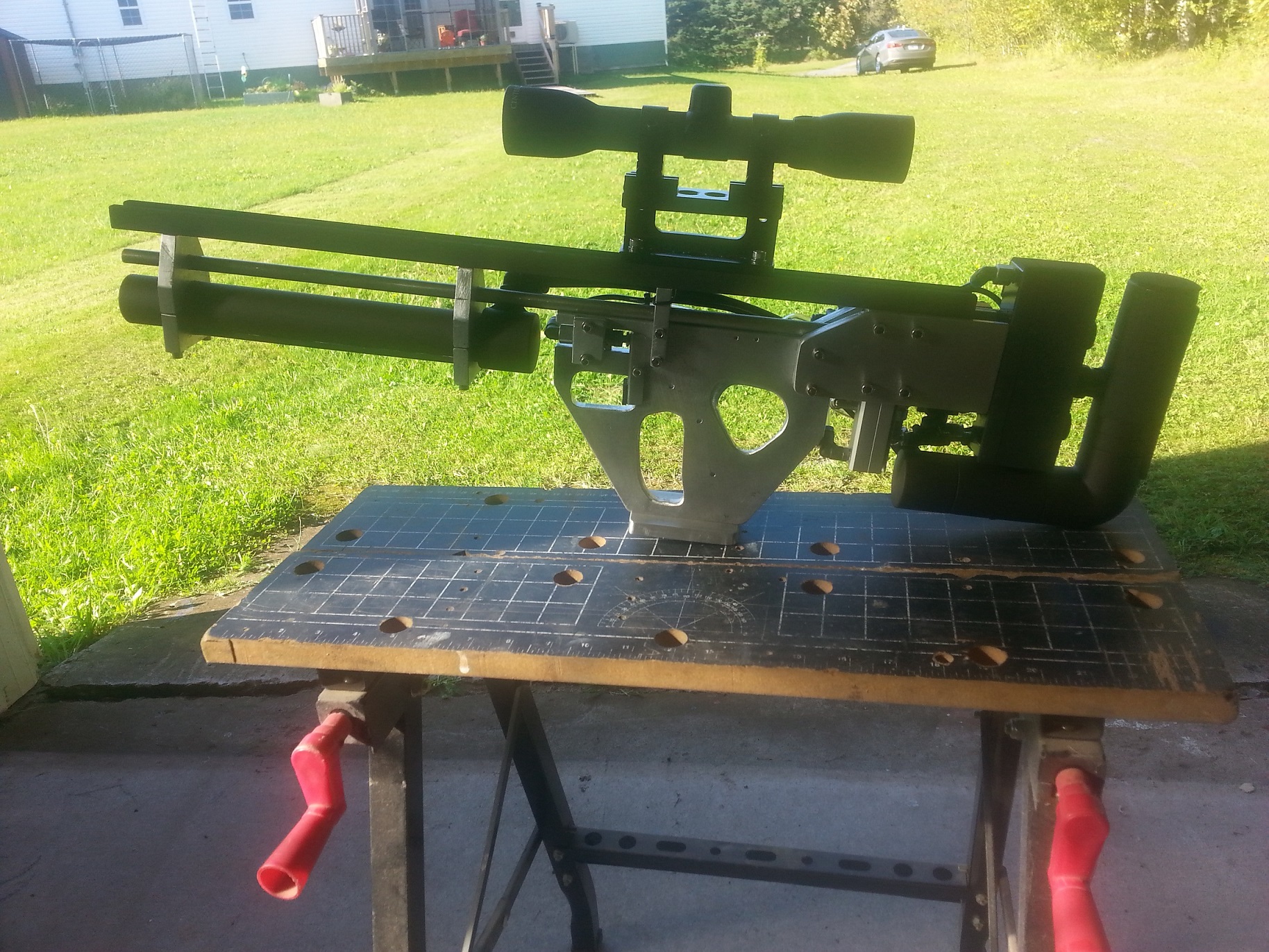

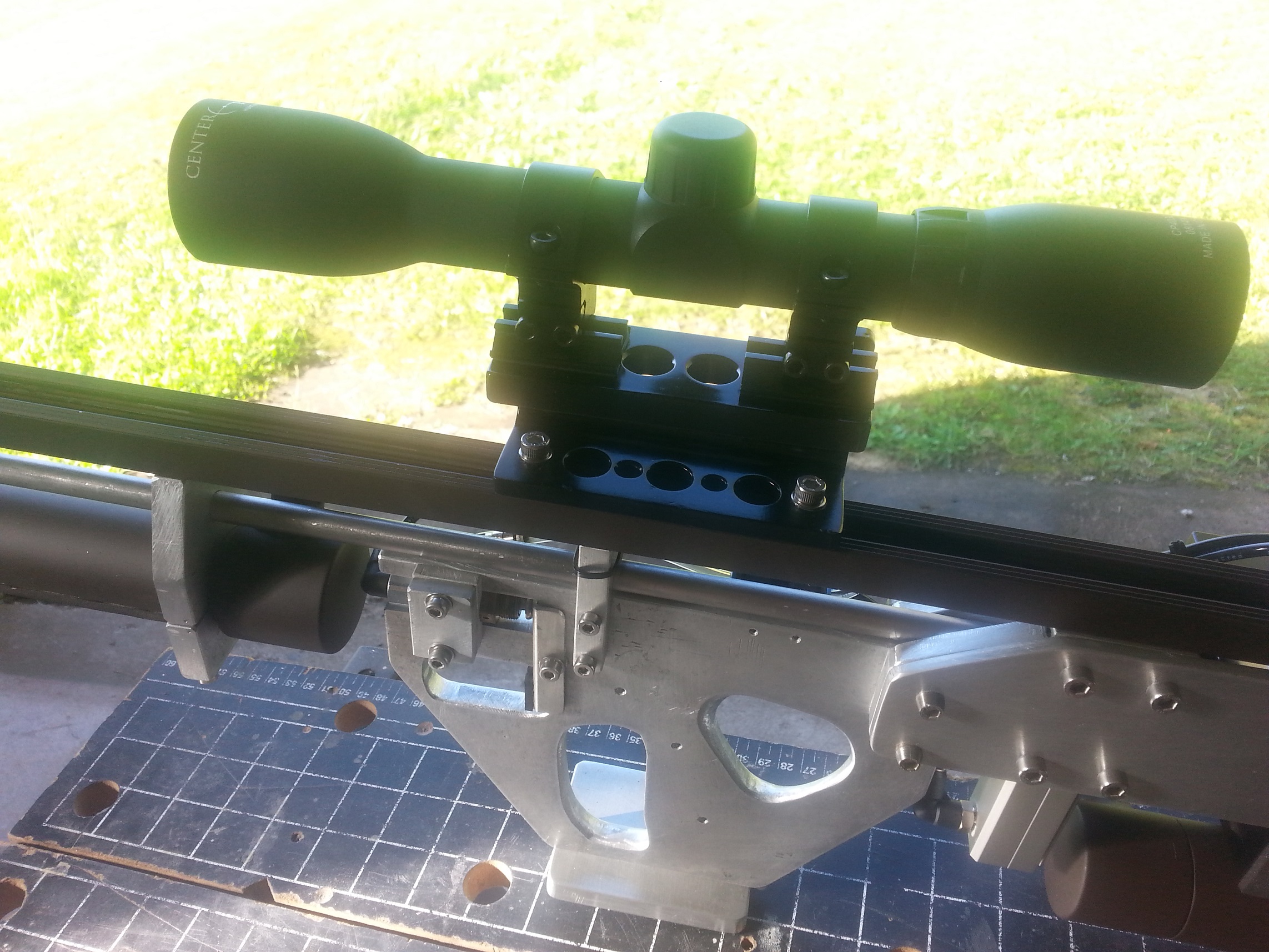

Sat Sep 23, 2017 3:47 pm
Scope mount finished.

Argentina
Posts: 1064
Location: Argentina
Has thanked: 274 times
Been thanked: 276 times
Sat Sep 23, 2017 4:04 pm
This job looks great! I really like the look. Waiting for video test shot, with telescopic sight. :)

Sat Sep 23, 2017 6:10 pm
The high scope reminds me of the AUG :o

Sun Sep 24, 2017 4:08 pm
Yes I did consider covering it in more, but just more weight and time spent for no real gain.
Dropped the scope about 10mm and moved forward 20mm.

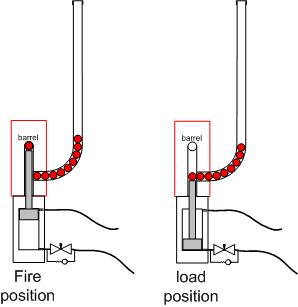

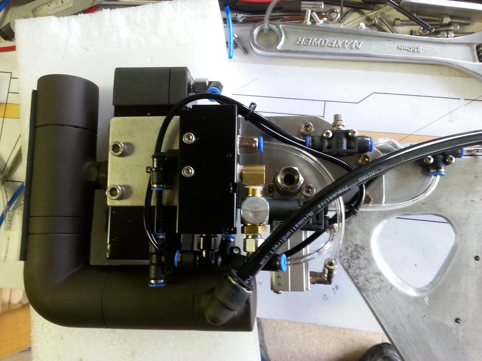

One problem I discovered was double feeding, especially when the ammo tube was full, I guess the extra weight was the cause. When fired, some air leaks into the ammo tube and shoots the BBs up, (you can hear them rattle) and because the reload cylinder opened the instant the main valve closed the BBs were managing to feed 2 instead of 1. I put an exhaust restrictor on the reload cylinder to slow it's opening and make sure the BBs have settled before it opens the port. It slows the reload cycle time slightly but does seem to stop the double feed.
This is how it works inside
