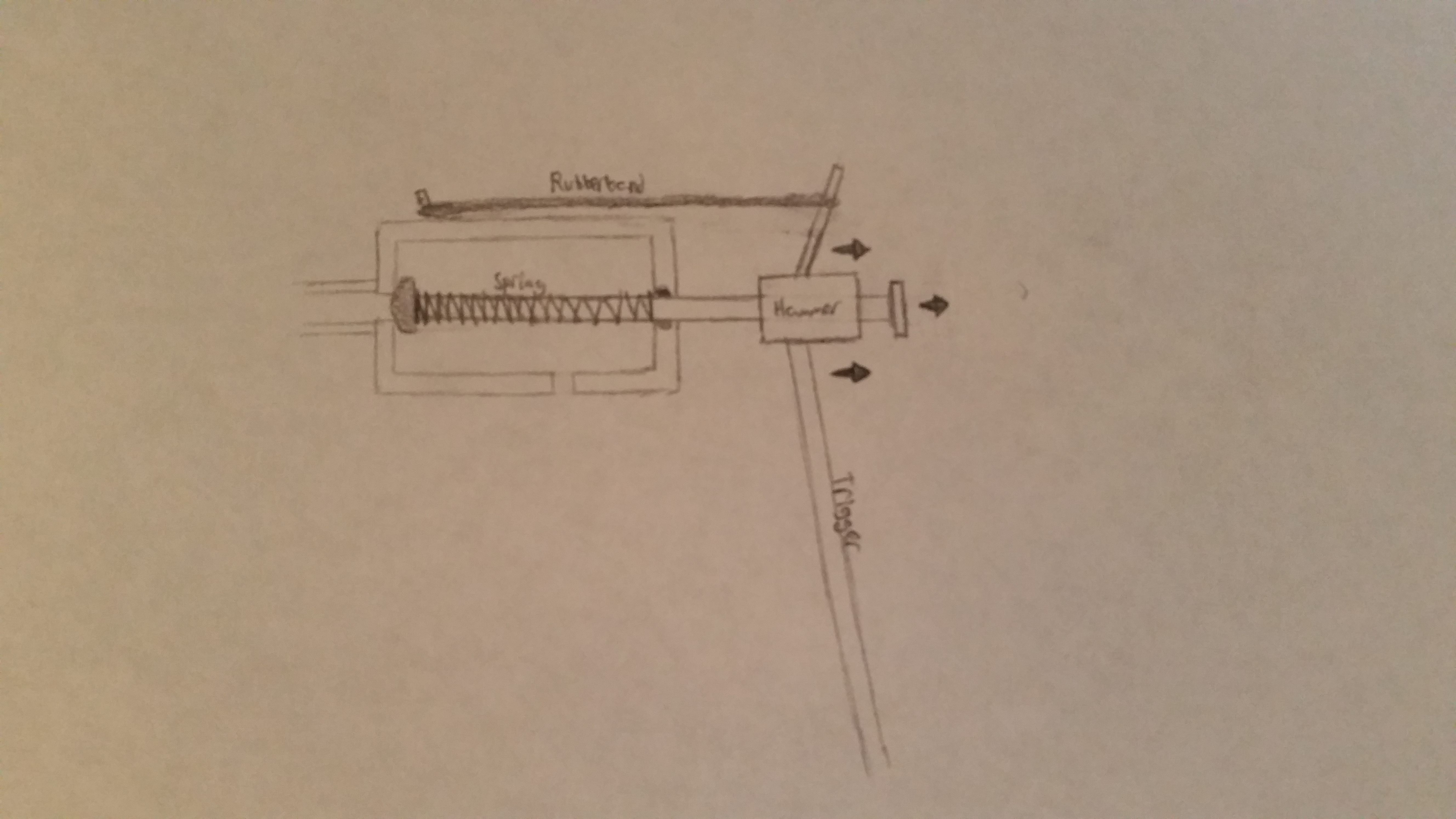

No, my valve looks like this Image
Fri Oct 26, 2018 5:00 am
keks2033 wrote:No, my valve looks like this
Rehosted the image elsewhere as it was not appearing:
I'm having trouble relating it to the video though.
My impression from the diagram is that the trigger pushes the red part forward against the spring. At some point, it is released, and it moves backwards under spring power, and knocks the valve open.

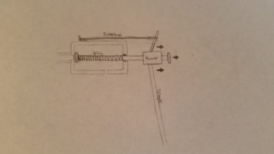

My impression from the diagram is that the trigger pushes the red part forward against the spring. At some point, it is released, and it moves backwards under spring power, and knocks the valve open.[/quote]
like this? Image

Apologies for the terrible picture. Anyhow, it looks to me like a sort of reversed hammervalve, where the trigger taps the end of the piston rod, pulling it back just long enough for a burst of air to leave before being closed by the spring. That's what it looks like to me, at any rate.

keks2033 wrote:like this?
A bit like your "shock trigger" double action only mechanism but in reverse?

Both of you are absolutely right!

keks2033 wrote:My impression from the diagram is that the trigger pushes the red part forward against the spring. At some point, it is released, and it moves backwards under spring power, and knocks the valve open.
like this? Image[/quote]
Interesting and ingenious "inverted" system. The best, see it built and running !. Inspiration for me regards :)
