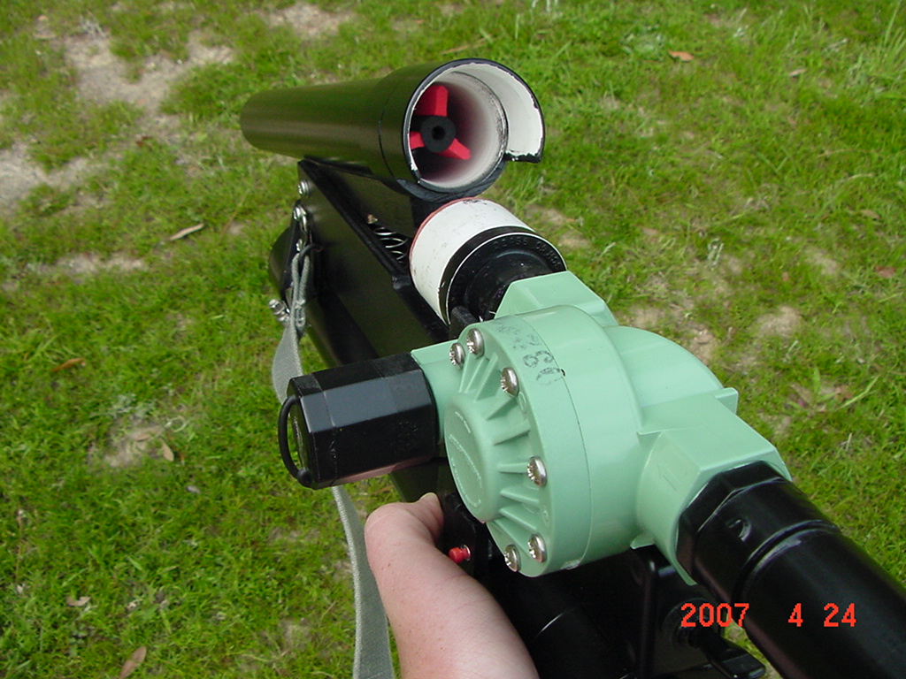

This baby has been my pride and joy for the past couple of months.I built it for use at paintball scenario games.I tank hunt so this is my prime weapon.So far I have been very succesful with it, 20 confirmed tank kills in the last game.Not to shabby for the first time out.Hope ya'll enjoy and
VOTE FOR GOAT
Specs:
Overall length:40 1/2"
Air chamber:2" sch.40 18" long
Barrel:1 1/2" sch.40 18 1/2"
Valve: Standard sprinkler
Action:break open single shot
Operating pressure:80-145 psi.
Detachable stock
And a video of me loading in 5 sec.(sorry vid quality VERY BAD)
[/url]
Me firing and filling
http://s167.photobucket.com/albums/u148 ... V00241.flv
- Cartridge in position to have ammunition loaded
- loaded football
- Ammumnition and respective cartridges.
Left to right:large cartridge,smoke grenade,24rd shotshell,half cartridge,12rd.shotshell,and nerf football.
- The fire control mechanism.The toggle is safety and red is fire.
- spead pattern of my 24 rd. shotgun load(I accidently aimed a little low)
- side view showing extra shell holder
- Here is the beast........and the cannon

I know folks told me that I should put a sight on.Well, I did. So here is the Goat Gun with new sight rail.I found the rail in some old parts that came with my phantom.I drilled the barrel and screwed the sight rail down.
- the sight rail and red dot sight
- You can see here the sight is off center to accommodate a paintball mask.
- The whole setup

Sorry Briar, I winged this gun.It's not that hard to figure out(KISS principle in action).The only thing worth noting is the female adapter were the stock screws in. The connector pipe(in between the adapter and T) is filled with JB weld to stop the stock from filling with air. That and the action is made out of 1/4" marine plywood.See if you can figure it out from the pics ,anything else just ask.

Well I thought it was original until I found out Brian the Brain had though up the same thing.Oh well I built mine on a spudgun first
And it is great to use on the field.I Played with it this last weekend.Worked well,although I only used it for base defense.The shotgun loads are great. Nothing like a 1' spread(24 rd.) at 75' to make the competition wet themselves.
