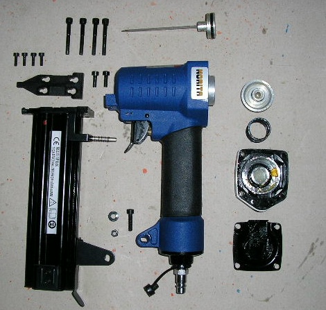

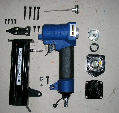

I had taken it apart and posted picson spudtech but the pictures have disappeared, but yeah, they're basicalyl all the same coaxial piston design. I attached a photo to the end of this post.I'm assuming yours also uses a coaxial airchamber to push the piston and blade back (then venting through the piston valve piston)... mmm too many pistons
If that is the case could you not put your blowforward mechanism inside the body with just the breach sticking out ?
