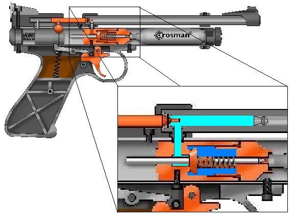

Tbh, I've never actually understood how the air from the hammer valve is getting to the barrel in these.
Anyone feel like spelling it out, I'm clearly missing something.

The hammer valve unseats and allows air out the side (top), and up behind the pellet. If you look at the below image, the outlet would be at the top. Just a note: this isn't a stock Crosman valve.

To further clarify, the bottom bit is a (delrin) valve stem. The metal extends out the back, and a spring sits on the "ridge", sealing the valve. When rapped forward, air passes past the reduced diameter portion and out the top port.

Cheers mark/jack, was mostly bothered by the way barrels seemed to be sitting on top of the reservoir without apparent means of connection.
Anything in particular keeping the port between reservoir and barrel sealed?

Pressure forcing the seal on the valve against the seal face?Hotwired wrote:Cheers mark/jack, was mostly bothered by the way barrels seemed to be sitting on top of the reservoir without apparent means of connection.

Hotwired wrote:Anything in particular keeping the port between reservoir and barrel sealed?

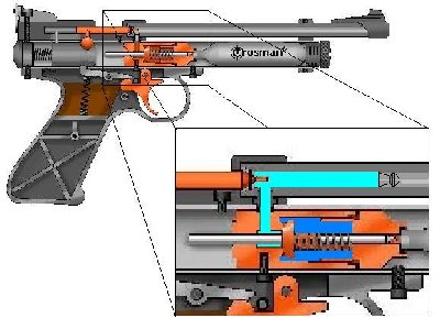

btw here's an enhanced view of the internals originally posted by Gippeto:
No, I'm meaning the short upright section joining the barrel to the valve assembly, how it attaches to both parts and to what extent it is sealed.inonickname wrote:Pressure forcing the seal on the valve against the seal face?Hotwired wrote:Cheers mark/jack, was mostly bothered by the way barrels seemed to be sitting on top of the reservoir without apparent means of connection.
I mean it looks like its a nipple screwed into the barrel section and being merely held down on the valve port (possibly on an o-ring) by force from the screw at one end and the barrel/reservoir clamp at the other.

It's neither. It's shaped exactly like the part you see in the drawing Jack posted and is made of some type of plastic (had to get a replacement after loosing mine ). Its reduced diameter ends sit through the transfer port and breech port and are held in place by the connection between the breech and gas tube themselves.

Close enough to accurate. The "o-ring" in the stock setup is square in cross section...more like a quad ring. The seal on the barrel end is metal to metal..no threads. Some folks give a wrap or two of teflon tape to the small metal piece (transfer port) to facilitate an improved seal.Hotwired wrote: No, I'm meaning the short upright section joining the barrel to the valve assembly, how it attaches to both parts and to what extent it is sealed.
Common practice is to replace these two pieces with a single piece of 1/4" od plastic tubing such as ice maker tubing or 1/4" plastic air line.
Occasionally referred to as the "poly tube mod".
