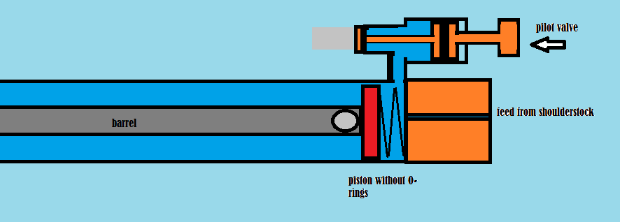

Thanks a lot Brian! I've been looking at your rifles for a few weeks now, hoping to make something simillar at some point. What I don't understand is how do you refill a coaxial valve for multiple shots? Is there another valve somewhere that I can't see that when opened, refils the coax? Thanks!
The valve does not dump all of the pressure.
The hammervalve is knocked open only for a split second, dumping the pilot volume and then after is shuts the main piston resets automatically.
An extra supply of air in the shoulderstock makes the total volume big enough to get multiple shots.

I think I get it, will try to make a drawing to clear it in my head :) Do you have an concept drawing perhaps?

Very basic principle.
in a coax pistonvalve the piston seals against the barrel naturally because of the difference in pressure.Inside the barrel is normal atmospheric pressure, all around the exposed sides of the piston is high pressure.
If pressure behind the piston is dropped, the pressure around the barrel will push the piston back,opening the path to the barrel.
With a snug -but not airtight- piston fit...the piston will reset under pressure when the pilot valve closes because the pilot area is refilled almost instantly, while air is rushing out the barrel, creating a low pressure zone in front of the piston while pressure rises behind it,
Effectively sucking the piston back onto the barrel.Asif you are using a vacuumcleaner to suck a snookerball out of the pocket.
The pilotvalve needs to open fast and then almost instantly close again to keep as much of the pressure in the launcher, yet release enough out the barrel to lauch the projectile at full force.
With a hammervalve as the pilot..( I use a partially counterbalanced one for higher pressures)and a very small pilot volume this will give you multishot capacity with much more power than a hammervalve could provide on its own.
This works even without the extra airsupply coming in from the back.Important to know it is not required for the multishot effect.
I just needed more volume for more shots and I could hide an extra reservoir in the shoulderstock.
I guess you could do wonders with this concept!
Lilshat basic function.png (9.51 KiB) Viewed 5057 times

Thanks a lot Brian, both for the drawing and the kind words!
It's actually simpler than I thought, great! :) I'm already thinking about the tubes that I already have at the shop,and the ways to hit the pilot... Some drawings are to follow!
