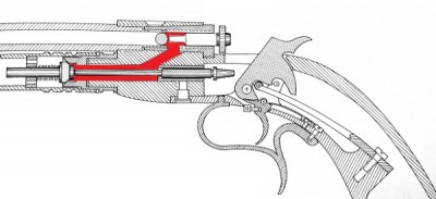

Having a bit of a rethink for this after blowing more seals than a lonely Arctic explorer, let's say we stick to the original "cup" design with a quad ring that seems to work.
It might be possible to reconfigure the cup in such a way that the outlet is much wider, while adding a balancing element to the cup itself as follows:
edit: Drawing it to scale, it's a little tight...

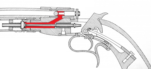

Perhaps this variation would work better:

I see that the ideas rain to solve the same problem, I know about this since it has also happened to me, with my designs. Sometimes, the "dizziness" is a bit vertiginous; heights, in any field of knowledge, produce vertigo to some extent.
This is to try and test ideas, it is the soul of all this, because once the problematic weapon shoots more or less as you want, the weapon is saved, to be fired from time to time, this allows us to remember that the problem was "defeated", this in each shot.
It seems a good solution, this variation that you drew, I say from my almost total inexperience in this type of designs, but it seems to me that the blessed - curse o'ring, is not going to bother. I follow your progress in this post that is a duet. regards :)
