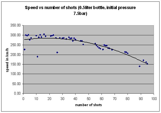

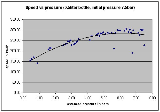

This test shows how many shots can be taken on a 0.5liter coke bottle at 7.5 using my thumbreloading bbgun. It was amazing; I took 95 shots! The velocity ranged from 300km/h to 150km/h. Check the pics below>

Yeah k I did calculate the graph in meters per second as well. I converted it to km/h so you can compare it to a speeding car for example. Oh yeah btw these speeds are not the muzzle velocities rather the average over a distance of 2.4 meters:)>> I used my mic-chrono method. I dont wanna go on about this metric unit system. I think I brought across that the NASA is ganna use it for the coming space missions, I think that says enough:) I am not sure in which unit muzzle velocity is expressed, but I know its more usefull as it is easier to find the muzzle energy then, good point:) For all the ppl out there(1m/s=3.6km/h)
