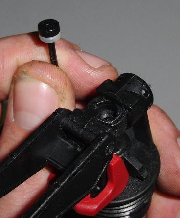

This didn't work out in practice, due to the way the inflator is constructed. The valve seems to be built in such a way that it's only sealed from allowing air to escape to the outside when it's fully depressed, meaning that gentle pressure on the trigger only caused air to leak from the valve without building enough pressure in the chamber. Pulling the trigger hard inevitably resulted in a full auto burst, cool but not what I wanted.

The point is that the inflator valve leaks to the atmosphere when pressed, so it's not a matter of flow, it's a matter of the air not going where it's supposed to! For once the problem is with a purchased item, not my construction :P

Back to the subject of this thread, here's a(n excuse to use macro :D) view of the CO<sub>2</sub> inflator valve, the pin I'm holding in my worn out, epoxy encrusted fingers pushes down on what appears to be a simple spring ball valve and fits in the housing under the trigger lever. The white seal closes against the base of the housing buy the trigger has to be fully depressed for this to happen, which provides too much flow for single shots.
