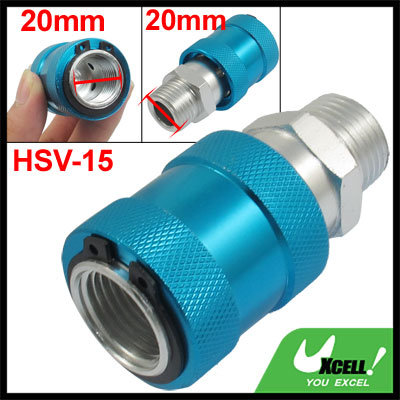

First off, a slide valve is a three way valve, and is perfect as a pilot for a QEV, one of the reasons is that you need to push the slide to the rear to fire, so if your QEV is mounted horizontally as most are, you get a natural trigger movement.
As POLAND says, these will do:
The can take 4500 psi safely, and quite cheap off eBay:
http://www.ebay.com/itm/Ninja-Air-Paint ... 2c64ef6d4d
http://www.ebay.com/itm/Paintball-Repla ... 27c02404fe

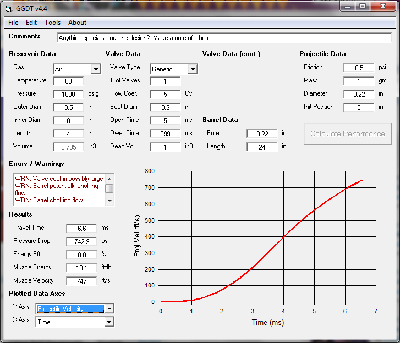

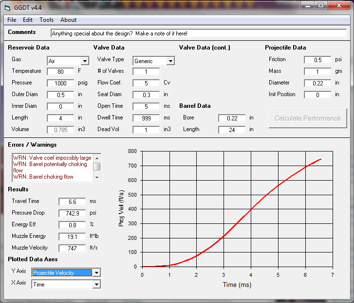

If my qev can handle over 3000 psi what is a realistic firing pressure? I think I've seen commerical hpa rifles that are regulated down to 1500 psi.
A QEV-slide valve setup will typically dump more air at a higher flow rate than the hammer valve on commercial rifles, so you don't need as much pressure.
Here's a GGDT simulation using less than 1 cubic inch chamber size and 1000 psi, you get quite high velocity for a medium weight 0.22" pellet and almost 20 ft/lbs of muzzle energy. To put that into context, any air rifle over 12 ft/lbs in the UK has to be registered as a firearm.
For that simulation I assumed a "rifle sized" two foot barrel and a poor reloading system with one cubic inch of dead space. Naturally by lengthening the barrel, making the chamber larger, reducing dead space etc. you can get more performance without increasing pressure.
The question is what are you looking to destroy and at what range ;)

Jack, Poland, have you ever used a paintball slide valve to trigger a QEV above 1000 psi?
Because these slide valves maybe rated to 3000 psi (the materials), but that doesn´t mean it can operate at that pressure. My paintball slide valve(same as the second picture/link) started to leak after I use it twice at 1000 psi, the o-ring got wasted on the exhaust port. There is no way any slide valve can survive constant open/close at 3000 psi.

Cool, thanks Jack, Poland, and wyz. You guys have been really helpful. This has answered my question and more. I wanted to go longer than 24" rifled barrel if I can find one but will settle with what is available.
I guess I will have to experiment with the slide valves and cross my fingers that it'll hold up.
Anyone have experience with a specific brand that can hold up to repeated 1000 psi or more use?

Im buying this one:
http://www.ebay.com/itm/390478816145?ss ... 1439.l2649
The seller told me that it can handle 10MPa (1450 psi); what you guys think?
The thread is G1/2 (cilindrical bsp i think.)
About the o-ring, if you keep it very lubricated, i think it would last long.
Does these remote slide valves have enough flow to pikot a 3/4 qev(19mm diam piston/ 16mm diam seat)?
1450psi rated? what do you think?

jackssmirkingrevenge wrote:
I've used this particular slide valve at 2000psi with those "3/4inch" ebay square style QEVs, so they should be safe to use at about 1000 psi with a decent safety margin.
I personally haven't experience the problem wyz describes with this slide valve, and although it becomes harder to actuate at extreme pressures, it has never leaked on me (I actually have two ATM on different projects) and is always consistent. With a "trigger" addition that gave me some leverage, I was able to comfortably actuate this valve semi automatically. at 700psi

wyz2285 wrote:Jack, Poland, have you ever used a paintball slide valve to trigger a QEV above 1000 psi?
I used mine (that looks like the type in the first picture, and the one LnL described) many times at 850 psi and never have leaks.
Have you ever taken yours apart to look at the exhaust port? It could be poorly finished, hence the tearing of o-rings. I would recommend dismantling it and putting a slight bevel on the hole to reduce wear and tear, and indeed if you have the facilities, drill a few more small holes to improve exhaust flow.
I think even a generic one would be good if you take a look at the exhaust port before using it and see if it needs some attention.
If you want a good brand, and at the same time support the US economy, I would recommend Ninja: http://www.ebay.com/itm/Ninja-Slide-Che ... 35ba4924d8
I have two of their bottles and the build quality is nice, I would assume they pay the same attention to all their products.
It's not about lubrication, more about interaction with the exhaust ports. if they are poorly finished or have no bevel on them, they will act like a blade and rapidly tear the o-ring
Does these remote slide valves have enough flow to pilot a 3/4 qev(19mm diam piston/ 16mm diam seat)?
Definitely. As QEVs have parachute/umbrella type pistons, you can pilot them with a schrader if you want.
