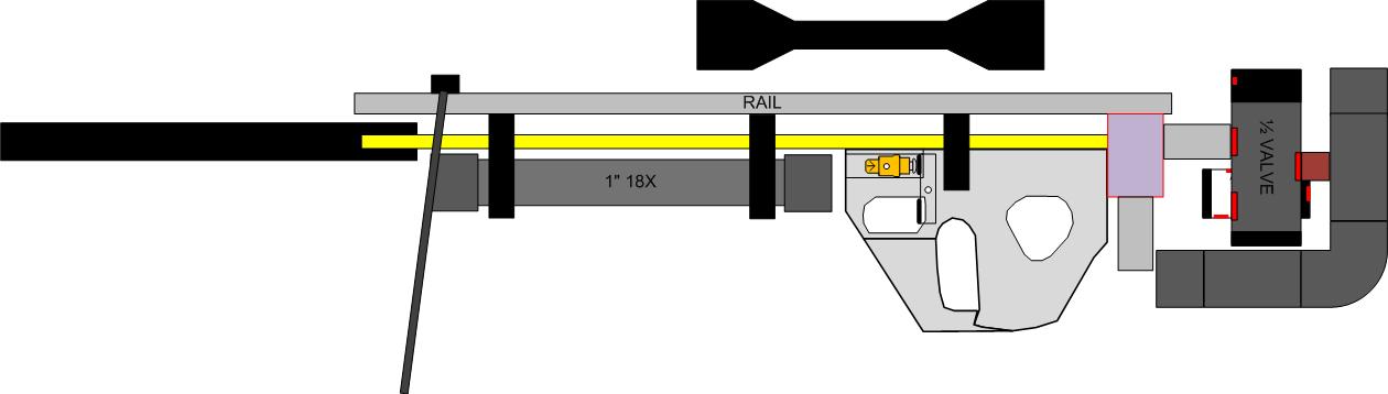

10mm thick alluminum and tight corners not so jigsaw friendly, took me an hour to get that far :| Did a bit more today, made trigger and started to mount trigger valve.
Sort of got most of it worked out in my head, but anything can change, and usually does :idea: :idea:
FAR2017 main - Copy.jpg (31.61 KiB) Viewed 7002 times
Should look somewhat like this, still not 100% sure where the pilot valve is going, it's hiding behind the main 1/2" valve in the picture, the barrel will have a removable 300 mm extension.

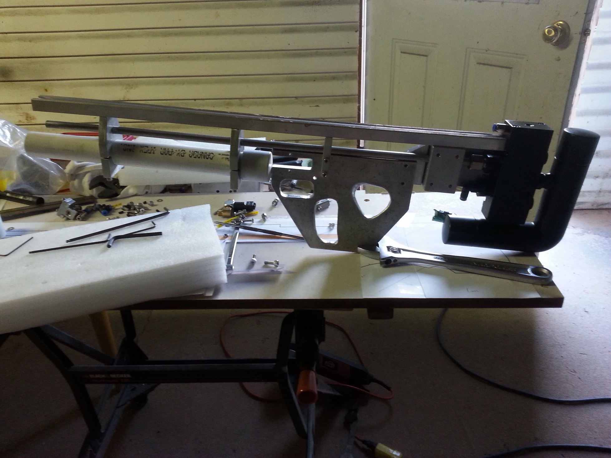

Drilling holes and filing is my therapy
+ gets you out of the house...sorta.
Workshop is 50 feet away from the house, so it does :D no heating though so I don't do any work in the winter much :cry:
Control valve pretending to fit on RH side

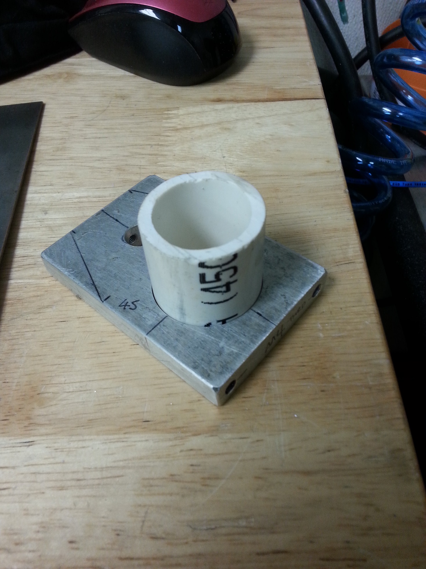

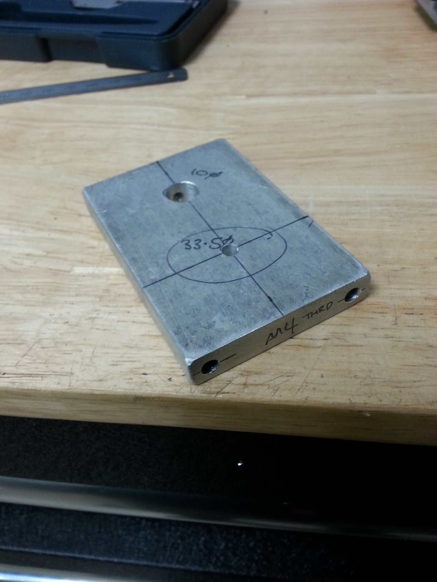

How I make a split clamp for 1" PVC, about 33.5mm. Barrel goes through the 10mm hole and rail attaches to the top.
Drilled 2x 4.5mm (anything smaller tends to wander) down just beyond eventual cut line (split in clamp)
Drilled down 3.3mm into 10mm barrel hole, then drilled down 4.2mm halfway so I tap M4 in the bottom of the hole then M5 in the top half
Drilled 33mm hole with hole saw then polished out until PVC fit
Cut in half, then used previous 4.5mm holes as starting point for 3.3mm holes, tapped M4. Cut off the top corners and polished a bit (this is old scrap material)
Finished
Re: FAR2017/WA2000
Posted: Wed Sep 13, 2017 5:07 pm
by farcticox1
Something like this
