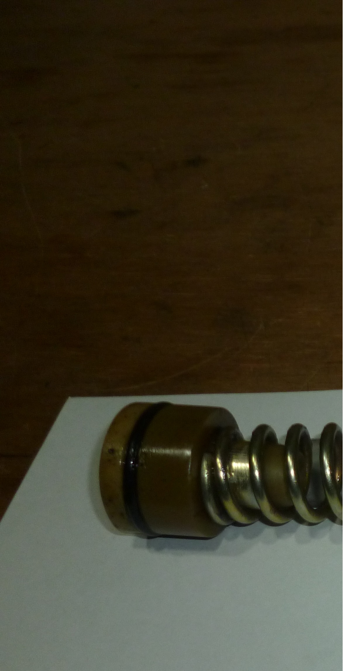

I made them from epoxy resin or polyester resin. They come out perfect when using a mold. If you leave a hole well centered, and then, when the curing is finished, temporarily stick a metal shaft, and make the slot for the oring in the side hole-making machine. I use it in a 5X hybrid, and it has not been destroyed until the present. You can try it, if you think it's convenient for your project.

So apparently a friend of mine says a two-part epoxy injected into a mould (say, an off-cut of PVC pipe) works well. The epoxy dries hard and solid, and is kept from sticking using linseed oil? Very interesting! Huge info. The piston I'm building must be able to do a similar job to a high-end foot-pump and I think you hit the nail on the head regarding this mould idea.hectmarr wrote:I made them from epoxy resin or polyester resin. They come out perfect when using a mold. If you leave a hole well centered, and then, when the curing is finished, temporarily stick a metal shaft, and make the slot for the oring in the side hole-making machine. I use it in a 5X hybrid, and it has not been destroyed until the present. You can try it, if you think it's convenient for your project.

I went ahead today and bought two part epoxy putty, unfortunately the wrong type (steel). You would think a warm mouldable substance would curate like crumbly play-doh, wow, how wrong was I?
This stuff cured, WARM, in about 15 minutes and after an hour, was virtually indestructable. Impressive. I think the reason I stayed away from epoxy was because of the nature of it as a repair and patch-up solution- Never in my wildest dreams did I think you could mould your own piston (there are approx. 2-3 vids on youtube showing people cure their own plastic epoxy pistons!)

Alas, you can buy PVC-suitable Epoxy Putty. This is purely amazing to me. And to believe I was trying to find stock PVC that would magically fit...

Liquid epoxy resins, for laminating, also work very well. They are two-component and it is very easy to make it take the shape you need. regards
